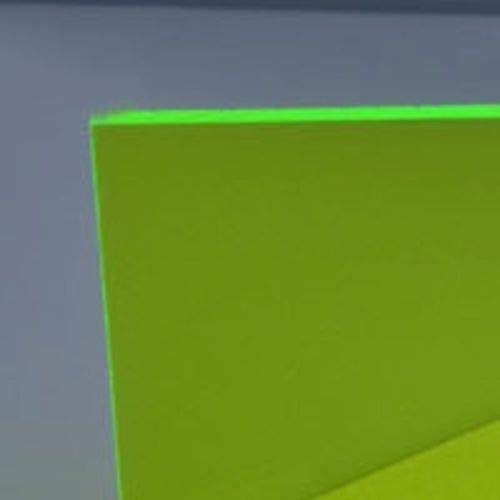

I tried searching but came up empty. Has anyone tried turning sheet acrylic plexiglass? I seem to recall this stuff being pretty brittle but would love to try using a bit of it as a simple segment.

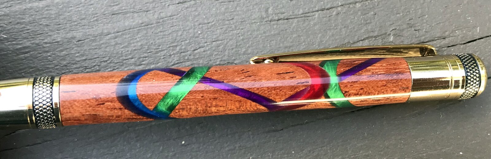

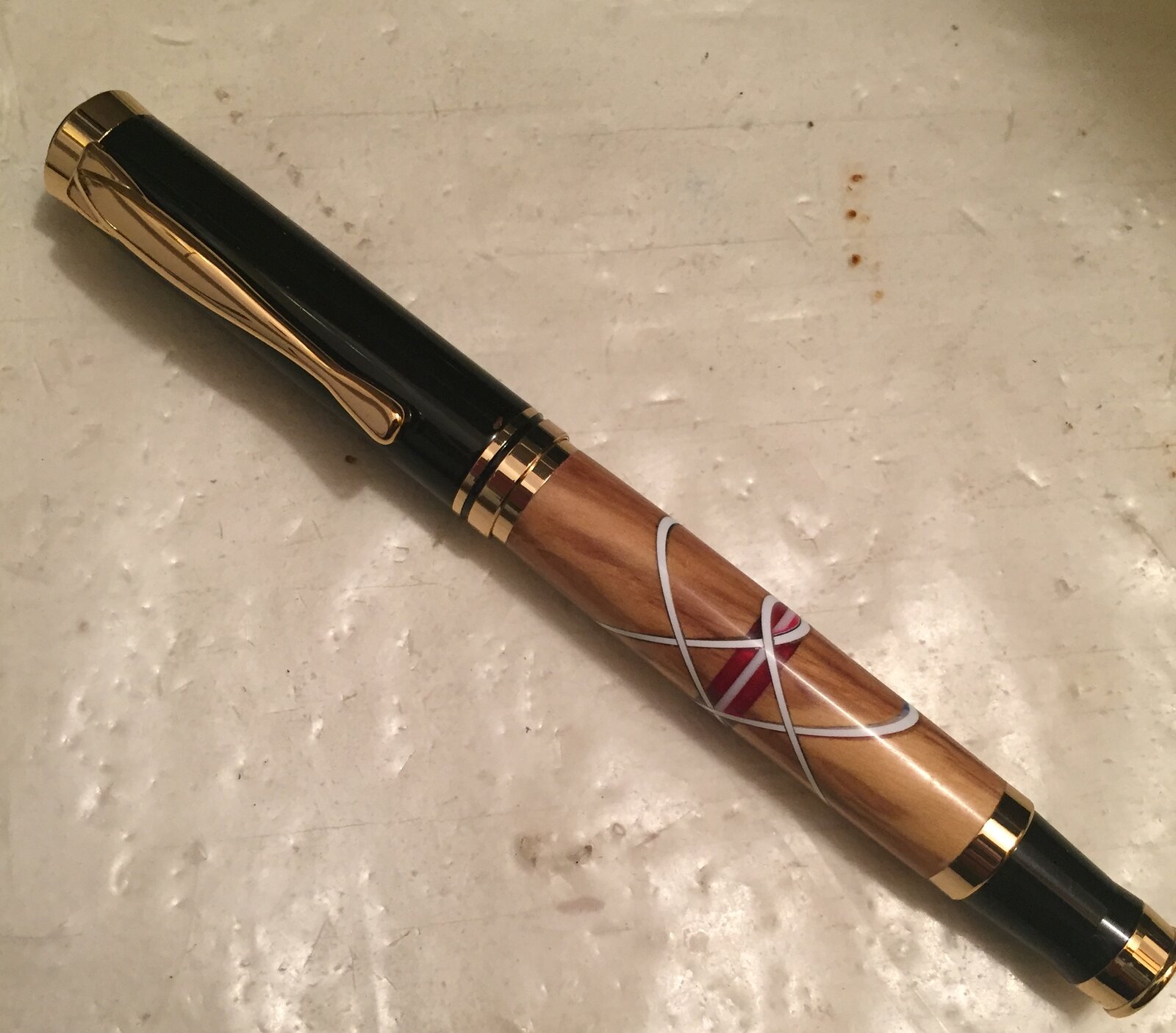

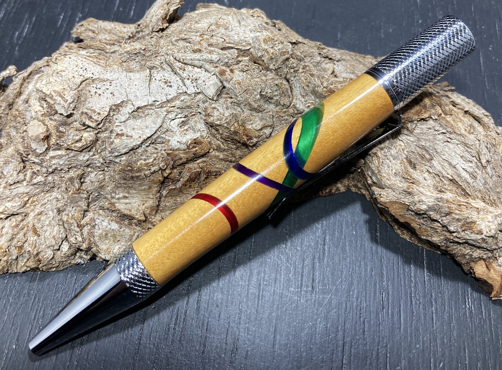

If you bore/drill this use compressed air keeps the chips blown out .
You also will have to polish the drill hole .
I have machined DVD disc or CD discs for inlays too .
But I am using a live cutter on the tool post of a metal lathe .
