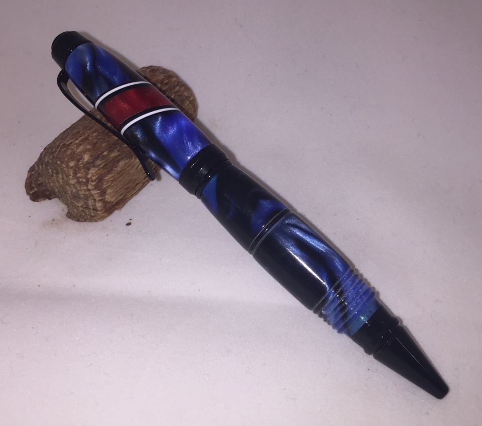

Acrylic laminated with guitar pickboard
See more from Rob Platt
Rob Platt
Dec 8, 2015
10
Kansas City
Let me know what you think. Criticism welcome.
First time posting - wish me luck...
First off Rob, welcome to the site. The pen looks nice. That's some fine beading near the bottom, what did you use to get such detail?
Len
Thanks - I used a skew to make the beads, but didn't roll them. Just used it flat on the tool rest like a scraper, and the sanding process took off the sharp corners - what I was going for.
Glue joint at the lamination failed 3 times (before drilling). Sanded and used CA, but may try epoxy next time.
I really like the top, the bottom not so much. My mind thinks there needs to be something screwed on the end :)
Top cut and colors work great together
