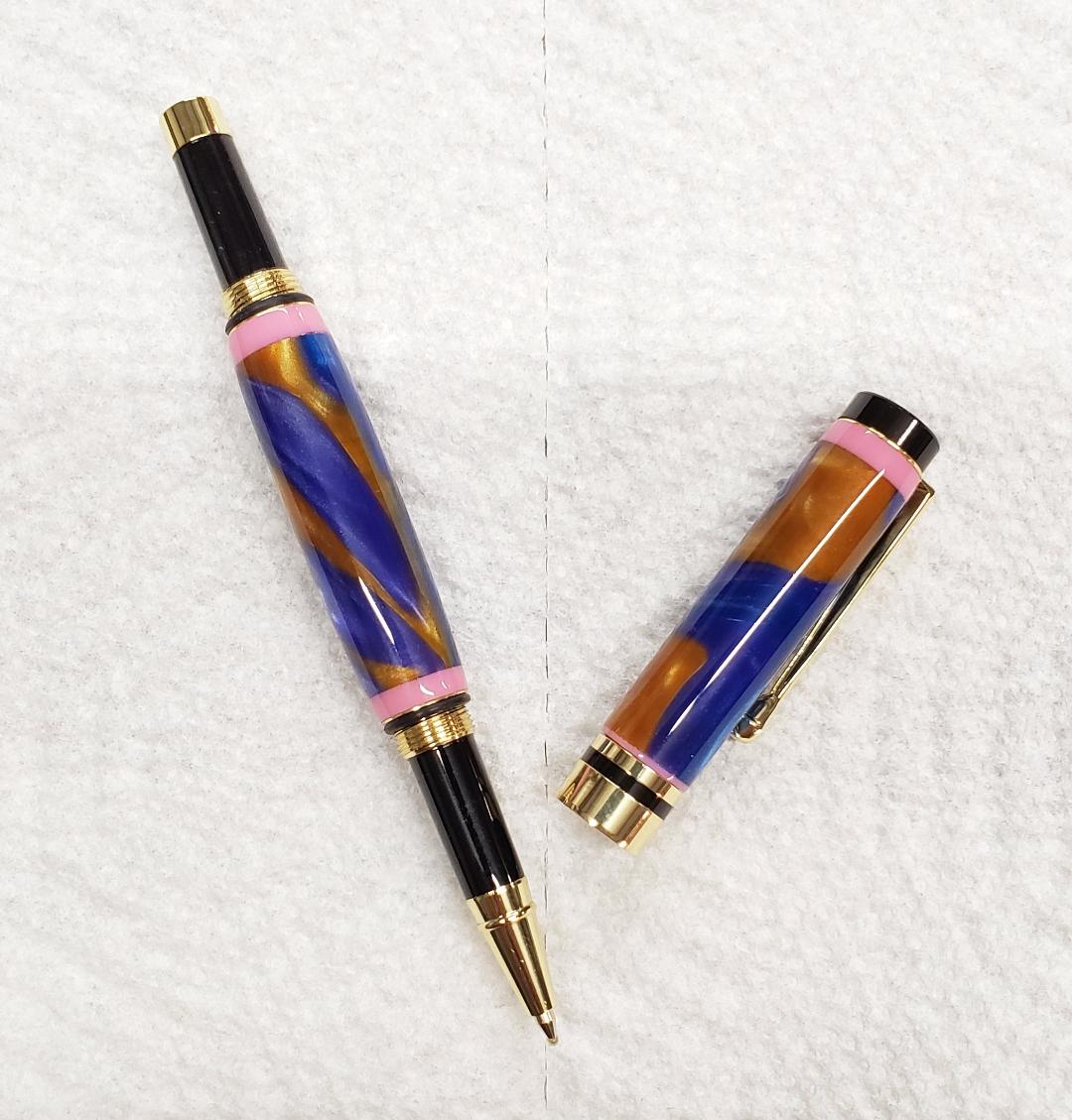

I sand from 220 to 800, then turn to wet sanding with micro mesh all the way to 12,000. It looked good after that but I always take some McGuire's plastic polish as a last step. Just did this method to my pen I finished yesterday.
