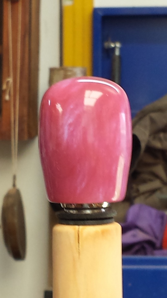

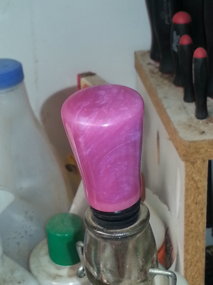

I've had no problem with Acrylester. For all Acrylic pen blanks, I hand drill one end for a few millimeters (1/8") and then drill from the other end at about 300-400 rpm, clearing the hole every 10mm (3/8"). Yes it is slow, but I try to minimise any heat build up in any Acrylics, as I find the swarf can ream the opening to grossly oversized, if it melts to the drill bit upon extraction.
Turning wise, I run at 3900rpm for pens and bottle stoppers, sharp tools and light hands. Rough using a 32mm (1 1/4) spindle gouge and finish with 10mm (3/8) spindle gouge or either a 32mm or 12mm skew. Sanding is done with Abranet from 120 - 800 at 300rpm, then wet micro mesh to 12000 at 3900rpm.
You are trying to sculpt a flower petal, not build a bridge. :laugh:
