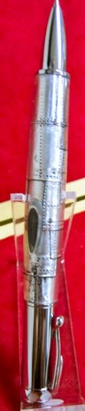

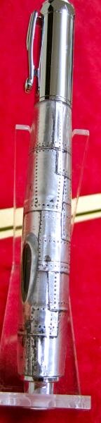

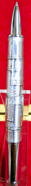

Well she did it again.
Left me home with no adult supervision and a garage full of stuff.
After I finished this thing all I could think was,
COYOTE WANTED;must have own saddle and be willing to travel!

Ok Mark,
That is totally awesome! It reminds me of a P-51 Mustang. It has a steam punk feel to it. Would you be willing to share how you created the rivets and metel edges effect? Is it actually metal or some other material? Thanks for sharing your pictures.
That one is really nice. I'm like the others on here, I would like to know how you pulled this one off.
Mark... I'm actually not happy right now. I just sat here with my mouth agape and dripped tobacco spit all over my laptop! The first thing I thought of Dulos mentioned. Steam Punk! Its written all over that pen! Awesome! Amazing! Stupendous! It's so damn UGLY and so stunning all at the same time! I don't know whether to hate it, or love it. But I LOVE it!
Yep, we're all gobsmacked and we GOTTA know how you did it! Is it clay or is it sheeting? I know you can make rivets from tiny screws (got them at a railroad hobby shop), but haven't tried it yet. What did you do here??
Fantastic!!
Acme ROCKET-ZEN,building it

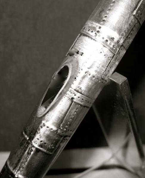

Wow,good morning kids,
Thank you for the nice comments on my project pen.
The material on the tube is aluminum tape,the rivet markings are made with a hobby shop pounce wheel that is designed to make rivet marks on model aircraft I made the side vents with teardrop tubing cut at a 45 and epoxied to the side.The patina is black paint that was rubbed on with a paper towel.
Cast in clear PR and turned.
Minus cure time,the project took about 1 1/2 hours
