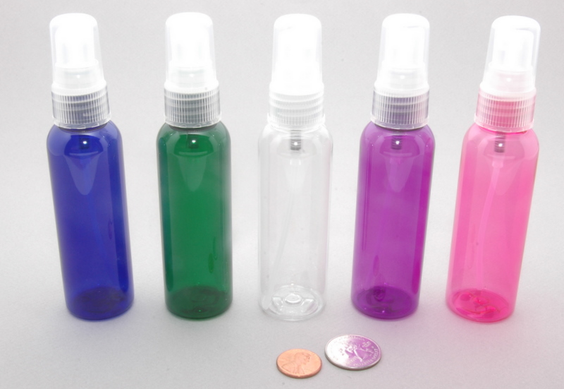

However, if you are going heptane and/or naphtha you can just as easily use this.
attachment.php
Your local stores carries this in the travel section, i.e. Target. They will net you less than $1.
attachment.php
Looks like Grainger is discontinuing the SureShot sprayers.
If you use the bottles pictured, they look like a standard pump sprayer that most of the 2oz bottles of accelerator come in. The advantage of the refillable sprayer over the pump is when pressurized, they can give a finer, shorter burst of accelerator mist depending on the interchangeable spray nozzle used.
attachment.php
