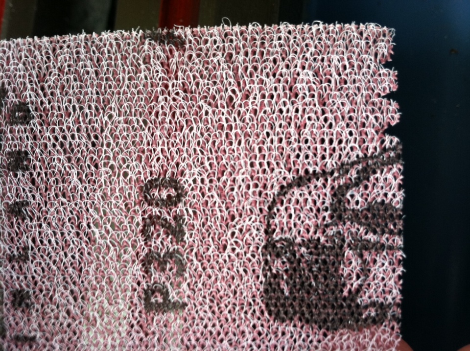

This has probably been posted before since it is so simple, but I've never seen it, so here you go.....
If you are like me, soon after opening a new set of abranet, you can no longer read which grit is which. I try to keep up with a permanent marker, but eventually, I can't tell the 400 from the 600, etc. I just came up with a solution - I notched each grit with a number of notches that correspond with the grit. 320 gets 3 notches, 400 gets 4 notches, etc. I don't often use coarser than 280 (or 260 or whatever it is), so am not worried about those.
Notches in the upper right:

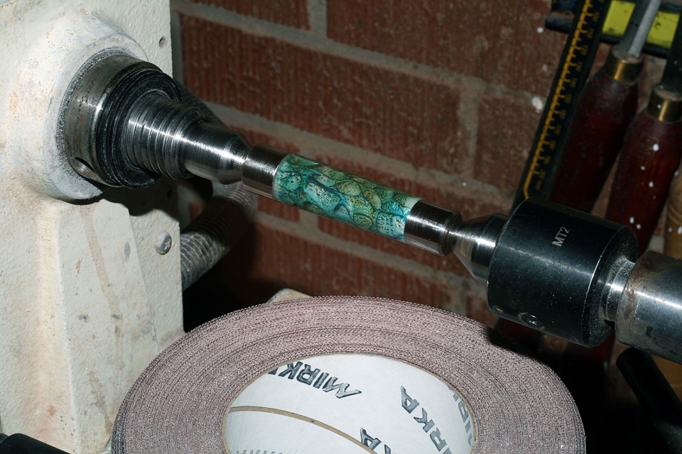

Mirka Abranet
Yup sure does. Cheapest way to buy the stuff. Also way more variety than you may be aware of.

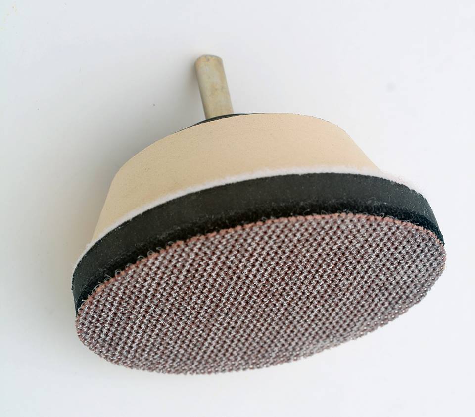

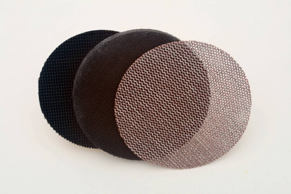

Abranet is screen that has abrasives on it. It has numerous advantages over classic 'paper' based in several ways. Some of those are less heat build due to dust falling away and not building up like with paper, less sanding needed due to clogs and faster chip removal; also seems to work better on delicate surfaces. It also last longer than conventional paper does.
attachment.php
attachment.php
This is an 80 grit 3" round disc that I use on a backing pad (various firmness) on a corded drill when I do bowls.

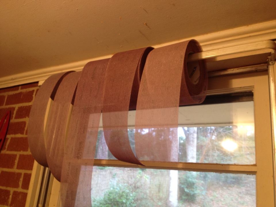

What I do is put the spools on the curtain rod and cut off what size and grit that I need. Here we have 120, 240, 400, 500 and 800 grits. My 80 grit is in 3" disc. After 800 grit I use Novus #3 and/or a buffer depending on what I am working with.

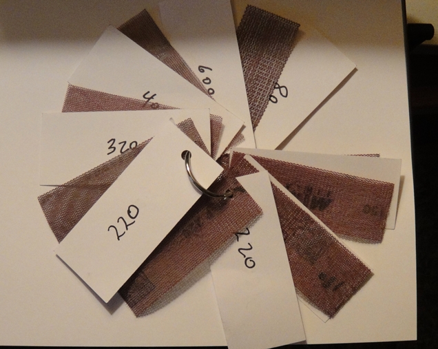

I keep mine in order on a key ring separated by card stock with the grit # on it. Makes quick work going through the grits.
