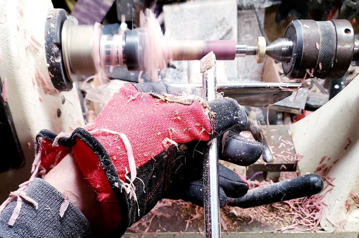

I would add not to be too aggressive with your turning tool(s). Depending on the type of wood cast in the hybrid blank it can be harder or softer than the resin, making it easy to gouge the softer material as you pass along the blank. Maybe gouge isn't the right word, but it can cause an uneven turn. Just make light passes and take your time.

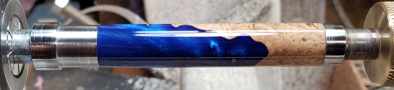

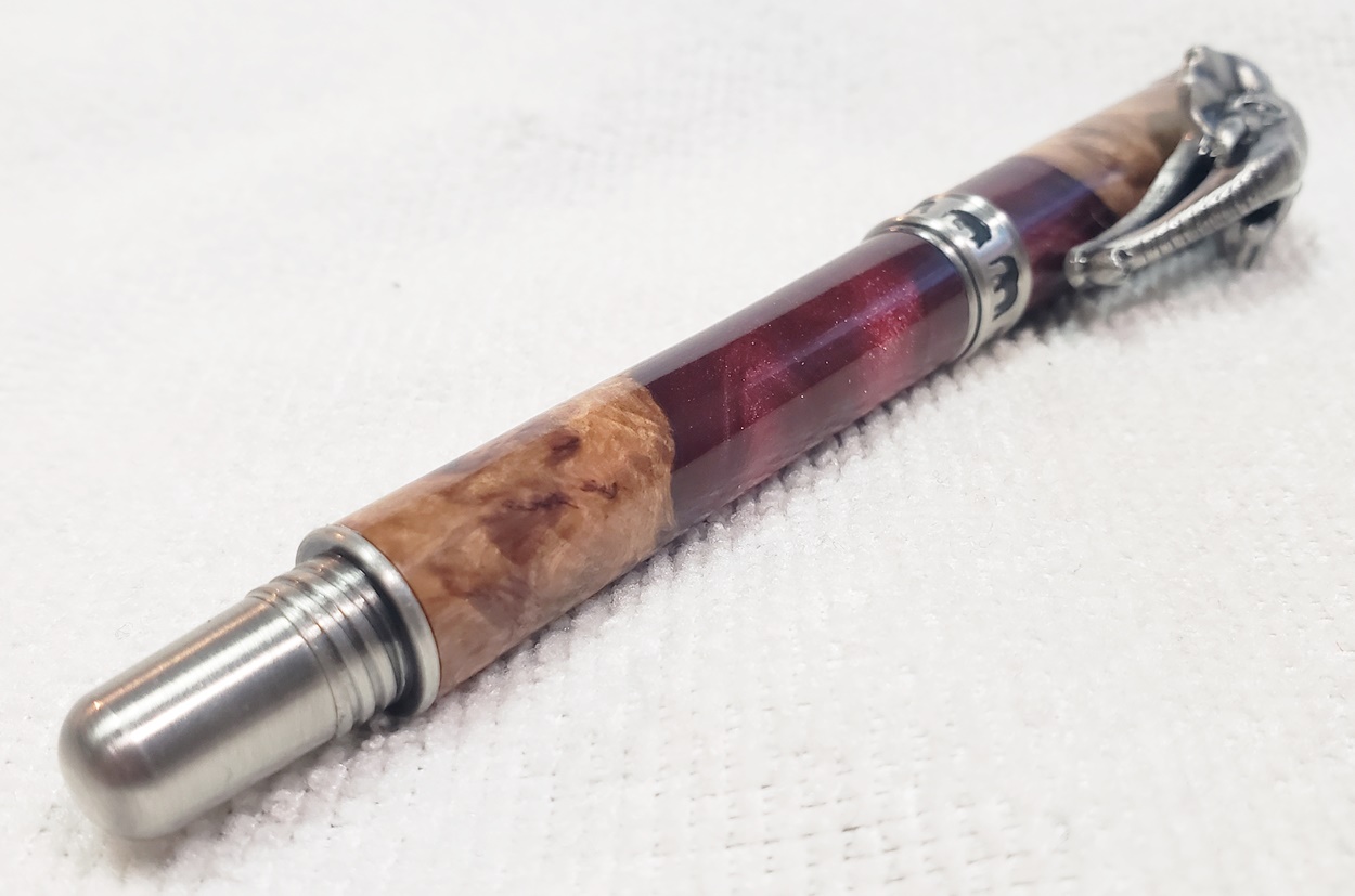

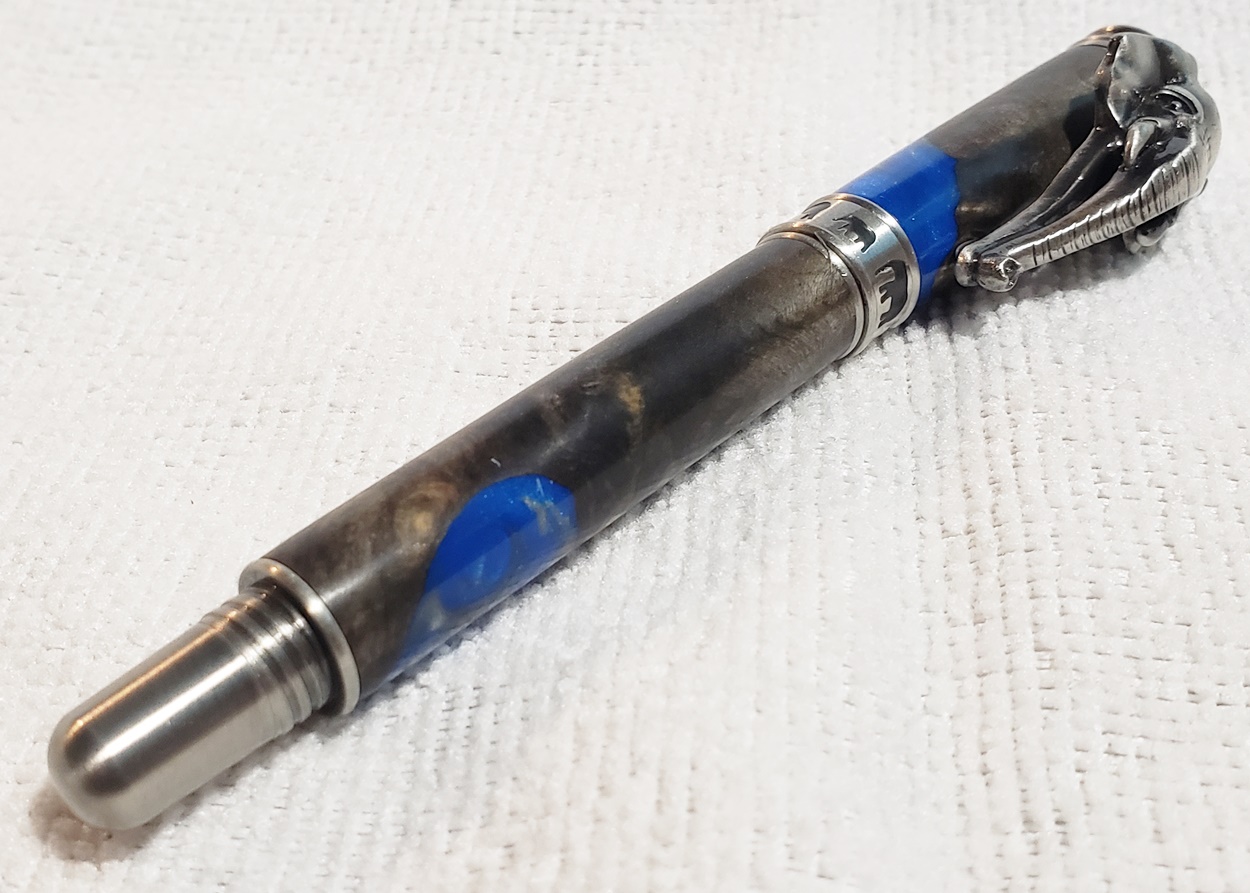

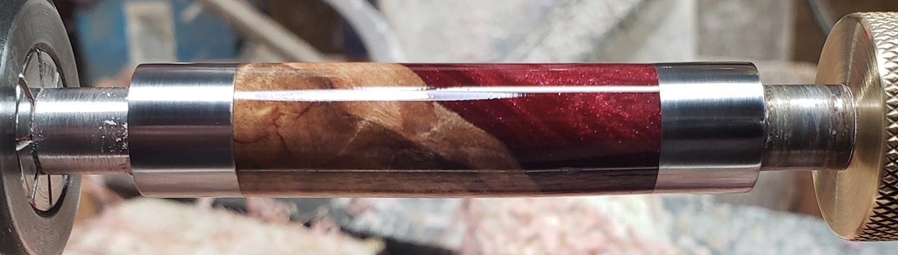

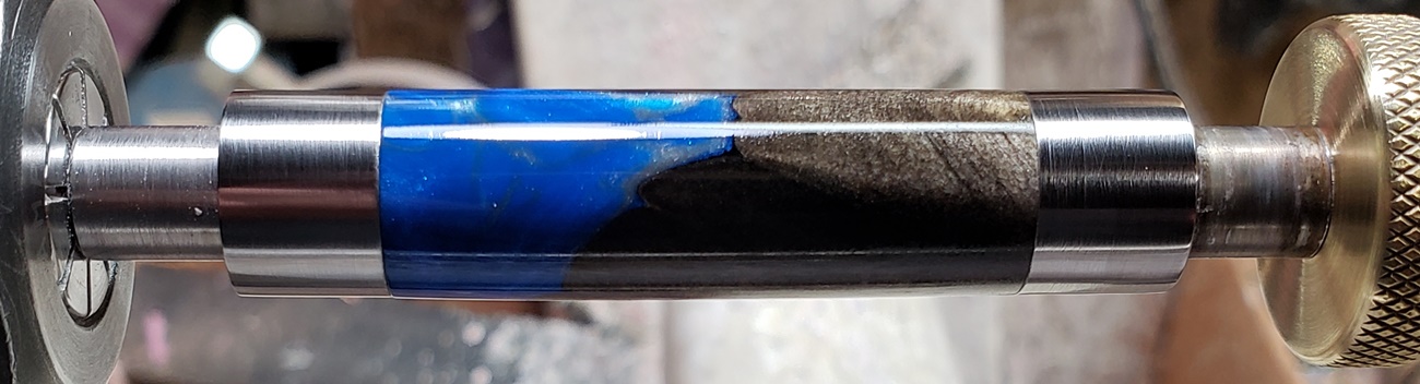

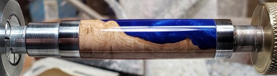

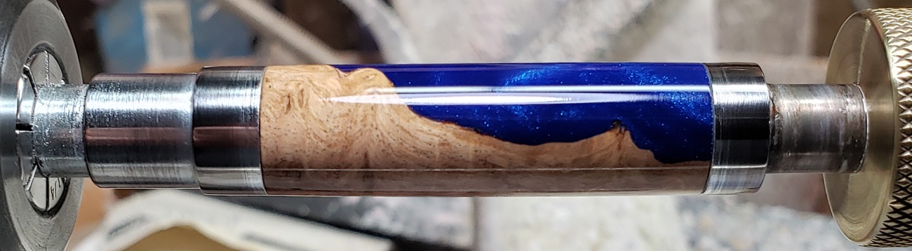

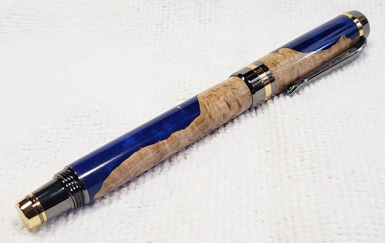

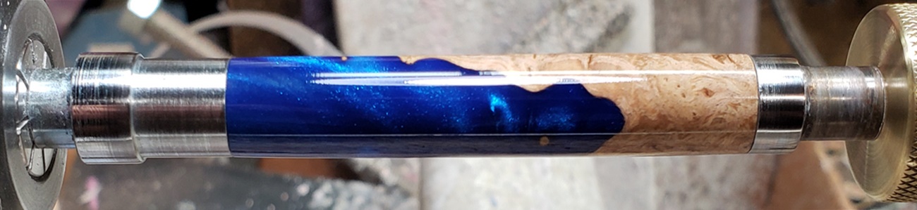

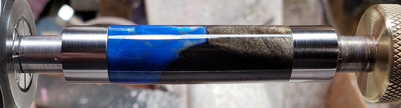

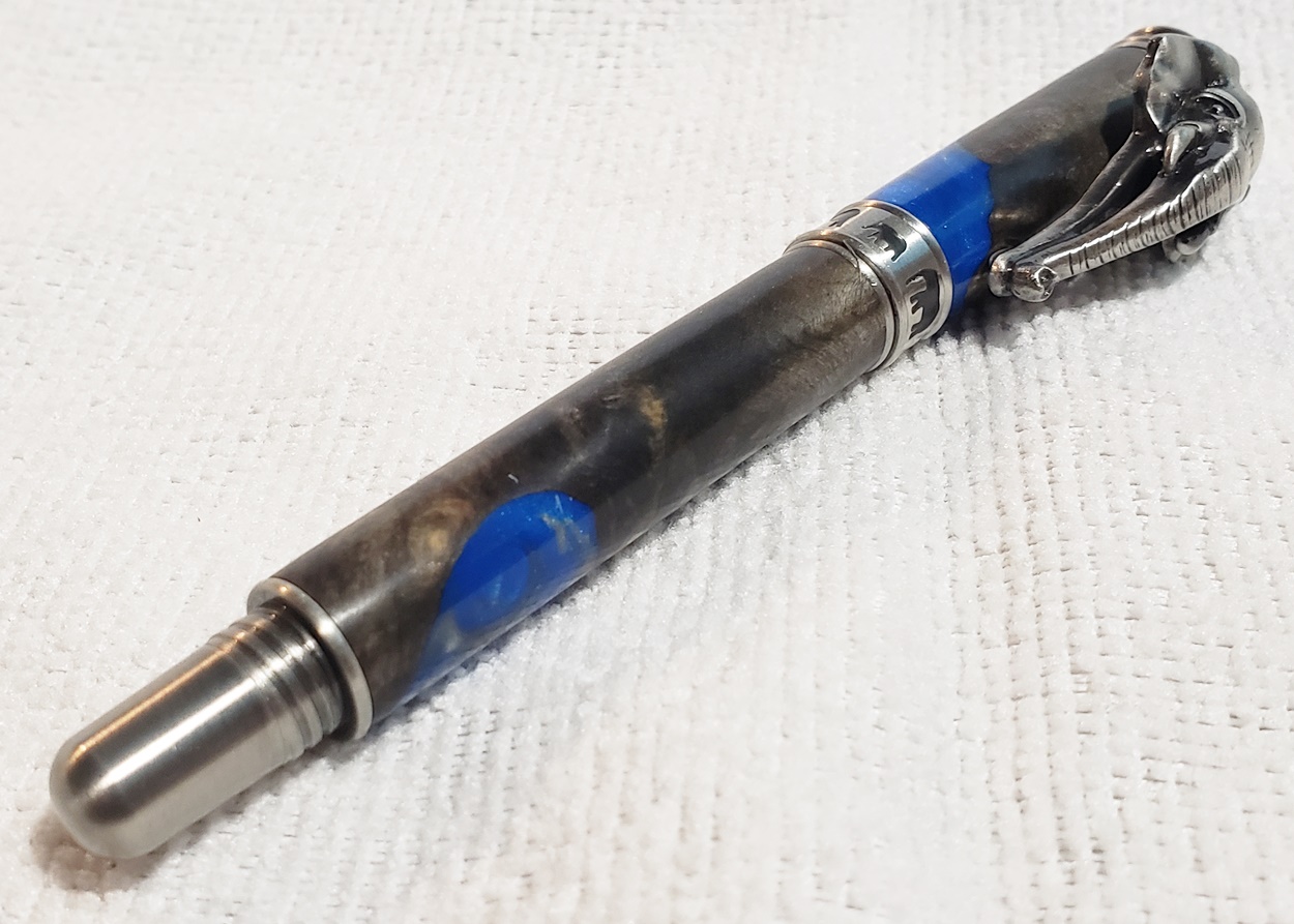

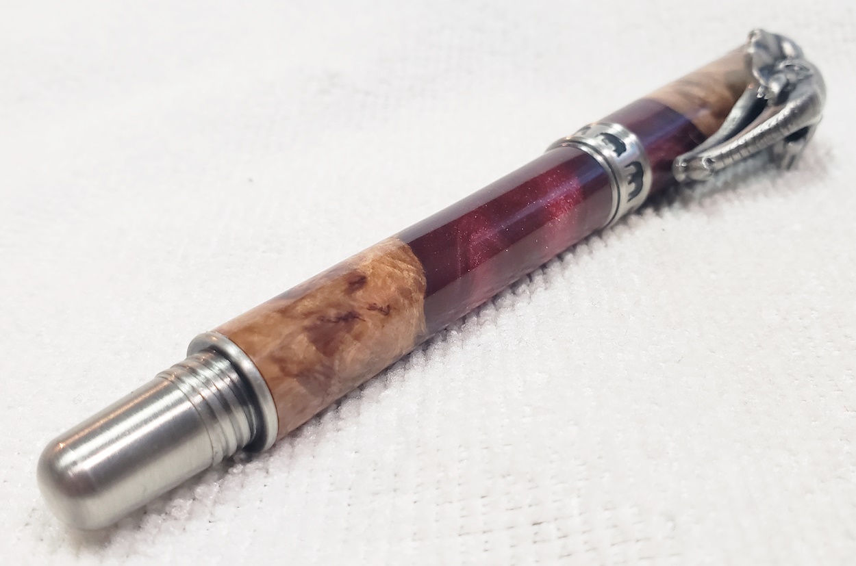

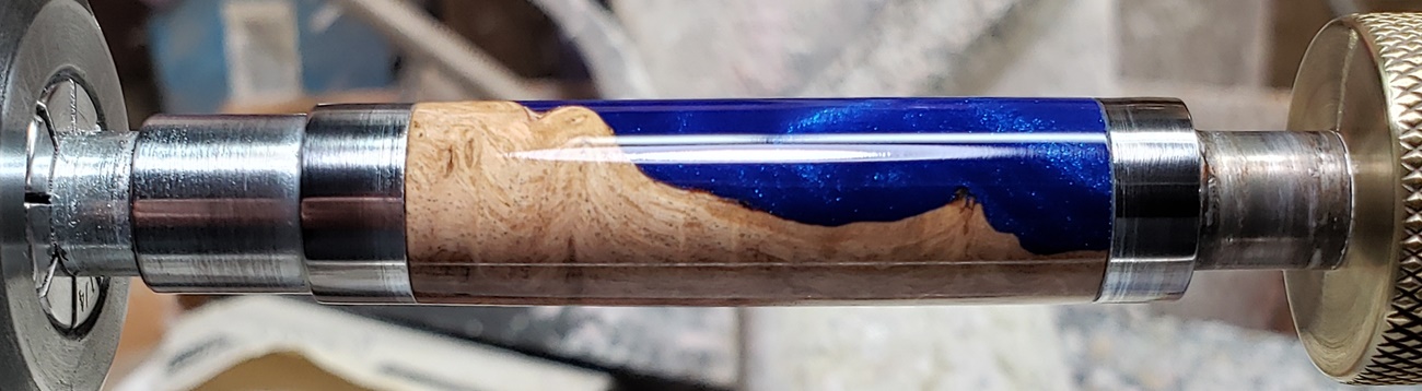

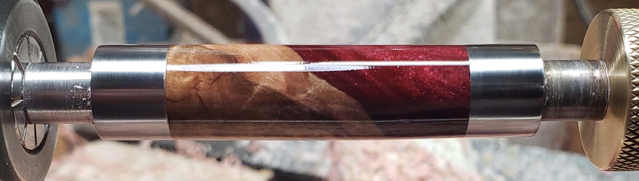

I recently turned three Hybridz blanks from Rockler. No problems. I used a carbide chisel held at an angle to get a "shearing" cut. To finish, I dry sanded to 600, used all 9 grades of Micro Mesh dry, then used Pens Plus. I understand most here would apply a CA finish, but I have yet to master it. Pens Plus works fine for me.
