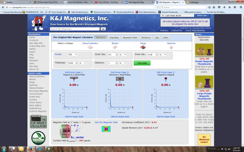

I was reading that post on IAP as I got your email. I lookedup the magnetic strength needed to disrupt a pacemaker and got an average of 10gauss. By putting the magnets dimensions into this calculator: http://www.kjmagnetics.com/calculator.asp?calcType=ring
I was able to find that as long as the magnet of the pen ismore than 1 inch away from the pacemaker itself then it will not affect thepacemaker. The magnetic field at 1 inch away from this size of magnet is 5gauss. So within usable rage. At that is at the highest quality magnet for thissize. So as long as you are an inch away from the pacemaker itself you shouldbe ok according to my findings. As to the credit card strips the same sourcessay that any size magnet sitting close to it for a long time will wipe thestrip however Even the largest magnet needs time to make it work. So short termexposure shouldn't be a problem but I might not carry the 2 items in the samepocket. Please let me know if there is anything else I can help you with.
Source: http://www.kjmagnetics.com/blog.asp?p=pacemaker-safety
I have attached the picture of the screen from where Ientered the information to get the info.
End Response...
End Response...
