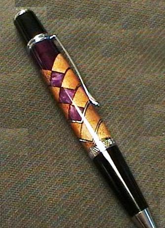

After seeing "wiset1" "started but never finished" thread the other day, it inspired me to try this. I learned a lot from this one blank. The blank is made up with black walnut, purple acrylic, black paper and aluminum beer bottle. All the parts were cut using a razor saw, (learning part) need better equipment. Drilling was pretty straight forward, I used the cullet chuck and started with a center bit then a 3/8 bit and finished with the 27/64. All joints have a layer of black paper between them including the diamond shapes and there is a layer on each side of the aluminum pieces, CA was used for the glue up.
Comments are welcome, And Thanks for Looking.:biggrin:

Looks pretty good, I really like the purple in the pen but why did you stop with the aluminum after the first two sections?
I have done a few herringbone pens and that was enough for me. I guess with the proper tools it would be easier to get more accurate but for me it was very frustrating and gluey fingers.
That's a cool idea. I also like the idea of black paper. Just to clarify, that's just 1 pen, right? The scallops look interesting too. I'd love to have seen the blank during the build up.
I was not sure how it was going to turn out or how hard it would be to drill through the aluminum so it was more of a test then design
Yes, it is just one pen, the link below shows what it looks like before turning.
