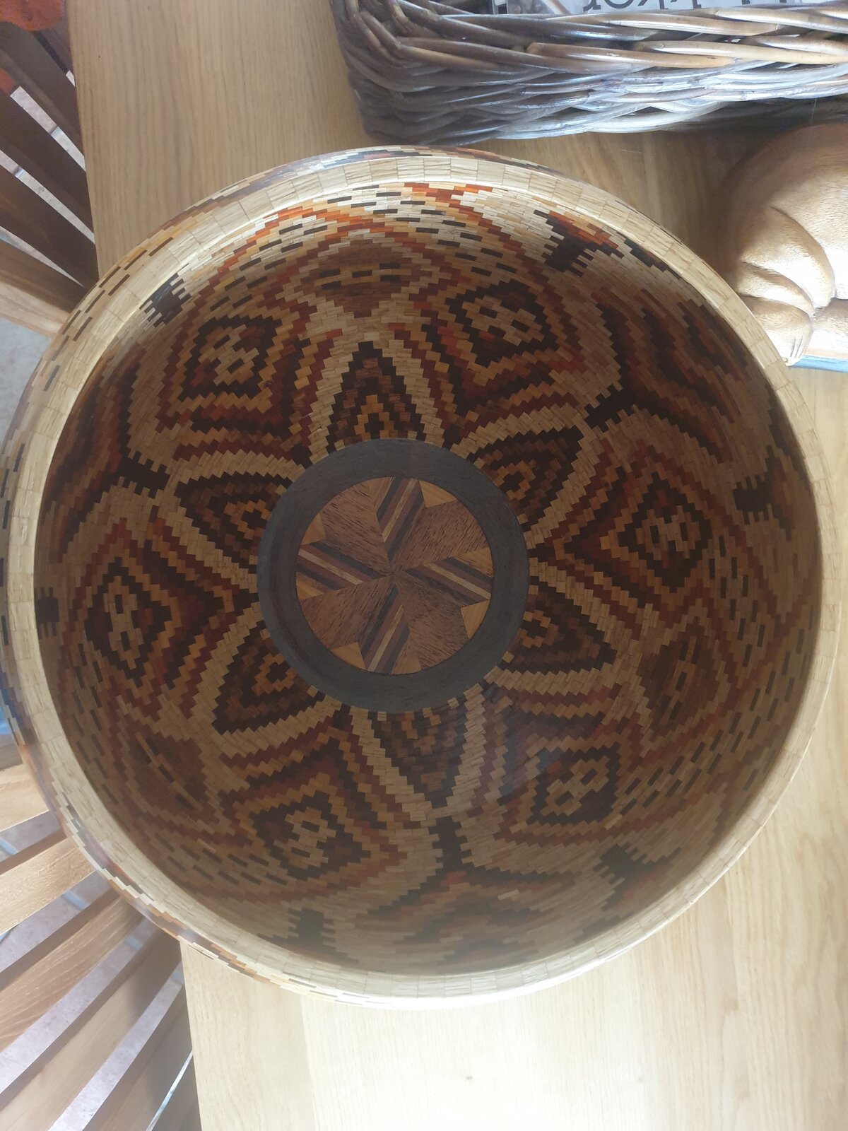

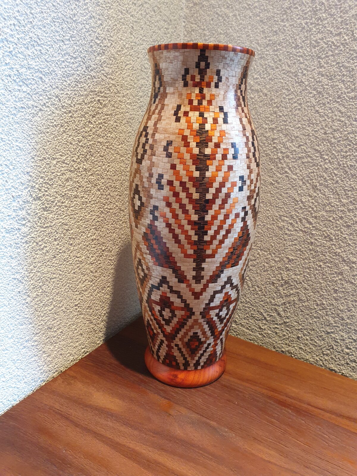

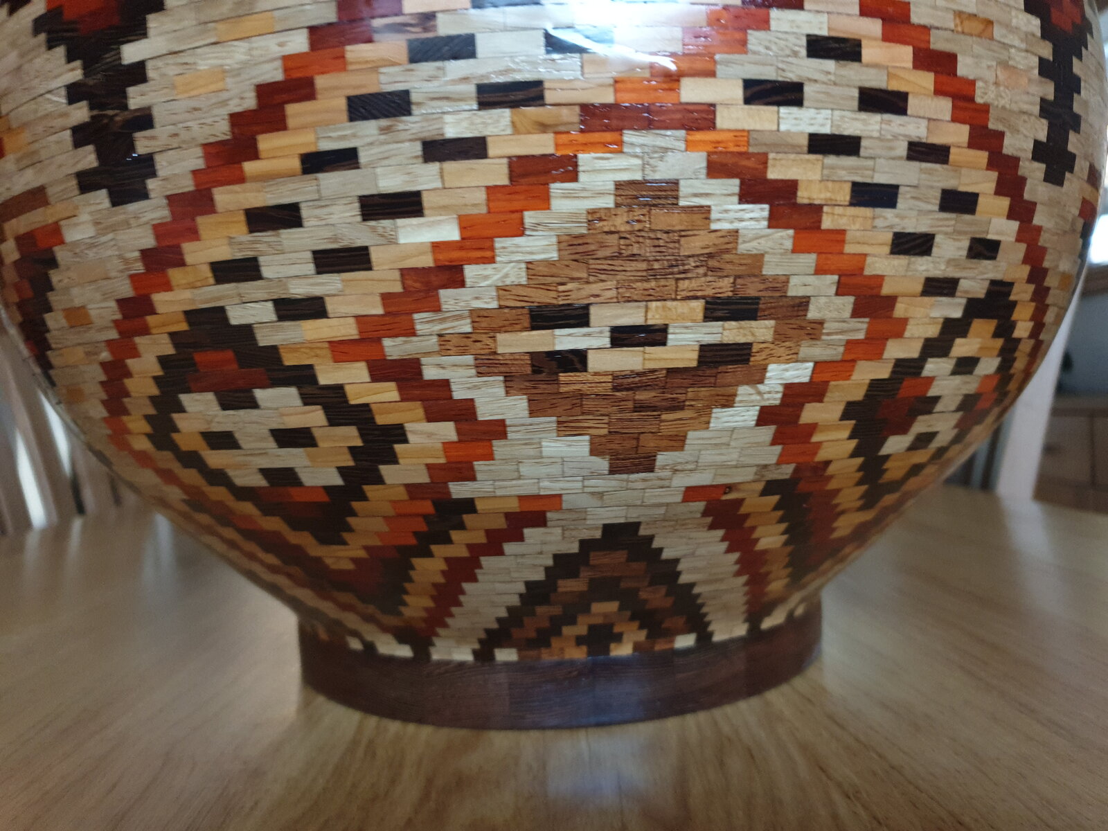

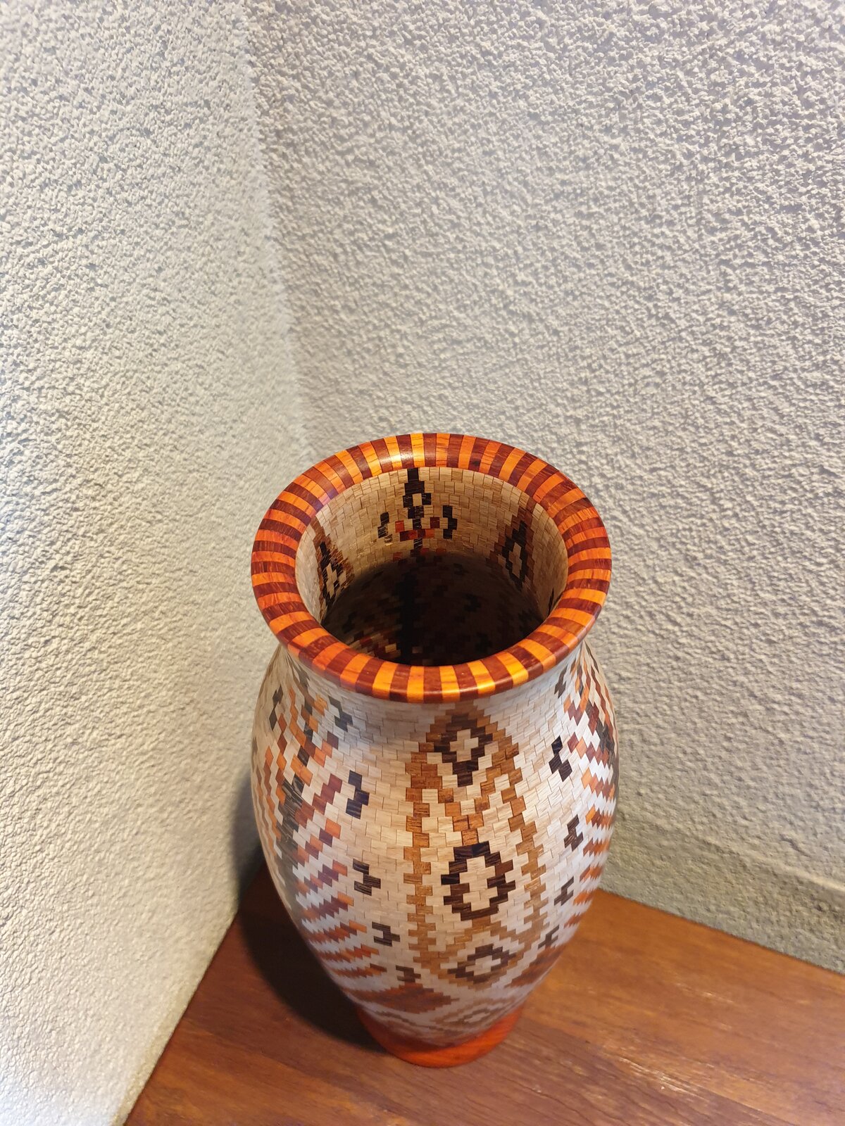

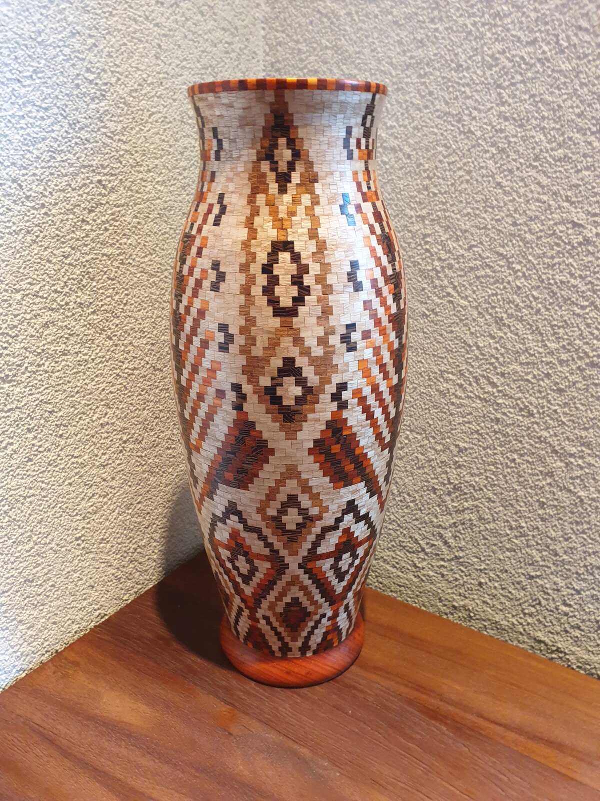

A vase and a bowl segmented ofcourse, just showing them here.
See more from peter1958
peter1958
Dec 11, 2020
230
Netherlands
The bowl is made of wenge, oak, padouk, merbau and yew. Laquered once here on the picture. almost 5600 pieces. The vase is made of wenge, padouk, ash and merbau. almost 4700 pieces. I liked to make them, smile was growing every ring. Top layer of the vase is all padouk but selected bright and darker red to alternate, nice effect.
