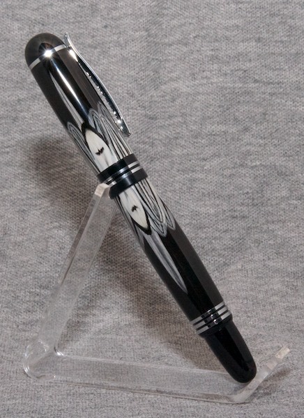

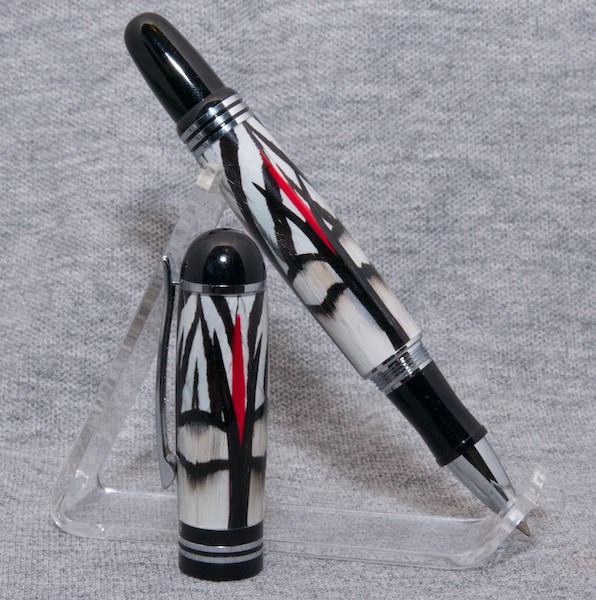

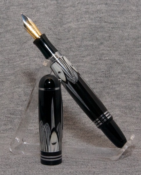

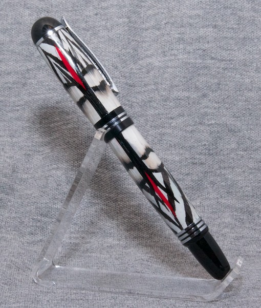

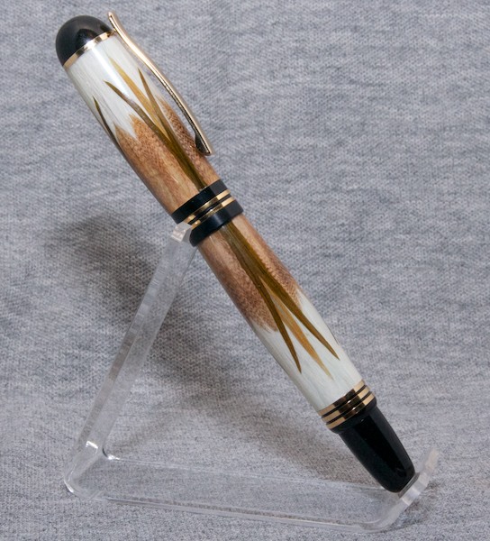

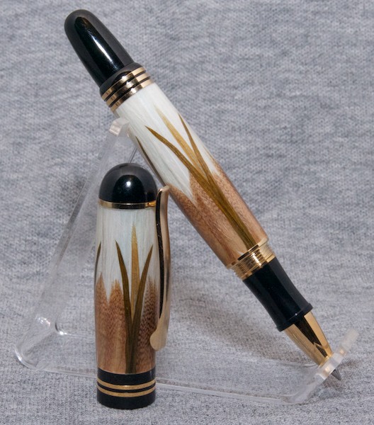

A trio of Churchills that I hope you will all enjoy. Marla did the hard part, I just made them round. :biggrin:
My Favorite by far is the black and white fountain pen... REALLY want to keep it for myself, doubly so since all but two of my "daily writers" are fountain pens, but I've decided to see how it does at a few shows... part of me really doesnt want it to sell :cool:
Hope you all enjoy, C&C welcome of course!
--Dave

Those look so nice! Marla's blanks look so beautiful,and you did a fantastic job of turning them.I wouldn't want to give any of them up!
My favorite is the 2nd one,just WOW!
Steve

Those are fantastic!!!! The third one is my favorite - all of them are remarkable.
When you price them for sale - make sure to price them high enough that you will be happy to see them go. That takes the sting out.:)

Thanks Everyone!
I find it interesting that there is so much interest in the earth tones pen... It's headed to my mother in law for a Christmas gift, so I hope she likes it as much as the folks here do :cool:
