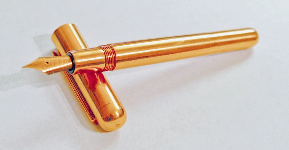

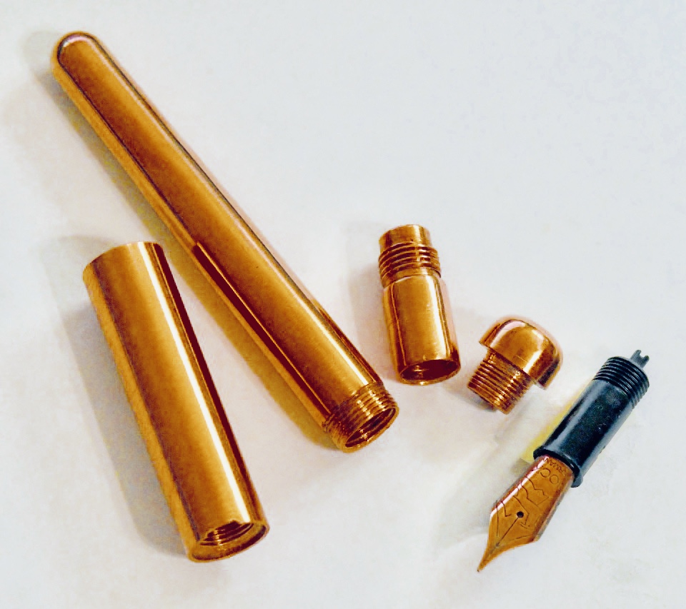

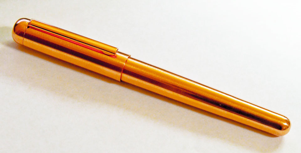

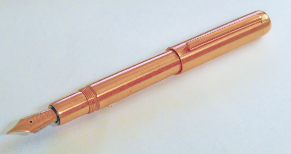

It's been a while since I have found time to post a pen. I feel like I'm coming home to a place to rest after eventful years of my life. I have missed you guys. Kids grow up and the house gets quieter. In moments of solitude, I came to the realization that the most valuable and priceless item in my shop was time spent with my sons. Those packets too fleeting to hold or capture remain treasured memories.
Nevertheless, since my sons never fail to ask "Dad, watcha been making" ...
I though I would oblige them.... so I started of with a 1/2" round bar of copper, a Bock Fine Stainless Steel Nib and an electroplating rig, copper plating electrode and some kitless tools came up with this creation---a Touch of Copper. Hope you like it. :smile: Kind Regards, Doc

Curious about one thing: Does the electroplating of the steel nib affect the feed in any way? Not questioning your work, just want to learn from it.

Lee, I welcome questioning of my work... as sometimes I have no idea what I am doing. In answer to your question.. Absolutely yes it affected it!
That's why only the top of the nib is heavily plated and polished to allow for flow. The area below is still polished steel.

Looks great ! Did you finish it with anything to retard patina development ?
Thank you, Not yet.. Have two spray products that I am deciding on....
