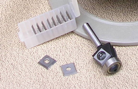

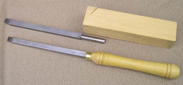

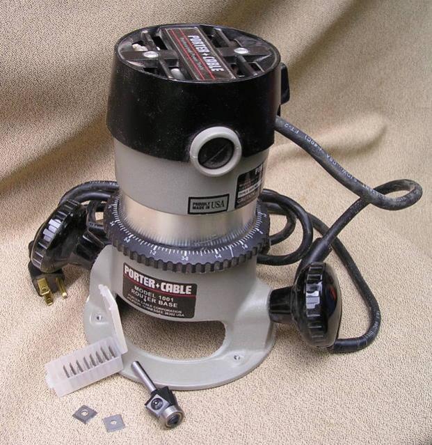

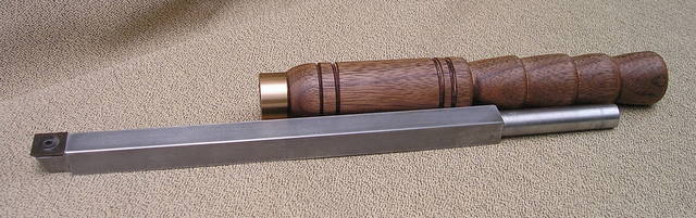

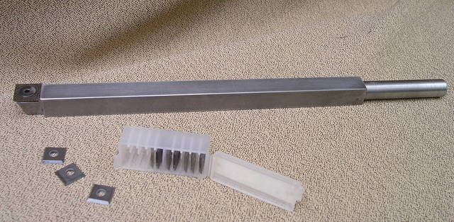

OK,OK, I may not tell the best jokes but I do know a thing or two about how to make a great tool. What follows is the "mating" of tool technology (carbide inserts) from router bits and designing a steel handle to inspire the best cutting skew available today. This new styled skew is easier to handle with no vibration at all. The handle absorbs the "shock" of turning and the solid carbide (disposable) inserts provide the cutting blade. The inserts are as sharp as a rasor blade and stay this way through multiple pen turnings. Simply rotate the insert as the blade dulls and you have an instant "scary sharp" edge at your disposal.Turn a wood handle to suit your needs and you will have an heirloom tool.
As a self admitted tool junkie, this is currently my favourite shop tool to date. I'm turning "cylinders" without effort and best of all, I don't need expensive sharpening jigs and grinders to keep my "edge" at peak performance. If you care to offer an opinion, I welcome your comments especially if you have used the one sold through CS-USA.

In case I did not clarify it well, this new handled tool was machined in my uncle's shop based on current designs as that offered by CS-USA. The carbide cutters are larger than those offered at retail and considerably less cost than the $13.99 each price in the catalogue. I paid $6.00 CAD for mine and they cut blanks as if it were cutting through butter.

Similar design but NOT exactly the same. For one thing I am using a "harder" material than SS. The insert size(s) is different dimensions and cutting angle. Mine has been engineered and designed for pen making and not bowl turning. If I decide to go and make limited production numbers, I plan to black anodize the bars and incorporate some other subtle changes based on input from IAP members. Pricing will also be "milder" than current CSUSA offering especially for the inserts.

Thanks Peter. I will try to give the info on size. The tool holder or square bar is very very close to .500" so I would call it a half inch square bar. The "seat of the cuter itself is then also .500 and the distance between the actual cutting edges (on top) is .594 inches. The stock cutter is square but there are some a couple of curved cutters. One has a radius on the cutting edges and the other has a radius on the corners. I would be interested in whatever shapes I can find. If you need hole dimensions I can try to measure that also.
