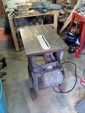

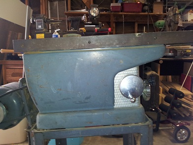

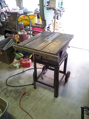

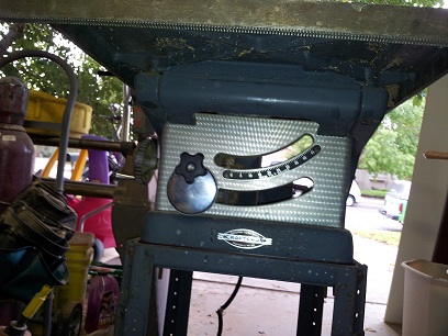

Obligatory before pictures.
It doesn't look great or bad, but it could use some love and it howls like a banshee.

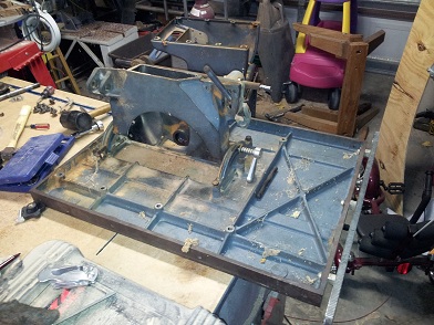

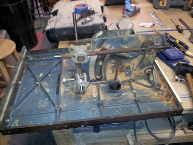

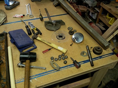

Here is its current state. The motor runs and sounds great, its pulley is fixed and polished, and the new bearings showed up.
It is going to sit like this until at least Saturday because my son turns 3 tomorrow and we are going to spend most of the day at the park.
I will update as things progress.

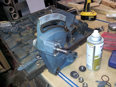

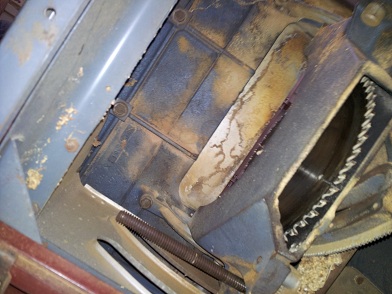

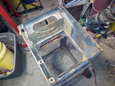

Well, I couldn't sleep last night, so I got ambitious.
The new bearings are in and everything is cleaned/dry lubed except one piece of the arbor. As a side note, I discovered that only one of the 6 bolts holding my trunnions on was more than finger tight...

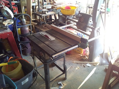

The main saw is done.
There is .006 runout on the blade (diablo that I have been using for a few years) and .004 kickout along the length of the miter slot.
I have not squared the new fence yet, but she sure looks and sounds good. I plan on building a cart with a router table for the space between the rails next.
