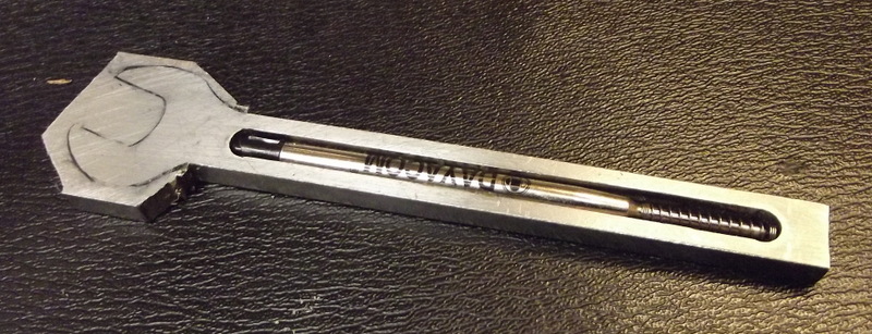

I haven't been here since this post I made in May. I've lurked, but decided I wouldn't post again until I in some way could properly thank Peter ' Penpal' Hay for his wonderful gift he sent to me. :redface:

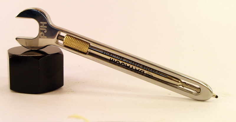

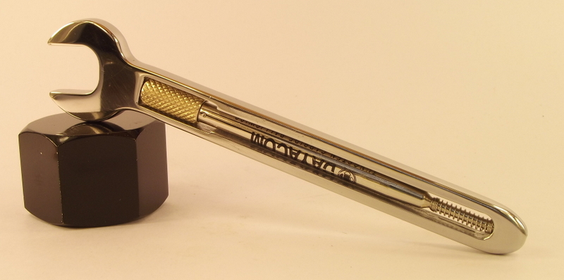

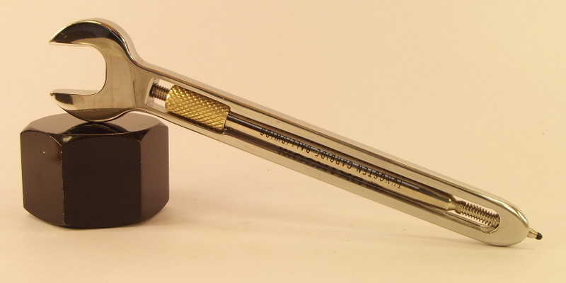

Well Peter, my friend , this is what I came up with. Not much I'm afraid, but I think it's pretty unique and really made my old grey matter work overtime to put my idea into reality.
I have just this minute got it back from the engraver and took the last pic before wrapping it up and sending it on it's way.
I hope you like it Peter !! :biggrin:
I call it a Spenner.... a cross between a pen and a spanner..:rolleyes:

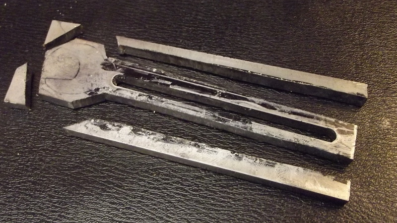

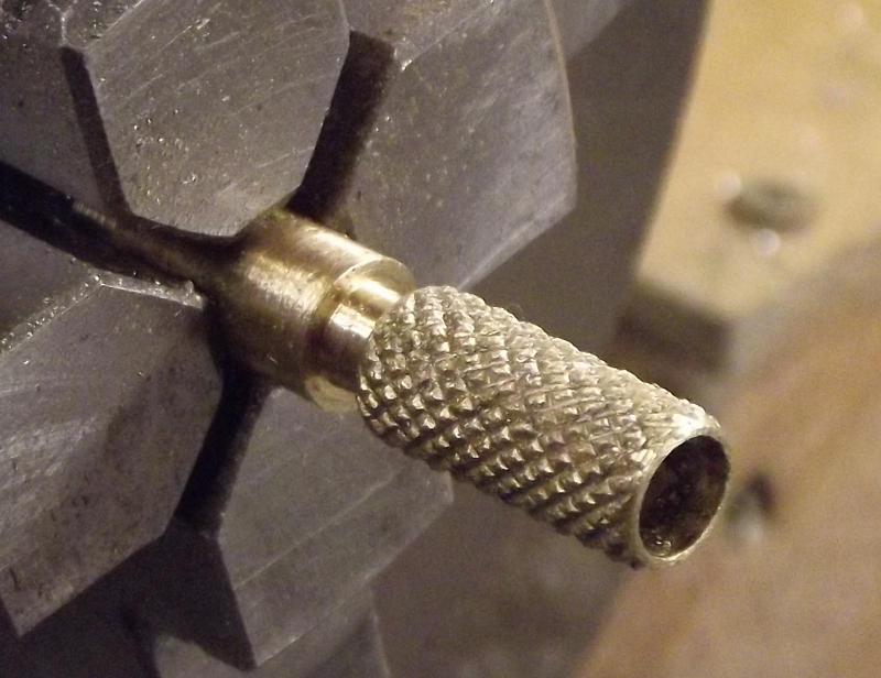

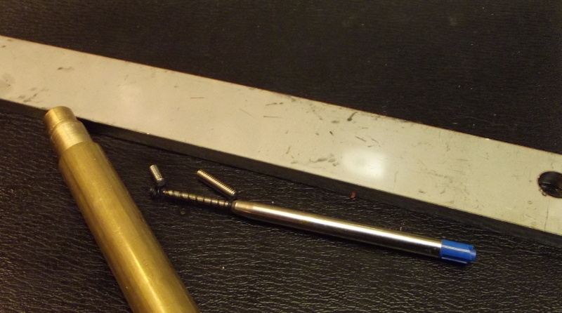

It is made from 6mm thick stainless steel flat bar, a bit of brass knurled for the 'mech' and two 4mm Allen Grubscrews and of course a parker style refill.
It is actually the correct size for an 8mm nut/bolt...13mm

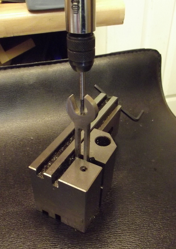

Some of the progress pics as well.
No blood making this one....but plenty of blisters.....:biggrin:

You did not mention the spring. But where are the two Allen screws?
Pierre, I'll gladly tell you why two grubscrews, but perhaps you or someone else can figure it out.:biggrin:
Look in the first set of pics....there are two grubscrews, one long and one short.
Although they are in the same threaded hole, they each serve a different purpose.......:wink:
I'll pop back and see who gives the reason...no prizes tho...it's actually a common engineering practice:biggrin:
Thanks again for all the cool comments. Always appreciated:biggrin:

Lin, of course you are perfectly correct. :wink:I suspect Silver knew as well :biggrin:
The brass thumb screw travels up and down the long grubscrew. Although the steel/steel grip is slightly more than the brass/steel grip, there could be a tendancy for it to unscrew. As Lin said, the short one simply bears against the long one and holds it in place.
If/when Peter needs to change the refill, he will remove the short one and back off the long one while holding the thumbscrew. Then the refill along with the thumbscrew comes out.
I packed in an Allen key and a couple spare grubscrews.....just in case..:biggrin:
