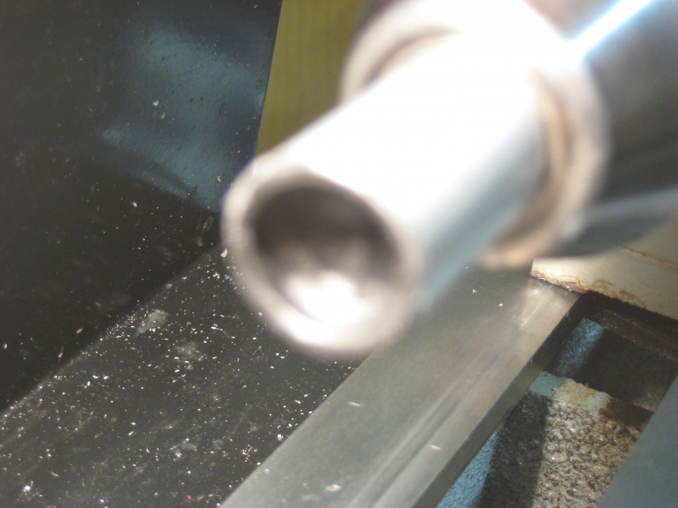

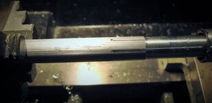

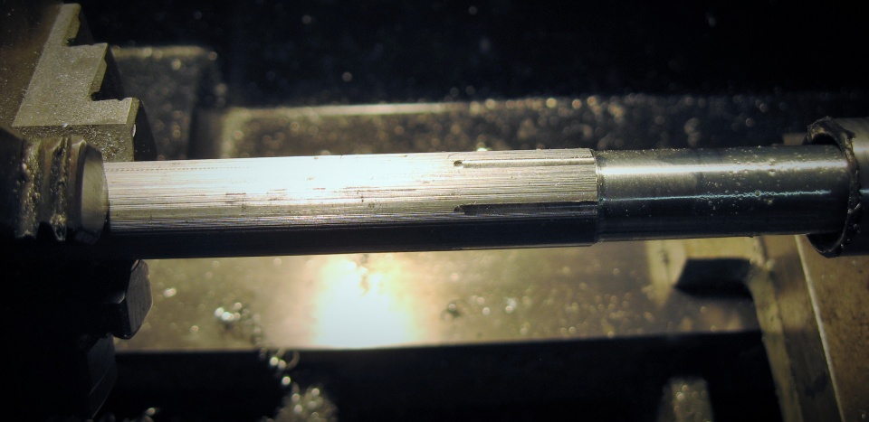

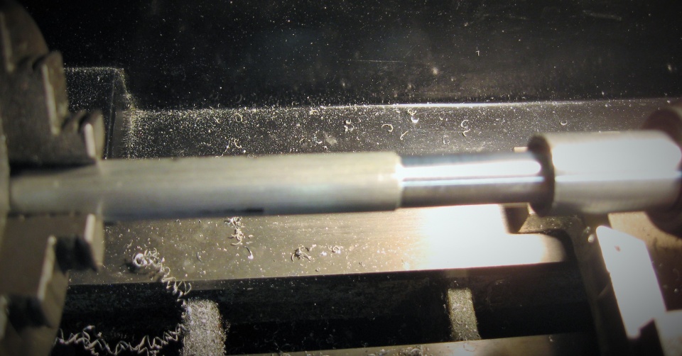

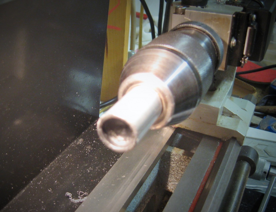

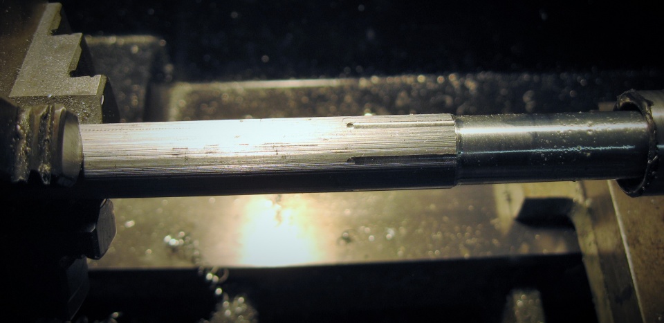

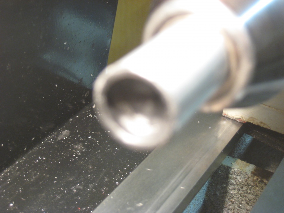

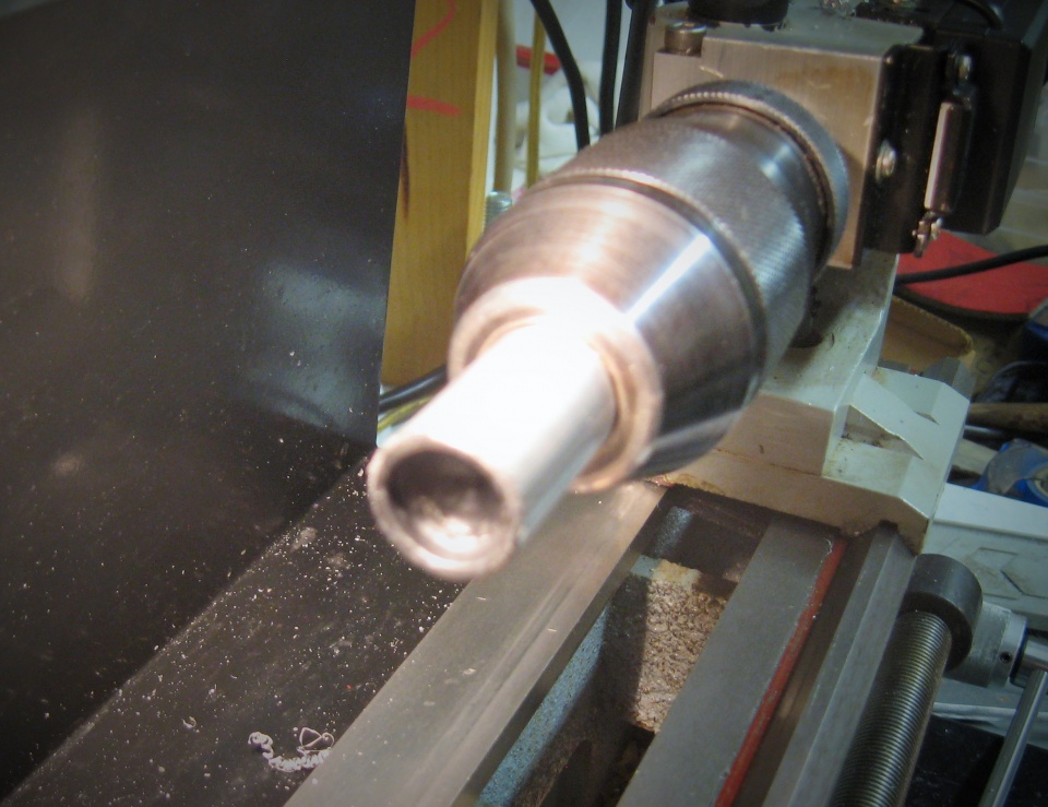

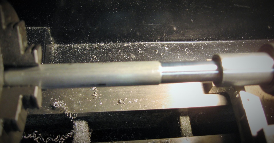

So in preparation of using the router attachment Mike Roux made for me last year, to cut some flutes in my pens, it became apparent that, I need a way to hold the parts between the head stock and, tail stock. So, I made this little piece. Turned a shaft to fit into the drill chuck, mounted on the tail stock then, drilled out the other end. Then painted the inside of the cup with Plasti-dip, for grip and, cushion so as not to mar the pen body.
It works! :biggrin: I apologize for the blurry pics. They looked ok in my camera screen :redface: Hopefully your imagination will kick in :wink::biggrin:

Flutes, do I hear flutes ? I hear there are real possibilities for flutes!:tongue:
The cuts look very nice for a trial run.
Yes...you hear flutes :biggrin: There are indeed possibilities for flutes. :wink: They just need someone who knows how to apply them. :rolleyes: I'm working on it.
Thanks Mark!

The use of flutes and other decorative cuts will open a whole line of possibilities. You have just started down a very interesting path in pen making. We all have seen Skips ideas and now you will be sharing with us many new ideas as well. It can be some exciting times here. Keep it up Chuck. Well done.
Again sorry about the interuption. Included an example of what I meant.
John! Not at all bothered by your post. In fact you probably saved me some work.:biggrin: In due time you will see a pen displaying these particular kinds of flutes I have in mind.

Your pictures suck making the slots or flutes look un even ?
Are you using a router bit or a slitting saw on your router
Basic tool bit or slitting saws and mandrels needed

Make sure your router doesn't turn to fast for the these tools.................

How do you ensure the Plsti-dip is evenly applied to the hole? Does the Plasti-dip self level?

Thanks for your straight forward opinion of my photos. I guess my apology wasn't enough. I'm using a Harbor Freight trim router as it, fit the budget. I have an assortment of bits and, right now, a slitting saw won't work for me. But, we'll work on that. Thanks for the links.
Well Chuck my problem is I am not wrapping my large head around your concept:eek: I do hope you take some gooddddddddddddd photos:) when you get in production mode. A friction fit just seems it will spin or slip on you as you apply the router force. Like I said I probably am not seeing the whole picture:)

I posted this thread to give this forum some substance other than "Which metal lathe"? OR, "What tools do I need" etc. It went how long? Skippy missed it....I think everybody missed it :rolleyes::biggrin: Granted...the subject content is NOT all that impressive anyway. :redface: But, I made an effort. Just MY opinion, but, as log as this forum has been up....and, there have been many who have bought lathes.....where are they? :confused: :biggrin:
As for the Plasti-dip, I used an artists brush to paint the bottom of the cup. Gravity is a wonderful thing :biggrin: Let it set up then painted the sides. NO...it's not perfect but, it works. There could be a better way to do this but, that's what I came up with at the time. Was kind of in a hurry as often is the case.

John, I understand your concerns. There is not that much pressure against the blank with the router bit. But, I needed a way to hold the tail stock end of the blank inline with the headstock end to, cut lines (flutes) in the body without marring the pen body. I guess my poor photography failed to demonstrate the purpose :biggrin:
When I get time, I may do this over. :wink::biggrin: Thanks for the help!
I wasn't trying to be rude, If I don't have a sharp image of the slot I am left guessing on how to help you.....
Your picture is blurred ..... and I am trying to help you with what info you supplied....
Me saying your picture sucked , was said to cover my own butt,
If the slot you cut was smooth and I go off saying your slot or flute looked uneven , I needed you to know why it looked that way to me and had nothing to do with your apology.... ( sorry )...
Can you photograph your flute again and can you post a sharper image.
