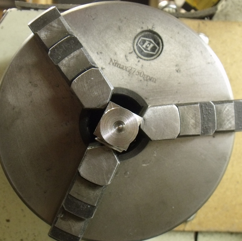

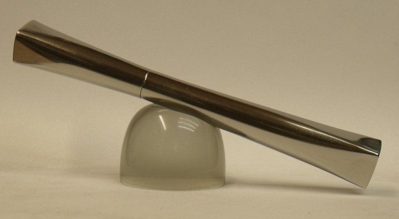

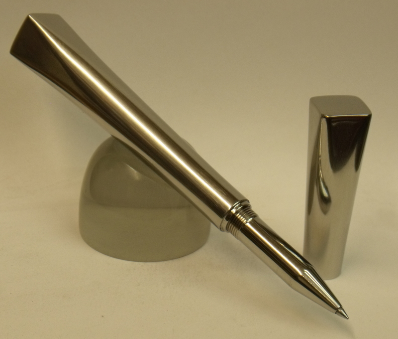

Nothing fancy I'm afraid... This didn't even start out as a pen, I was just practicing a theory of mine about holding square stock accurately in a three jaw scroll chuck on my metal lathe.( I used my adaptor faceplate of my 4 jaw chuck for another project so it was out of action. )

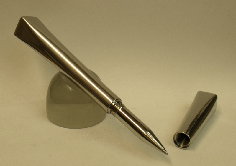

Anyway....it worked out fairly accurately and this is the result. A 3 piece, double closed ended rollerball pen in stainless ( of course !! :biggrin: )
Maybe this is the kick-start I need to get back into pen making :wink:
The third pic simply shows the step and recess that I think is necessary ( IMHO ) between the pen and cap. It's on every kit pen but often not done on some kitless pens I've seen recently.

Superb, Skip !!!! (.... nothing fancy, he says, but I think it is superb !! )
I Like It! A very nice transaction from square to round and a flawless finish, as usual. Nice to see you turning again!
Wow! I am glad I checked in. It's good to see one of us is still functional. I REALLY like this one Steven. Very nice!
Yes.....the STEP :rolleyes: I am guilty of being one who, doesn't usually do that. But, now I see that I should. :biggrin: Thanks for sharing pal!

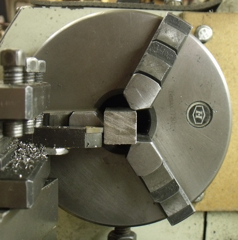

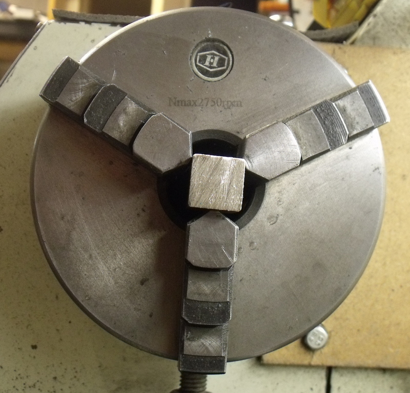

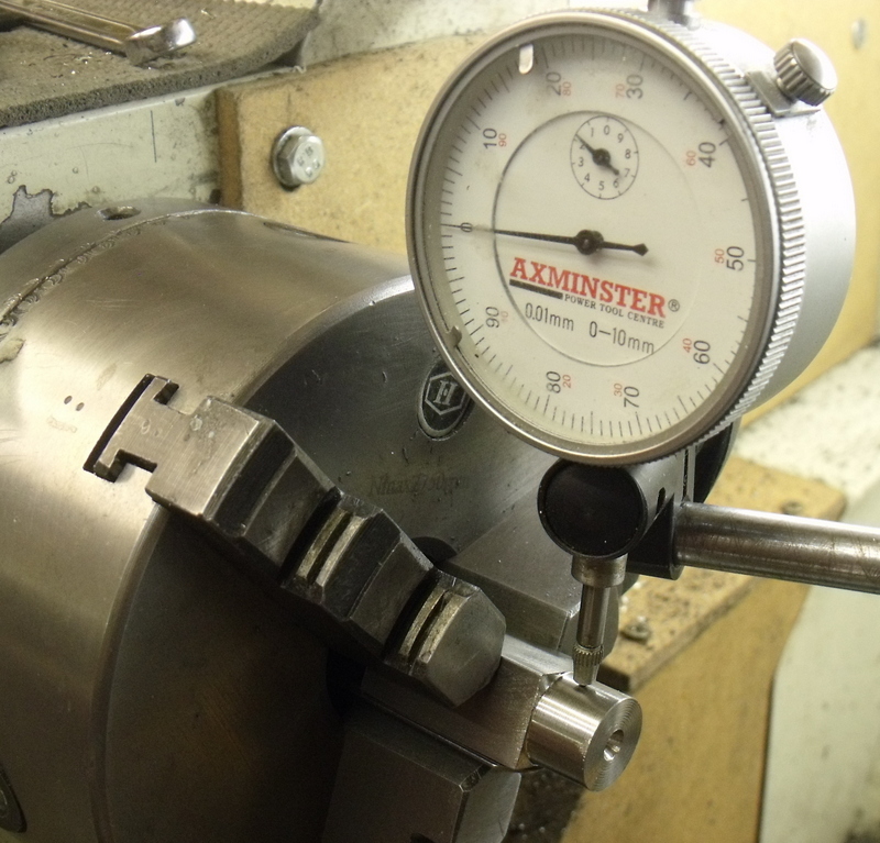

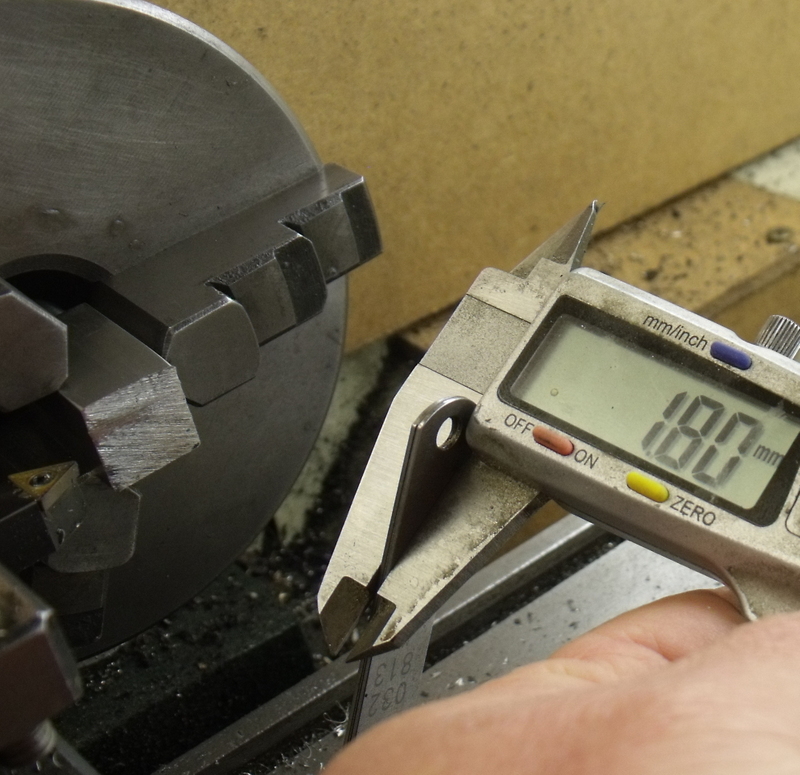

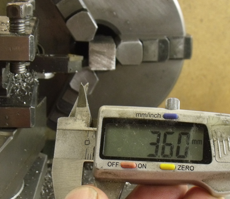

Here's what the actual practice session was about... ( before it became a pen )
I'm pretty sure this method is used by many people but as I have about 10 meters of the square stock, I figured I'd actually measure it for future reference, instead of just eye-balling it....:rolleyes:
1. Clamp your square stock in the chuck. ( keep the same jaw orientated)
2. Rotate chuck so lowest stock surface just touches cutter.
3. Rotate chuck 180 and measure gap between cutter and stock
4. Select feeler gauges to match half the gap
5. Fit the feeler gauges under the stock on the same jaw.
6. Test
