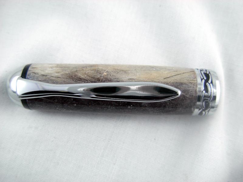

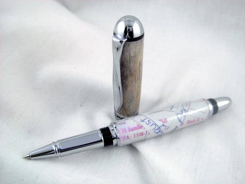

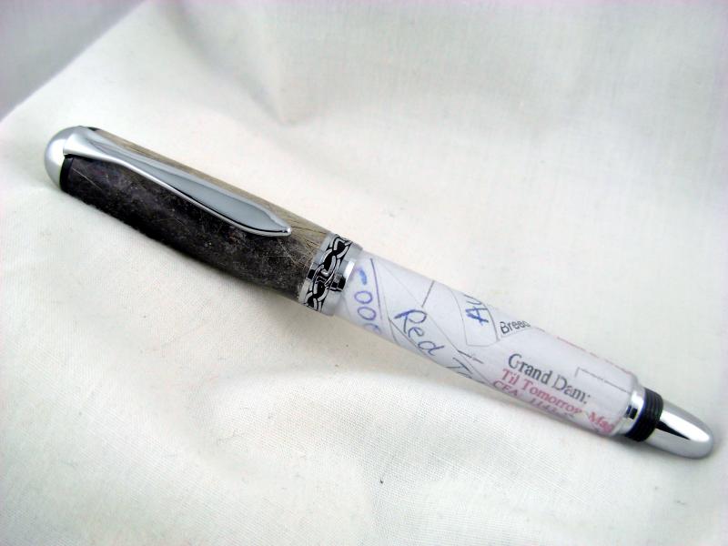

Todd
I had a request last year from a man who wanted a pen made from his wife's pets fur, two cats and a dog. They had recently lost one of their cats and he wanted a gift that represented their pets. I told him I'd give it a shot but no guarantees.
I made a Sedona. The cap was made of the pet fur (3 separate sections), the barrel had a collage of the dead cats pedigree and vet info.
After several failed attempts I was almost out of fur. I ended up with a "usable" cast but wasn't real happly with it.
The fur gets messy when it gets wet. You've seen a wet dog / cat!
Anyway, the colours changed and the fur matted. In my opinion my pen looked like a dead mouse.
But he loved it. Go figure.
I swore I would never try this again. Not sure how horse hair would react.
Good luck
