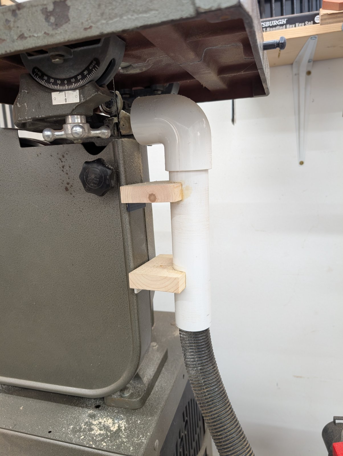

One of the things the Doctor keeps telling me is to stay away from wood dust. I agree and for my table saw I have a HF dust collection system that works great. The problem is all the rest of my power tools are old...40+ years old and none have any kind of dust control system on them. My band saw is the worst offender as it creates a ton of dust and I couldn't figure out how to control the dust on it. I don't need new tools as the ones I have work great and I know all their little problems and glitches. So I made my own dust collection system for the band saw and it works pretty darn nice. Probably cut my dust down by 90-95% so I'm pretty happy with it.
How I did it:
1.5" PVC conduit
1.5" PVC elbow
1- Harbor freight 6 gallon shop vac
1.5" flex hose (I got mine some years back when I was working an electric company and they were throwing reel after reel of this stuff away (what a waste). Wish I'd got more).
4 rare earth magnets
2 saddles (I made myself)
The dust collection system is held in place on the saw by the rare earth magnets (Compliments from my wife's hobby of making greeting cards for the troops...long story)

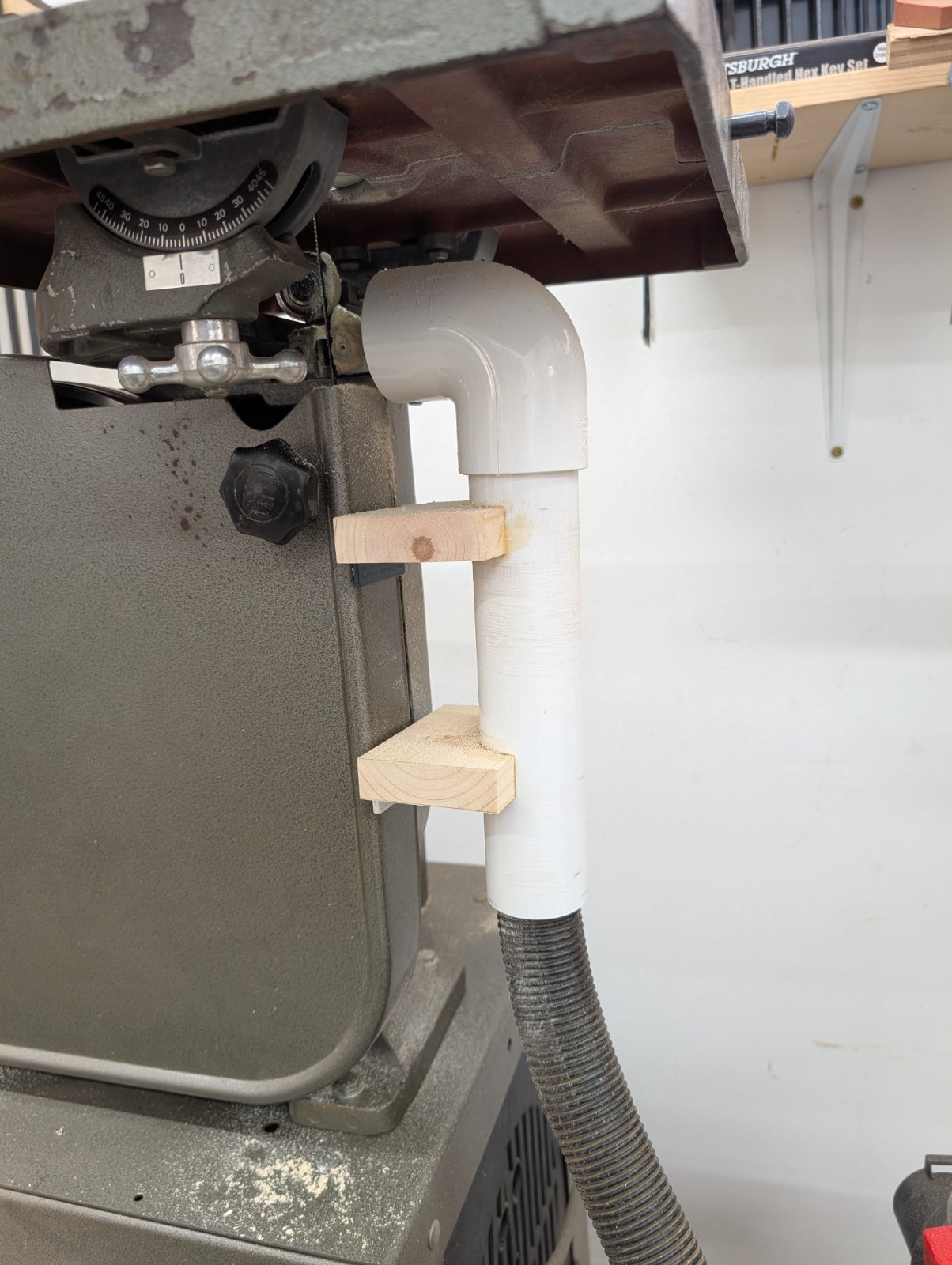

Here's some photo's (with and without the dust collection system on)

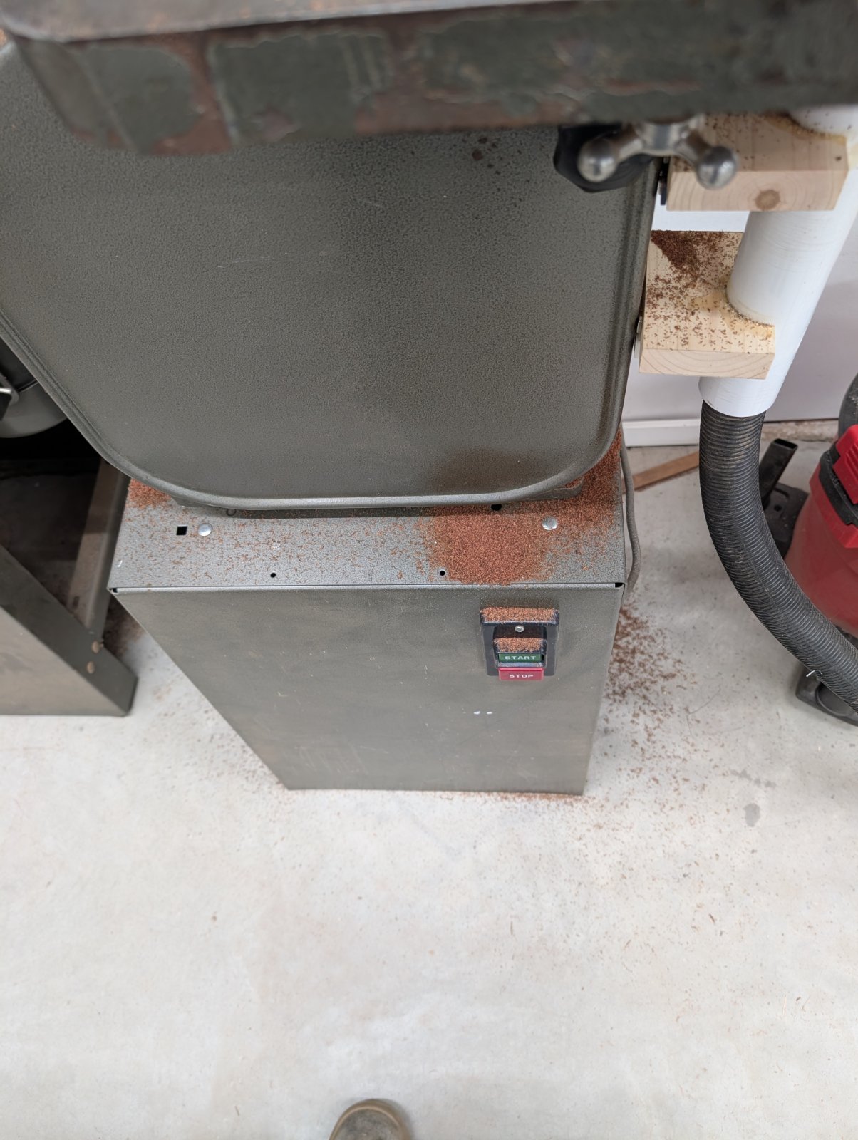

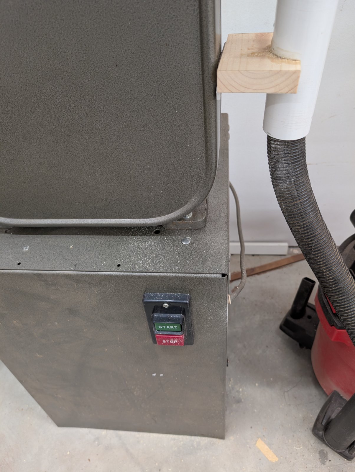

The first photo shows with the system on (notice very small trace amounts of dust on the band saw stand)

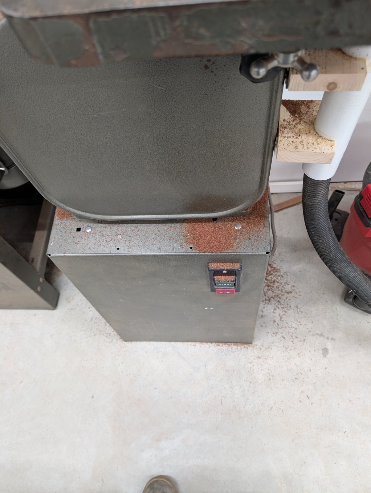

The second photo shows the system off (notice the amount of dust on the band saw stand). It also shows how the system is attached.
I've also noted a very small amount of dust when I have to change the blades on the bottom of the metal wheel guards.
Thanks for looking.

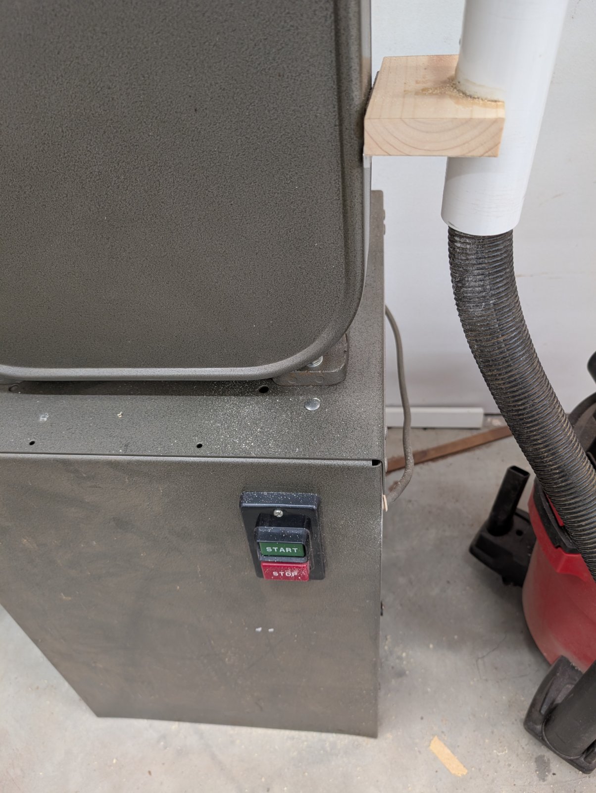

Thanks for everyone's comments. It does get me to thinking though, which never a good thing. Today will be the true test. I've got 16 knife scales that I need to resaw which normally causes a ton of dust and debris. I'll let everyone know how it turns out. Maybe a photo too. Thanks again.
So here's what resawing 16 knife handles look like dust wise. Normally the entire saw stand would be covered and the floor would have a covering of dust to go along with it. Also, when I had to change bands the metal guards that wrap the front of the wheels were dust free. Maybe not 100% but I would say a lot better than before. I'm happy with the results. Thanks for looking.
