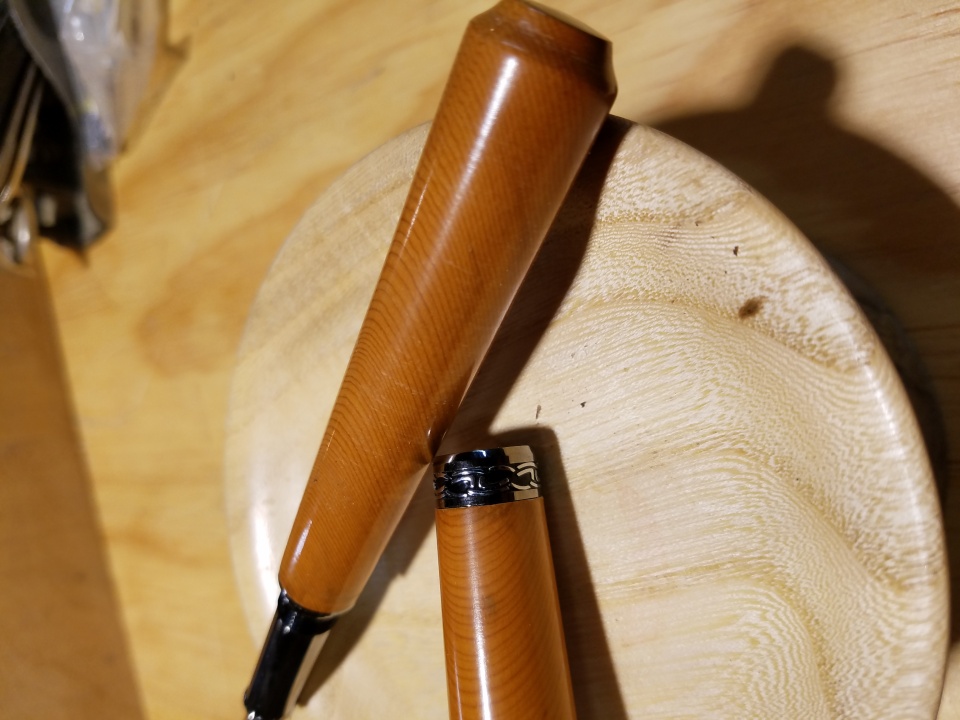

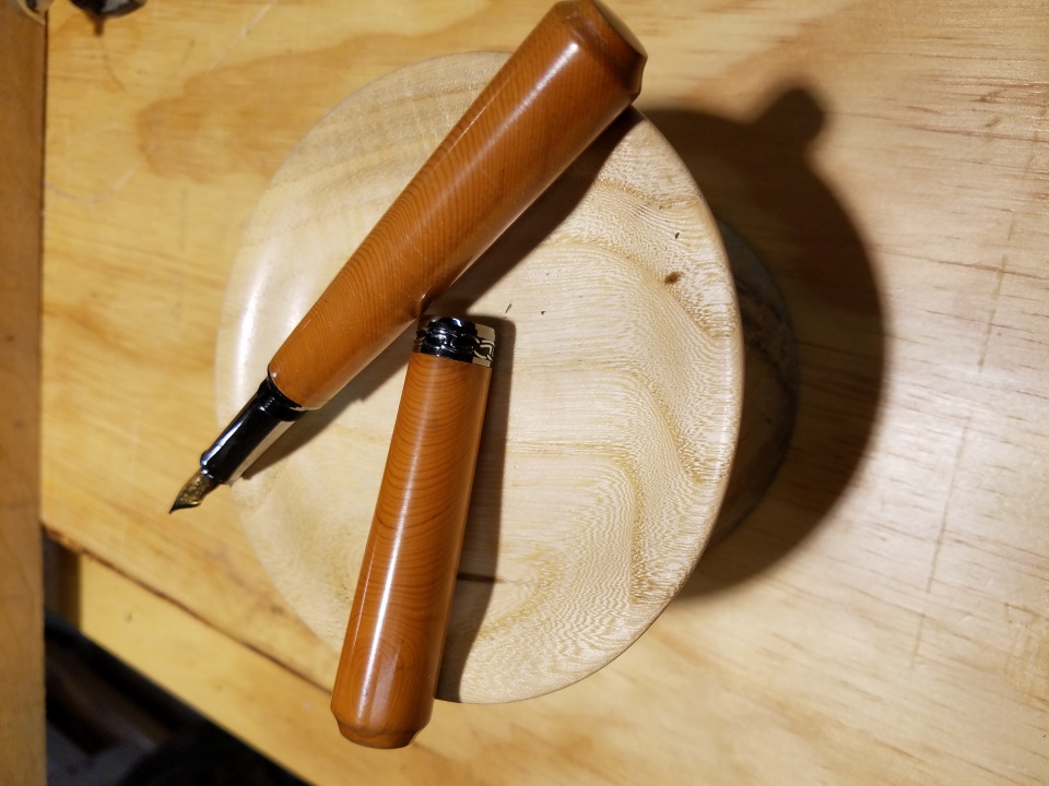

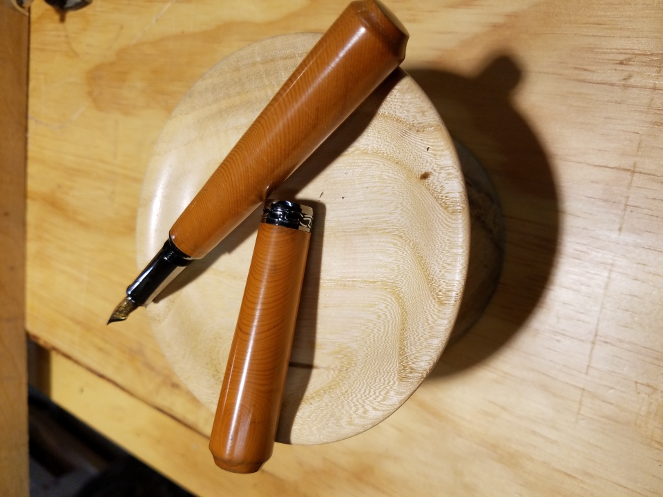

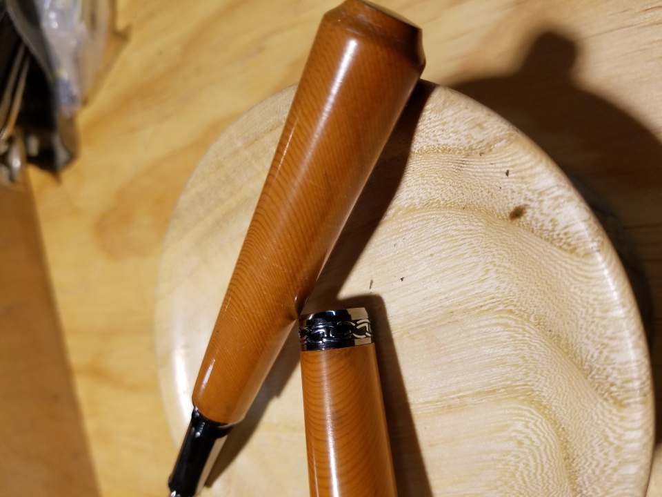

Douglas Fir is surprisingly a beautiful wood to turn. It is very plain from a distance but up close the tight grain pattern is beautiful. Agree with others to try and find a section of crotch or a branch, that will help with the grain pattern.
A few years back the IAP had a pen swap where the pens had to be made out of Pine. Was not an easy job, I picked a Spruce Pine that just flaked apart on me. Alot of CA on the fourth attempt kept it together. I received a fountain pen made out of Douglas Fir. I don't remember who made it but he did and excellent job. I have included 2 pictures. One is a close up of the subtle grain.
