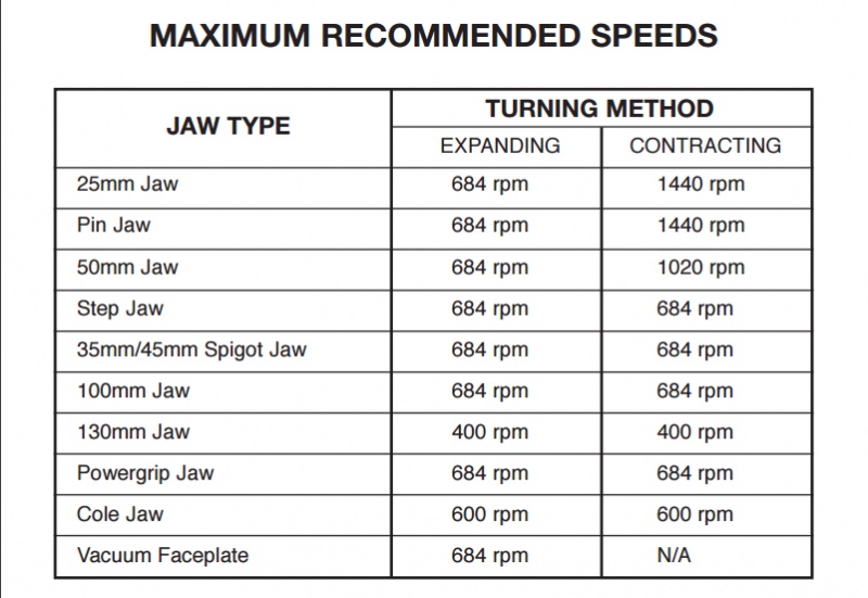

edstreet
Aug 12, 2007
3,684
No longer confused....
Incorrect Bob, and others. Here is the proof.
page 8 and 9
http://www.teknatool.com/wp-content/uploads/2016/10/ACC-NOVA-SCROLL-Jaw-Manual.pdf
EXPANDING DOVETAIL OPERATION
Expansion of the jaws into a recess. This function is for bowl and platter turning
where the projection (depth) of the wood blank is not too great. Specific sizes for
each jaw type is stated in that area. Please refer to the Nova Chuck/SuperNova
Chuck manual for information on how to form a recess.
When making a recess it is important to calculate the depth. The recess depth is
an important consideration for maximising the holding power of the jaws,
guidelines under each jaw should be followed closely. The depth of a recess can
be varied according to the size and mass of the workpiece. Larger bowls and
softer woods require a deeper recess. Smaller lids and thin platters generally
require a shallower recess. Always use a recess depth in excess of what is
required. IF THERE IS ANY DOUBT INCREASE RECESS DEPTH.

Bob Wemm
Mar 9, 2012
1,994
Kalbarri, Western Australia
Hey Ed.
It doesn't make any difference what the "Recommended" specifications say, as long as there are humans on this earth there will be accidents, and people will get hurt.
It's up to every individual to do what they feel is safe and use the "GUIDELINES" as a base.
Take a look at the Millions of Dollars that Mining Companies had to spend under "Work Safe" regulations, did it stop accidents???? Definitely not.
For me, if the wood is slightly unstable I never use an "innie", but then I just might, depending on other factors, same applies to tenons.
My 2 bobs worth.
Bob
edstreet
Aug 12, 2007
3,684
True. I did show however that one method is substantially inferior for griping and safety standards and if you look at what AAW states on the subject it will be in line with what I posted. However if someone wishes to forgo safety then the blow out or accident is on them and not us.

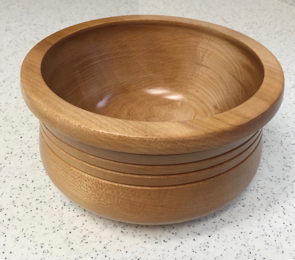

I have included a picture of a bowl I just finished for my son in law. It was spigot-turned, but the spigot isn't as nice as I would like. The bowl came off the lathe (no injuries and not any significant damage because the speed was quite low) but I had to clean up the spigot and it wasn't as sharp as I would have liked.
My sincere thanks to all who have contributed to this thread. I have learned a lot!

I have a Nova G3 with the 50mm jaws. While the spigot hold is dovetailed, the tenon hold is square with a bit of a 'tooth' on the outside rim. I don't know how else to describe it. Could you include a picture of the grind on your scraper?
I think the instructions for a tenon using this chuck say to cut it parallel and the jaws then grip it tightly with what I think is called a houndstooth...
