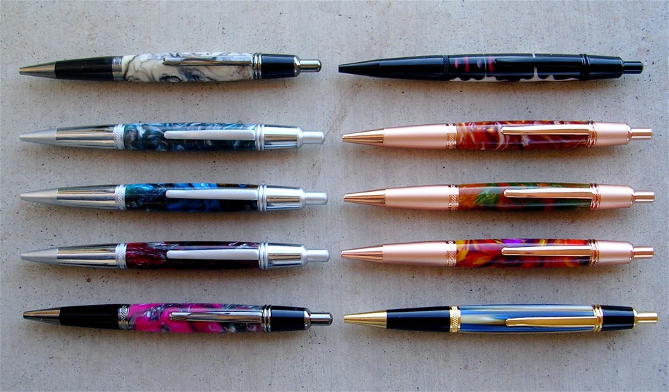

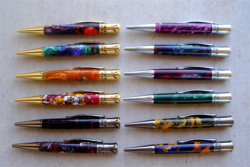

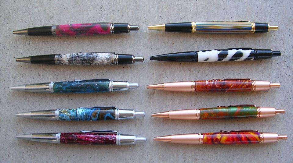

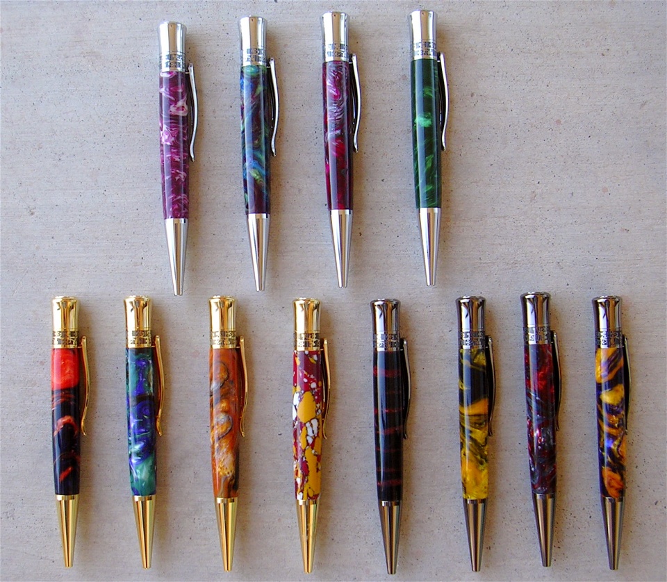

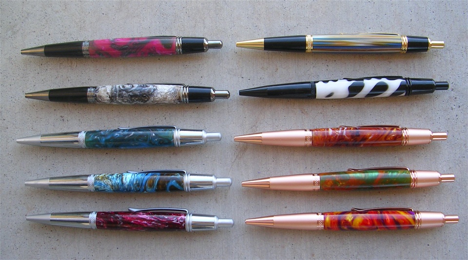

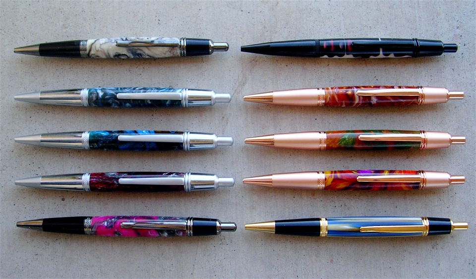

I made use of my extra day off yesterday and worked on some Sierra Button Click pens and some Glacia Pens.
I wanted to use up some cut-offs I had from other projects.
These are not the best photos but close enough on a busy Thanksgiving Day.

Thanks for all the kind comments. Using simple production methods makes this kind of work go rather quickly. The difficult part is picking the plating to go with the blanks *G*
Some could go with more than one plating which is what I faced with the Glacia kits. I do like the look of that kit and how it really shows off a blank because of the longer length. They are so easy to turn being a single barrel and assembly is a breeze.
