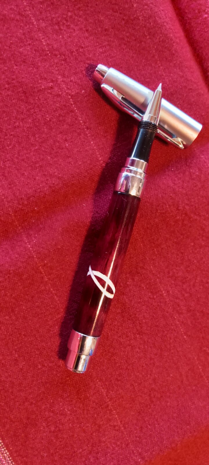

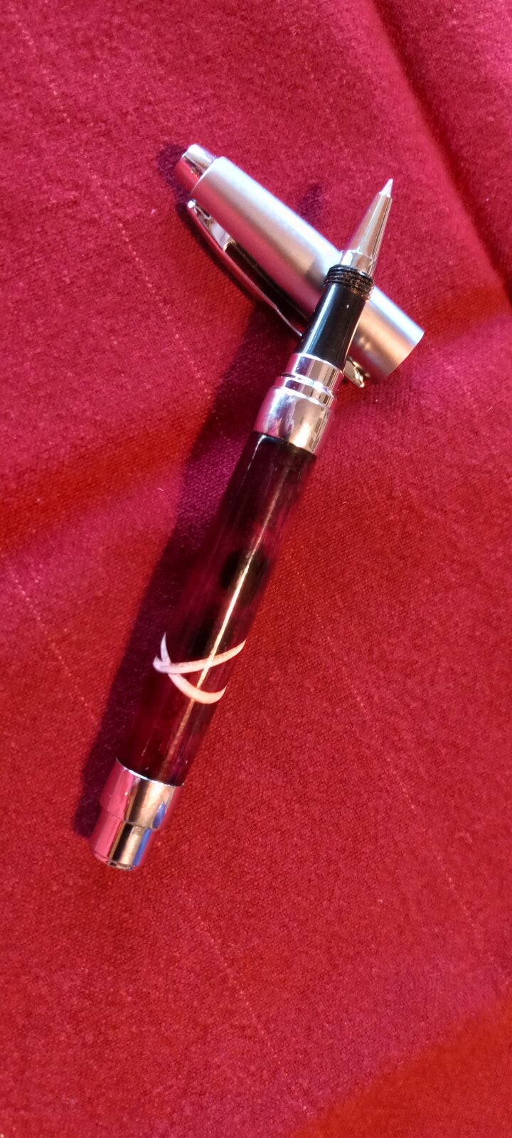

I was recently asked to create a pen as a birthday gift for a graduate of Texas A&M whose school colors are maroon and white. I decided to make a pen that was a little different to showcase how different A&M is from most other schools. I chose a Presimo kit from PennState and used purpleheart for the body. I used a propane torch to heat the wood after it was turned but decided not to make it solid to represent the varied nature of A&M. In addition, I made two rings around the body filled with plastic from an old security firm sign. I offset the rings to make them non-symmetrical for the same reason as above. I finished the pen with CA. The customer was very satisfied with it, and I got several more requests for pens from others who she showed it to. The photo somehow emphasizes spots from the torch, but the actual pen blends much better.

Hey, Lew, that is lovely work.
Did you grind the plastic from the sign to make the inlay or shave off thin strips?
I've used a heat gun with purpleheart while still on the mandrel to get it to darken. The red background really makes the pen look more the A&M maroon.

Hi Derek
The sign was exactly the width I needed to fill the gap I made in the blank, so I just cut off some strips, sanded them and expoxied them in place. I have also used a heat gun before, but to get the effect that I wanted I felt it was better to use the torch.
I like the Presimo kit. It's easy to make and a lot of people like the rollerball rather than an ordinary ink pen refill. I like a ceramic rollerball so I replace the one that comes with it and keep it only for those I give away or keep for myself.

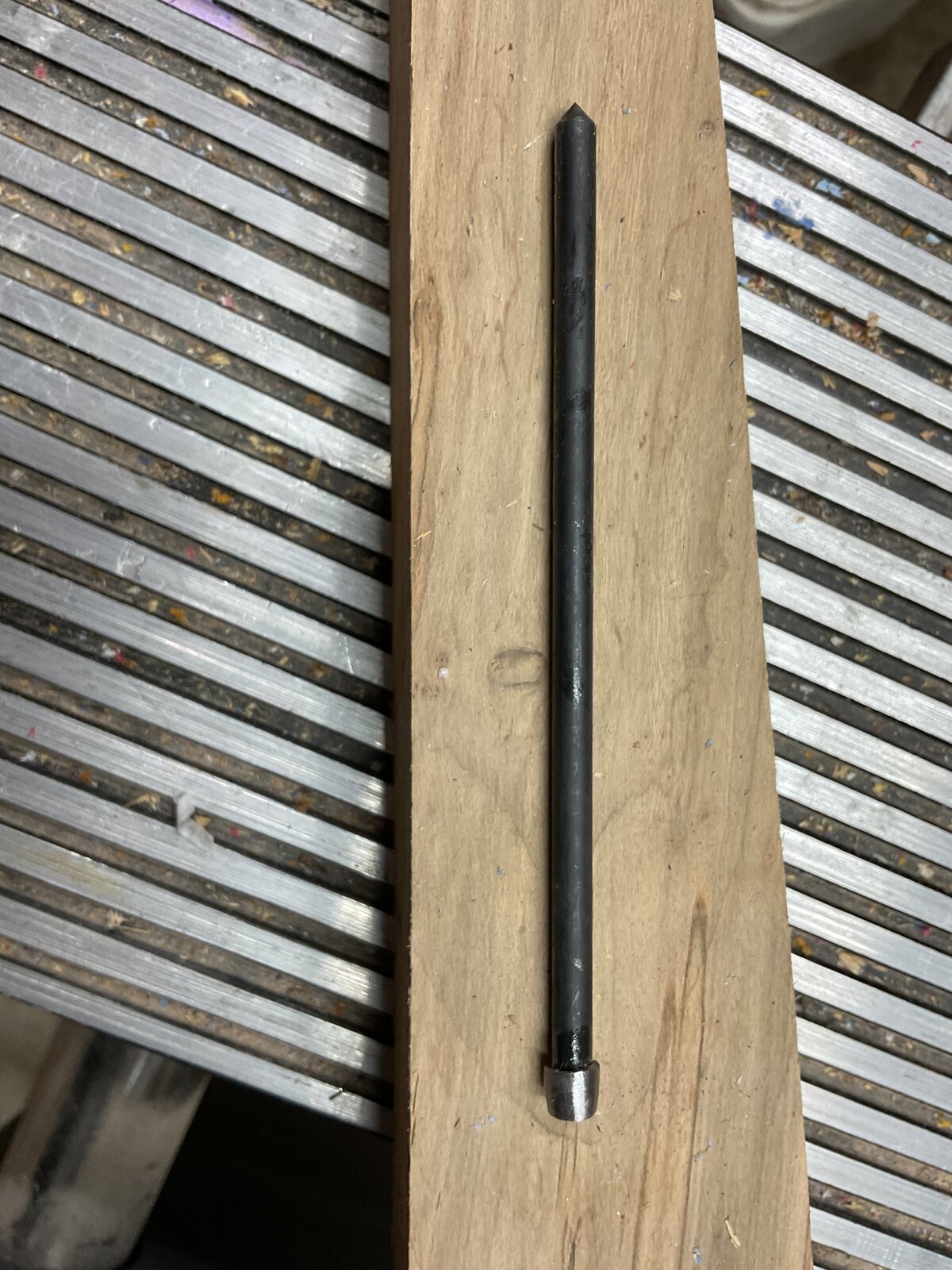

Pretty pen, Lew. If you aren't already aware of it, the retaining nut inside Presimo caps has a tendency to back off, causing the whole cap assembly to fall apart. The fix is to unscrew the nut, remove the screw, apply red loctite and reassemble. I made myself a nut removing tool using a 5mm socket and a transfer punch. Saw the top half of the socket off with a hacksaw. Insert an appropriately sized transfer punch halfway into the socket, using red loctite. When dry insert the punch into a drill and using a disk or belt sander, sand the socket diameter down until it fits in the cap and over the nut. Be careful not to over do it. Check often. Whenever I get a Presimo order in, I always disassemble the caps and apply red loctite to the nut. Here's a picture of mine. Not pretty but it does the job.

Thanks. I was not aware of that. I'll give this a try.
