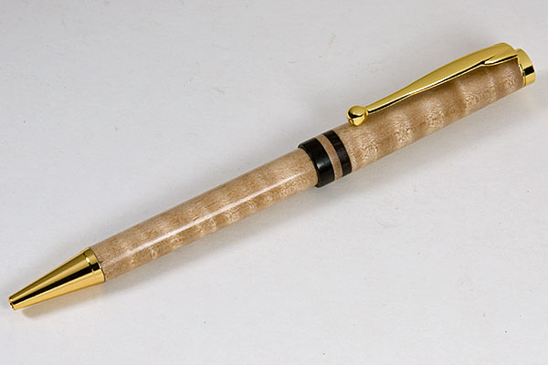

Ok, here's mine. I had a little free time this afternoon and this is what I whipped up. Curly maple and african blackwood. Except for the (already cut) blanks, no saws were used.
Regards,
Eric

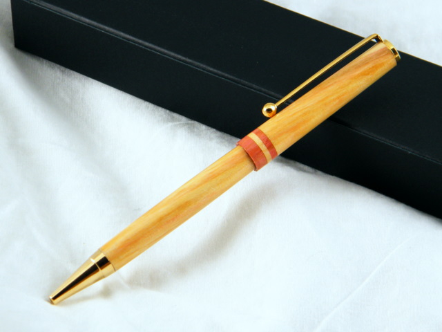

After seeing all of the FANTASTIC pens posted so far, I'm a little reluctant to post mine as well, but here it is anyway. I'm mostly pleased with it, I'll probably take it back out to the shop this weekend and fine-tune it a bit.
Box elder with a pink ivory centerband. Like some others, in the spirit of the challenge, I made this entirely on the lathe. It does have a CA finish, though it didn't show up in the photos. I was hoping for more streaking in the box elder, but such is life.:rolleyes:

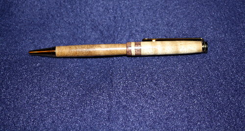

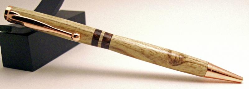

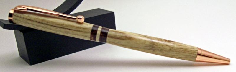

Here's mine. It's Oregon Myrtle and Bolivian Rosewood. I made it from some cutoffs I had and the lower barrel is cut on a diagonal, which is why it is darker:frown:. I parted off the Bol. Rosewood at 4mm. The Oregon Myrtle in the centerband is 2mm.

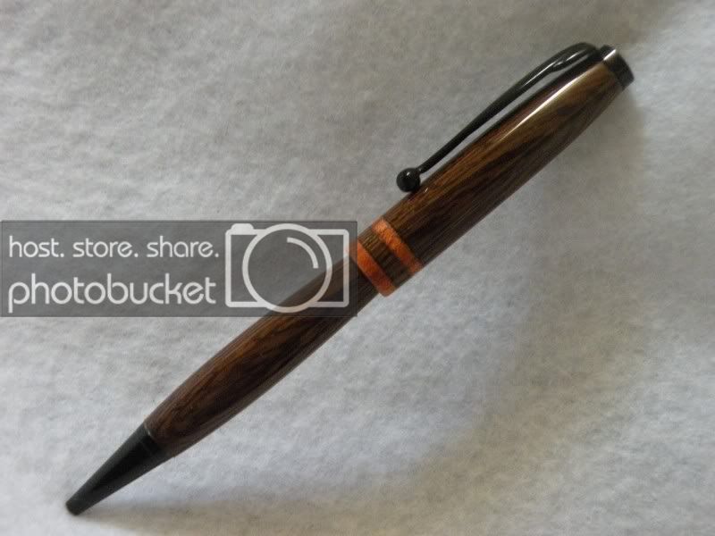

Here's My Effort
This is the first time I've modified a kit design, so be gentle. I had no maple, so I went with Wenge and Paduak. I also decided to add some more curve to mine, especially on the bottom. The CB overlaps about midway through the center ring. You can not tell it from the photo, (because all of my photos suck), but I also kicked the design up 1/10 of a notch by beading the rings. They flattened out a bit on top as I was sanding and I didn't catch it until just now, but dems da breaks. This is also the best CA finish I've ever applied. I finally got a really high gloss, so I am happy on many levels.
Chris
It looks great Chris . Nice color combo between the body , CB and furniture . The shape is good , it adds interest without becoming a bulge or worse , pregnant . The overhang at the CB sounds a little too much , to keep strength at the segments you should always have the tube supporting them . Just a slight recess is enough to cover the gap between the barrels . That is in no way intended as a criticism of the pen , just a suggestion for a strong joint .
Fantastic first modification .

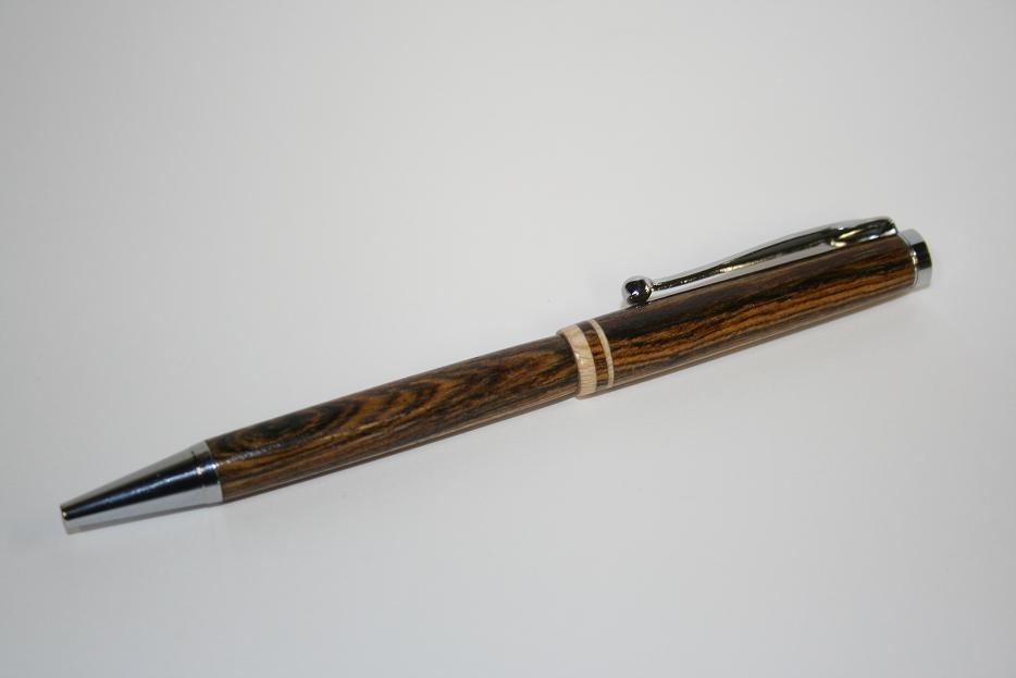

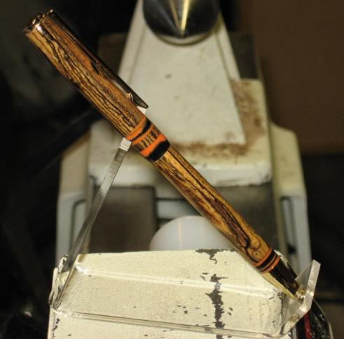

Here is the first pen I've ever done that wasn't "by the book."
Satinwood with katalox... All done on the lathe except the initial drilling(lazy) and cutting the initial blank in two for tubes(also lazy).
What do you think?
I think it's great . Your fit and finish look great , your photo skills need some help though :biggrin::biggrin::biggrin: . Actually the photo's not bad just your cropping .

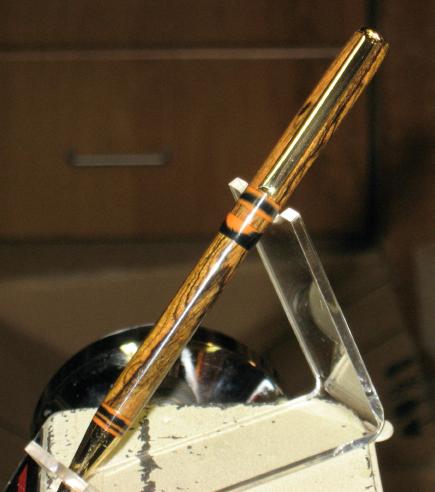

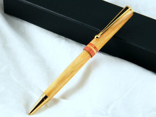

Here's what I came up with,it's made from bocote and cypress.This wasn't the most challenging pen for me but I did do things different,it was all done on the lathe with no saws or bushings.Thanks Bruce for doing this and making people think about how and what they are doing.
That looks fantastic . I like the segments , nice and thin . Nice color contrast on the woods and a good fit and finish .

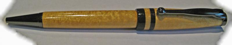

Here's my submission. Huon pine burl with African blackwood accents.
I cut the segments on the table saw and preglued them. When drilling the upper barrel, I widened the hole a bit so that there is a little overlap between the barrels.

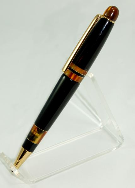

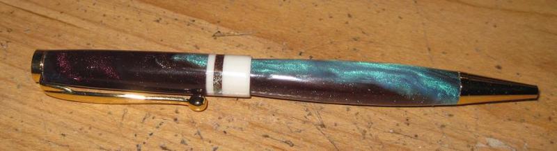

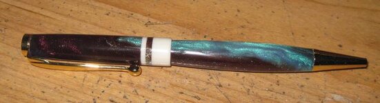

Here is my challenge pen- Mont Verdi
It is homebrew "precious resin" PR, with Exotic Faux Tortise, segmented with brass. I shortened the top of the pen and lengthed the bottom barrel to give it a better balance. The bottom barrel is beveled where it meets the center band to give it a little "shape" I may change this. The top barrel is beveled at the clip ring to accent the ring and a tortise top "dodad" was added as a "why not"
No saws (unless Ed cut the Tortise rod with one), drill presses, pen mills, squares, hammers or REAL turtles were used to produce this pen.

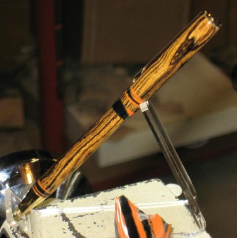

My Version Of Challenge#1

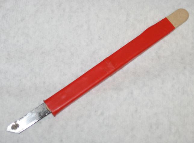

Started of my day with the intent of making an Imperial Tiger. After making inserts for my barrel trimmer I proceeded to drill the blanks and Ka Blewie - pieces all over the place. So I gathered up the usable pieces, rounded what I believe is a piece of Zebra wood and completed a pen for the challenge. I didn't use a saw but did use a repurposed saw blade. Its my thin mini parting tool. 5 minutes to make and works like a charm. Made a double ring centerband and added a ring to the nib end (on purpose, not a fixer ring). All trimming, drilling and even glue up was completed on the lathe.

Great job Andy . I was wondering if someone was going to add the brass or aluminum segments to the mix . I almost did but held back because I didn't want anyone thinking it was a requirement .
Very nice pen Vic . I'm sorry that you blew up the tiger but at least you put some of the pieces to good use . I used the same type of parting tool you do except I turned a handle out of a beechwood pen blank and I used a hacksaw blade with the teeth ground off . I like it because it has such a thin kerf , I'm able to keep the grain match on even the wildest woods and acrylics .
I use an old butter knife ground into a stubby parting tool. It had a handle already and was free! I had no spare saw blades laying around at the time so...
Ron, Or was that the butcher knife you picked up at the Bates Motel garage sale?
Butch, I originally made it for turning the center band and finial for Barons. Even the parting tool from my miniture turning set ate up too much material. One day I'll het aroung to making a nice handle. But for now it ain't broke so why fix it...
