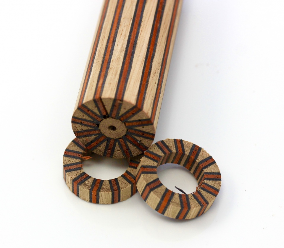

Hi Mike - Thank you for the comments.

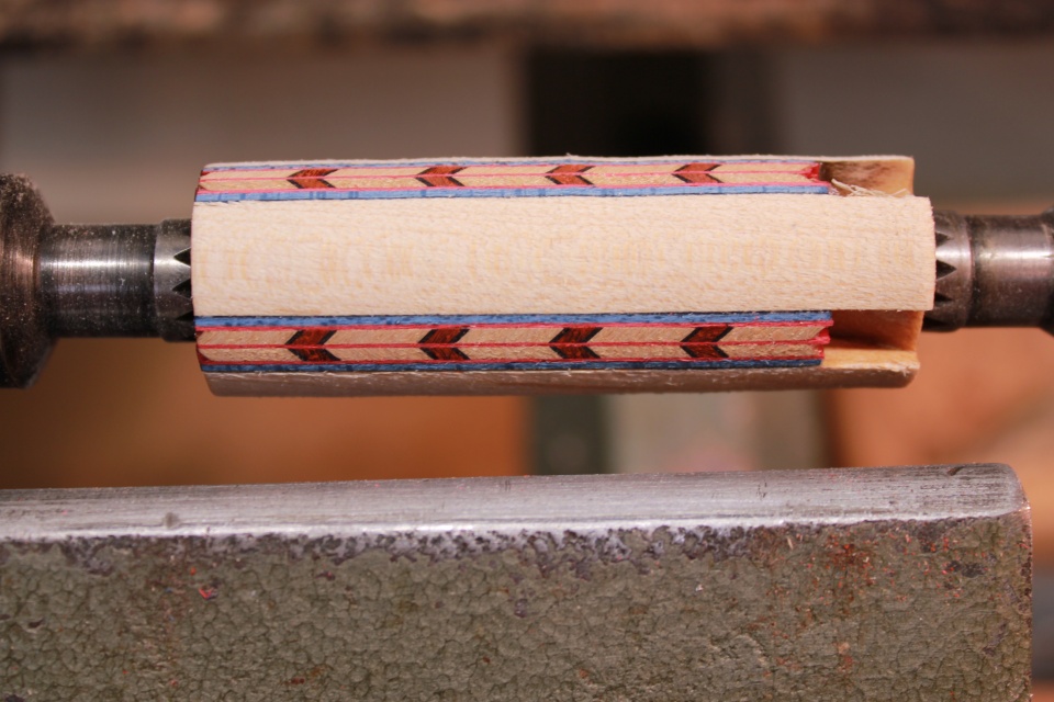

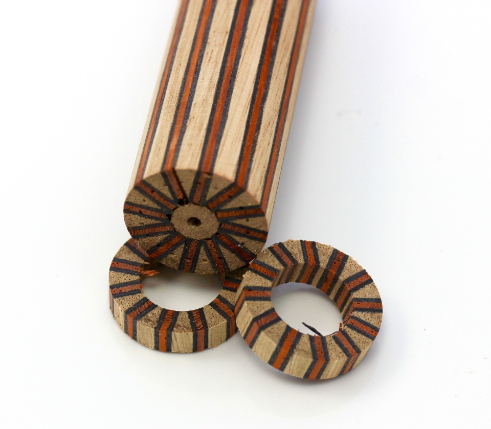

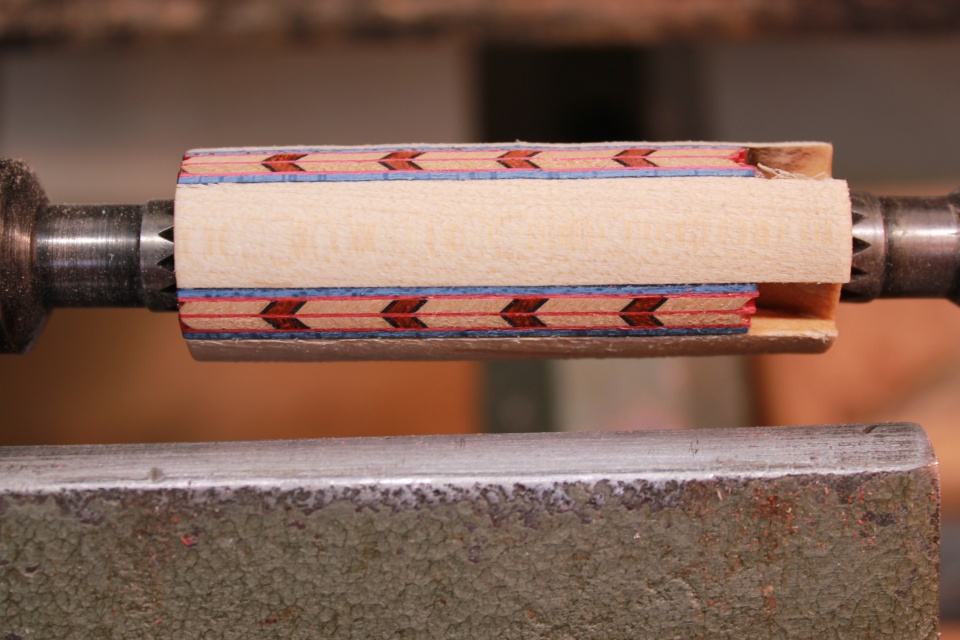

I make my inlays to be 1/2" - 1" deep. So the inlay will extend from inside the tube hole, to the outer diameter. (I can buy many beautiful inlays, but they are only 1/28" - 1/32" thick, so simply gluing them to a tube doesn't work when your final "shoulder" (OD - Bushing dimensions) is so thin. I copied this design, reverse engineered it into a 1" deep inlay).
I use Titebond Translucent to glue-up my inlays. I occasionally use CA during turning if it looks like things may splatter. For turning, I usually use a 1" roughing gouge on the side like a scraper, or my Magical skew (thats a trade name). I apply Mylands sanding sealer, then sand the final .01" to size.
Oh, it helps to get lucky!
I'll look to see if any pictures are helpful.

Beautiful work Mark, I really like the new variant of the chevron, lots of possibilities.
You need to try these Mark. Just change the size of the main segments, offset the colors, and you're good to go! I just started using different colored thicker veneers, and really like them.
Mark, Mike (Moke),
Eagle, from long ago, taught me something on delicate segmented blanks. He actually posted it here somewhere but I think most people tended to under use the information while I tended to over do what he said.
He started off wrapping with thread and CA'ing it. (Gauze works just as well). Then he turned about 1/3 to 1/2 of the length of the blank down about 1/16 inch. Then CAed the fresh turn. then turn the other half; CA again, turn down another 1/16" halfway. CA again, and turn the rest of the way. CA. CA, CA each portion of a turn.
The point is on blanks like this, similar to snakewood, taking a few hours or even days on a delicate blank is worth it. I always worked on other items to break the monotony while waiting on Snakewood, and learned to back off on delicate segments at times when I wanted to "get it done". A none-rushed delicate artistic blank carefully crafted will bring in a few hundred more than an ordinary segment. And Boost your ego to boot! The extra time spent on a delicate blank is worth it. With the experience, one learns when a particular part of the process can be speeded up and which parts to take it easy.
I have never been a very patient person but this more than anything else helped me learn patience, and Eagle started me down this road!

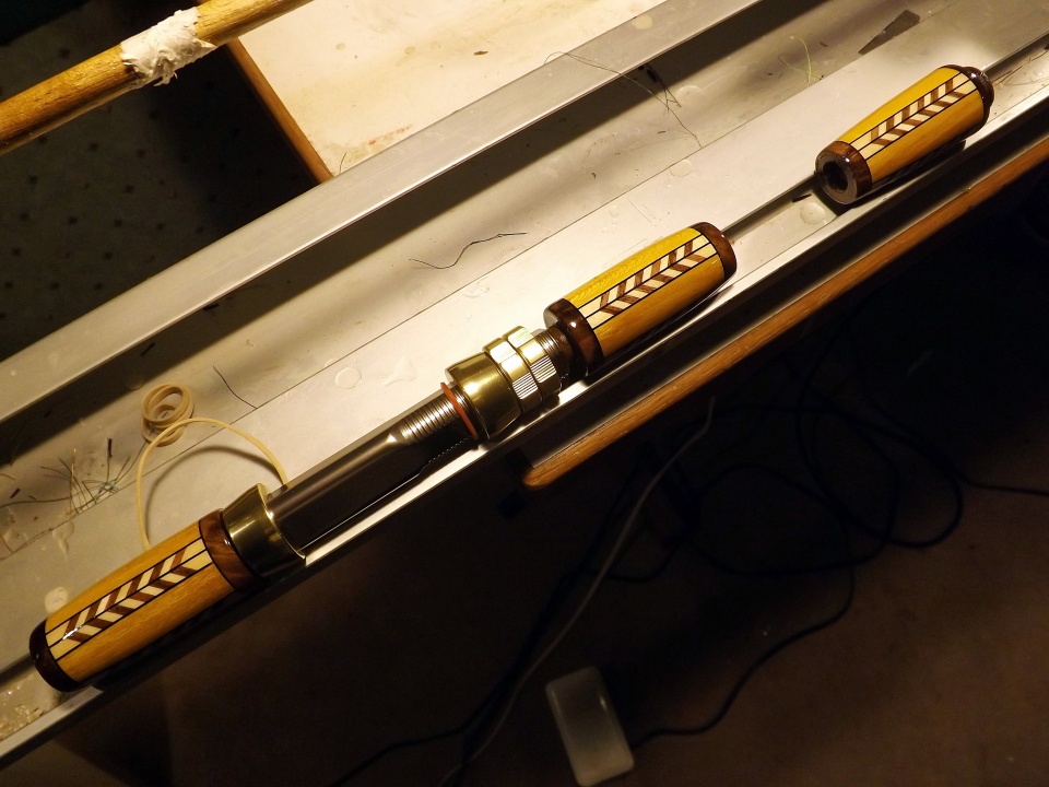

I'll give it a go, just playing with a little larger version for a fishing rod. I like the pattern, it has a lot of uses and you can build a bunch of pieces at one time.
Looks like very tight alignment! Nice, Mark. I found some pictures of your rods - really cool. The artistry displayed in rod building and billiard cues is amazing. A lot of overlap. Nice inspiration. Keep at it!
