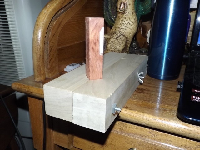

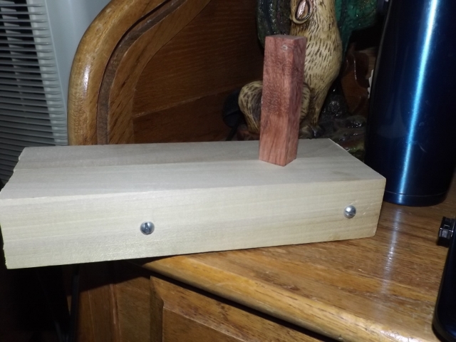

I saw an idea some where but forgot as to where I saw it and looked all over the internet and could not find the pen jig that I saw. So I set out to make my own. I'm not done with this one as yet because I want to put another space on the jig for the other half of the pen when the wood is cut in to the two parts. This is going to be great so it will be steady when I get ready to drill the hole in the center of the halves of the blank. I put a blank in it to show how it will work. It is in nice and snug and you clamp it to the drill press and when you are done drilling, just loosen the screws and your done. Just go ahead and insert the tubes and continue with the pen making. I haven't tried it yet so will do that tomorrow.

It does look like the one that Cap'n Eddie uses in some of his videos. You may also want to consider using longer bolts, for when you get a larger blank or one that's not completely square. It should work out really well for you.

It works very well. I went ot make the second square hole for the other half of the blank and then drilled the holes and it works great! .. I will make a couple more once I get the blanks for larger pens, fatter ones. I know they are making pens in different sizes and shapes. This jig is for the slim line pens... Good night Fay

Thanks Harry, I appreciate knowing that. That's why I made just this one to try it out and some one on another forum asked me if it would work for round blanks and I didn't even think of round blanks at all. I think it might work if the blank will fit nice and snug. Good night Fay

Fay; Take the two pieces of your blank vice and run them through the table saw, or whatever you have, and take off 1/4" of the inside off of both pieces. Now you will have a clamp that will hold different size squares, odd shaped pieces, as well as round stock. Jim S
