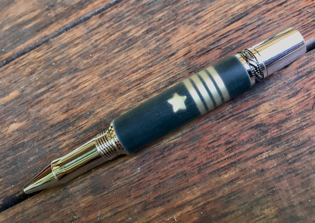

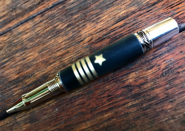

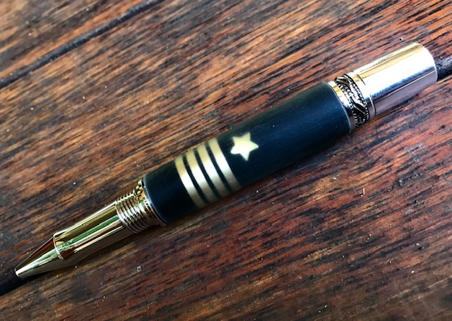

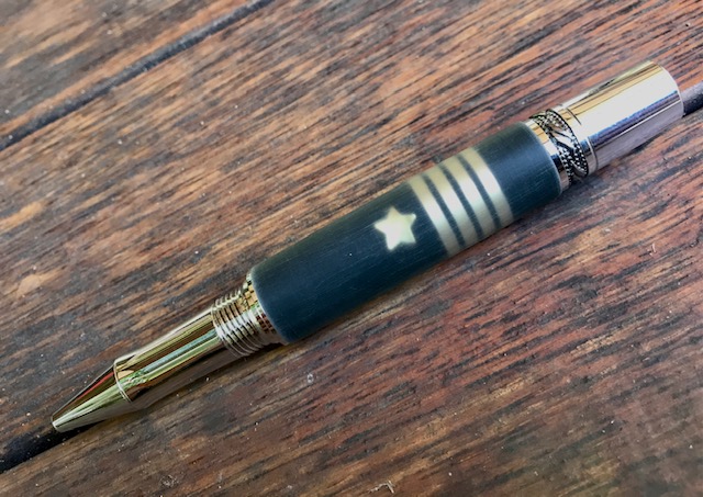

Been a while in the planning stage, but am starting to make a bit of progress.
It still is about 1mm oversized and not sanded and polished yet.
I was intending to orientate the blank as in the first photo,
but am wondering if it should go the way of the 2nd photo ?
I think the star towards the nib looks right when the pen is capped ,
but I think holding the pen in the writing position, the star towards the finial might look better.
What does the brain-trust think ?
2587FFA8-2DEB-49D8-8FD0-2089631990C3.jpeg 160A3870-E735-4B33-BEEF-B15A8A41BDD0.jpeg

Hey looking good. You struck on an age old question that I have asked many times here and have gotten mixed answers so about 50 /50. How to arrange the nib section with the pen closed or open. My vote is for second photo. If the star is always on top of bars.

Thanks John. Yes it's a bit of a " what came first, the chicken or the egg ?" question.
After asking the same question to my cousin, who has commissioned the pen, we have decided to go with the second photo version.
