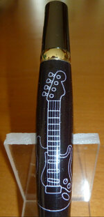

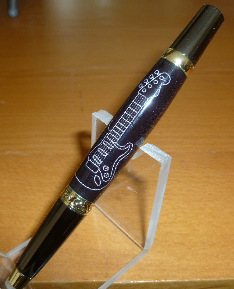

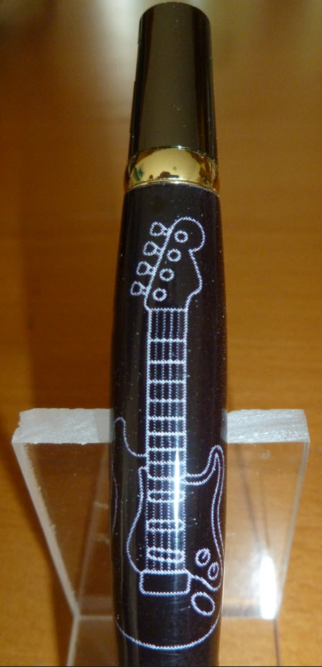

My latest adventure is into making my own "plastic" blanks from casting epoxy. I wanted to make a gift for a good, endlessly generous friend who makes beautiful guitars. He has a level of skill that I envy! Although I have already made some colored blanks, I had not attempted one where the epoxy is clear. I came up with the attached for the gift. It is nothing spectacular, like so much that I have seen on IAP, but I know that he will appreciate the gesture. Please see the attached photos.

Being completely new to this aspect of pen making you will have to excuse my ignorance. The blank was made by printing a waterproof Avery label using a laser printer, and then sticking it around the brass tube. Then it was cast into clear epoxy. Is that what you mean by "cast label"?
Yes
