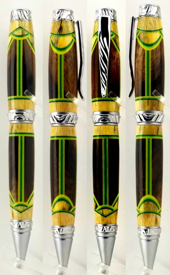

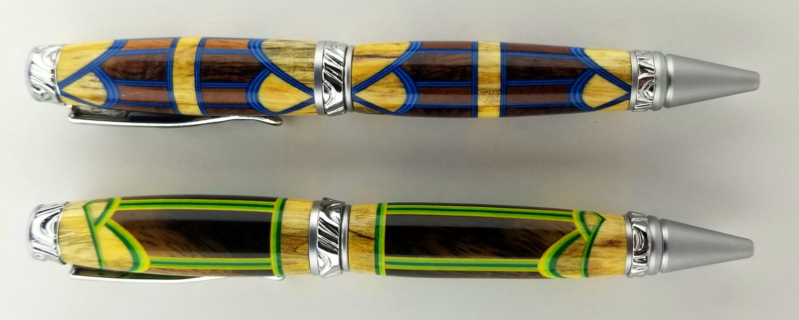

Today for your viewing pleasure we have a couple of Ultra Cigar pens wrapped in some segmented blanks. Enjoy :)
First with the green and yellow card stock separators is a mix of Monkeypod and spalted Jackfruit.

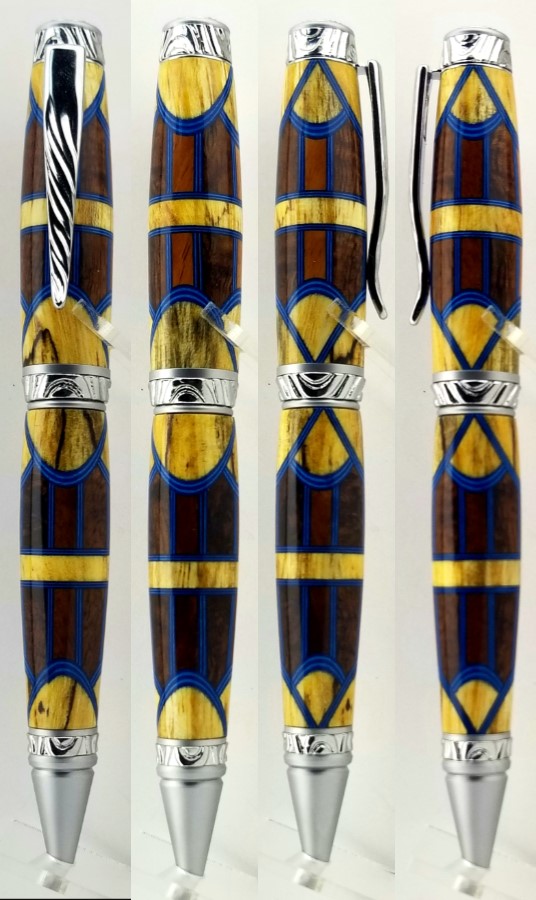

Next with blue card stock separators is a mix of Koa, Lychee, and some more spalted Jackfruit.
As always question, comments and critiques are welcome and encouraged.

For the green one, the basic segmentation pattern seems to repeat 4 times, going around the pen, and for the blue one, 8 times. . Am I correct ?
Yes Mal there are 4 strips of card stock on the green one and 8 on the blue one. The blue one is Koa, card stock, Lychee, card stock, and then repeat
These turned out real well. The colors do pop. There is alot of different types of segmenting involved there and all looks spot on. Job well done and thanks for showing.
Those are awesome! I must be different because I like the green/yellow best. The colors of the stock with the wood is more appealing to my eye and with less segments it's not quite as busy. You killed it with both of them.
