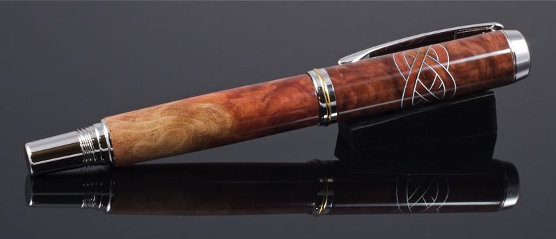

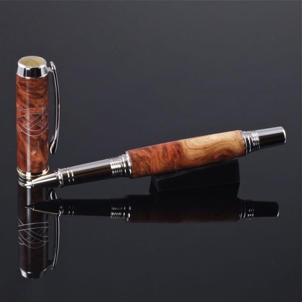

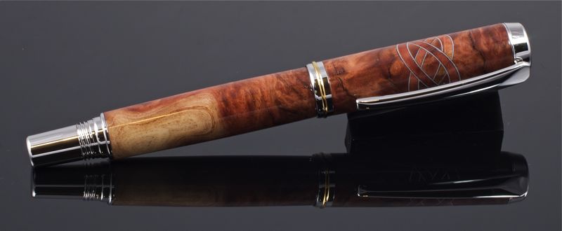

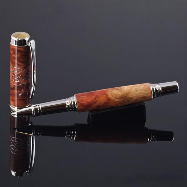

These were made for a gentleman in Singapore who is giving them to some friends as wedding gifts. They are two-tone Red Mallee Burl with aluminum flashing from local home improvement store.
The pens are made from opposite ends of a single extra-long blank. And the knots represent the "tying of the knot". They are the Rhodium Jr Gentleman's kit with a CA finish left at 6000 micromesh for a "soft gloss", to better show off the wood and inlay.

Beautiful! Would you mind sharing the size of the kerf that you used to make the cuts? What angle did you use? Good work!

Outfitter, I used a Freud "ICE" thin-kerf table saw blade. Somehow it started wobbling a bit after my first couple of uses so it now gives a kerf of .104 inches. The kerfs are cut at 37.5 degrees. I can hear you now... "How the heck did he come up with THAT angle?". I started with 45 degrees and thought that was too steep and made the curves too thick compared to the sides; then I tried 30 degrees and it was too "squooshed" together; so I "split the difference". I use a sled and then have blocks cut at the angle I want and I make sure that the block is on both sides of the blade so my pieces are backed on both sides of the cut. 3/4" plywood.
