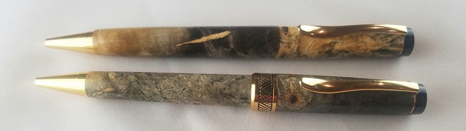

A one piece Perfect Fit and
See more from its_virgil
its_virgil
Jan 1, 2004
8,126
Wichita Falls, TX, USA.
one made as designed. The Perfect Fit is my favorite ballpoint and buckeye burl is in my top 5 woods to use.
Do a good turn daily!
Don

The lower tube, which does not glue in but must move freely inside the barrel, calls for a Letter O bit. I used an 8.2mm for a little extra room.
Did you use a 11/32 brass tube the full length of the pen, inside of which the lower tube turns ?
I have some 11/32 brass tube that I bought at a hobby shop. . It might be a couple of thou smaller than the upper kit tube. The lower tube does fit fine inside of it.
Lower end sizing of wood might be a little tricky when turning as there is not much thickness left when matching outer diameter to nib

I wanted to do that but could not find a tube that would work. I will get tubing for the next eon.
Drilling for the lower tube with the 8.2mm bit helped.
