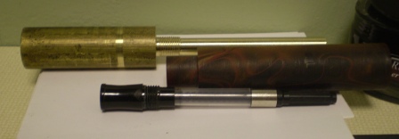

rstought,
let me clarify terms before i give you my .02
section: is part of pen that holds housing (pic 1 w/ converter attached)
housing/holder: is part of section that holds feed and nib (pic 2)
option 1:
doesn't make sense to tap pen body for housing/holder, or glue holder. the tap you bought is to, eliminate the glue, and to screw holder into custom made section.
you tap the section. unless your section is an intregal part of the pen. if it is, then refilling is a mess due to the handling of the feed/nib directly.
option 2:
most logical and typical way it is done.
Lastly, the body is what usually has the threads for the cap, so you don't unscrew section when unscrewing the cap.
Now this is how i envision my process. There are an infinite # of variations, each with their pro's and con's.
