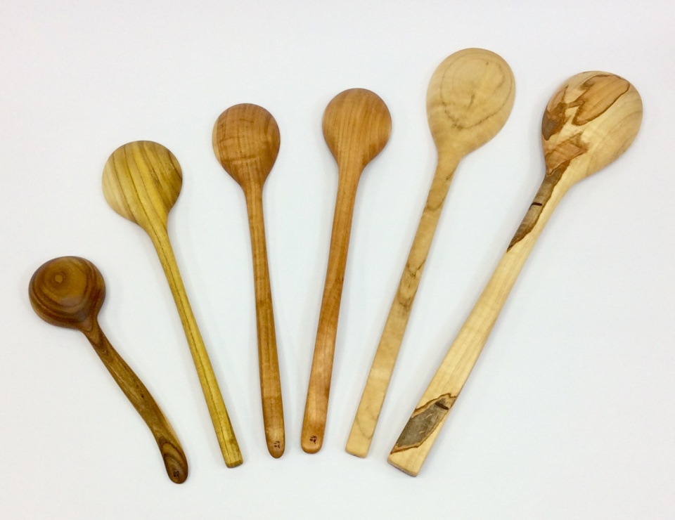

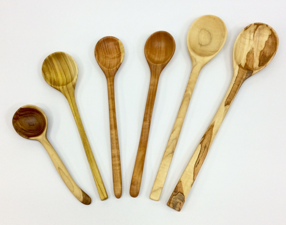

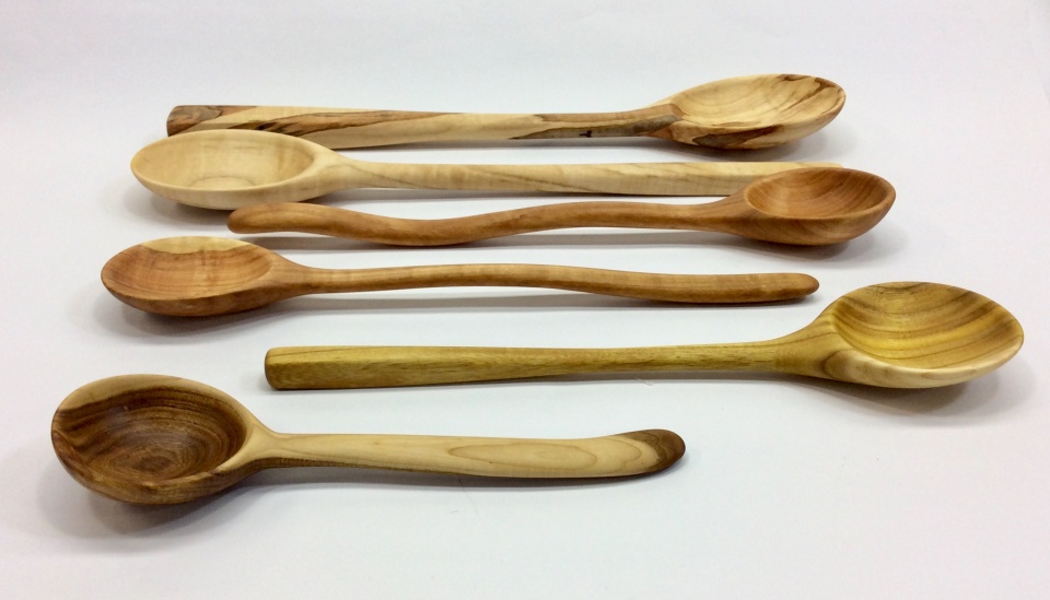

Here is my latest litter which I carved off and on for the last several months.
Mineral Oil/Beeswax finish buffed with a clean wheel.
Lengths: 8 1/4" - 14 5/8"
Left to right: Redbud, Mulberry, Cherry, Cherry, Maple, Ambrosia Maple

Nice, are they all hand carved
I need to get me some of those
Bandsawn to shape, carved to final shape with knife.
The spoon bowl is hogged out with a rotary burr and then finished with a scraper and sandpaper. I use a rotary burr instead of my curved knife because some of the wood I carve is not green and my shoulders don't hurt as much.:smile:
Sanded to 320, raised the grain under running water, sand with 320, raise the grain a second time, sand to 600.
Two coats Mineral Oil and then one or two coats of Mineral Oil/Beeswax
