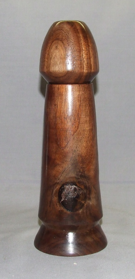

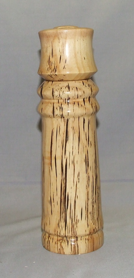

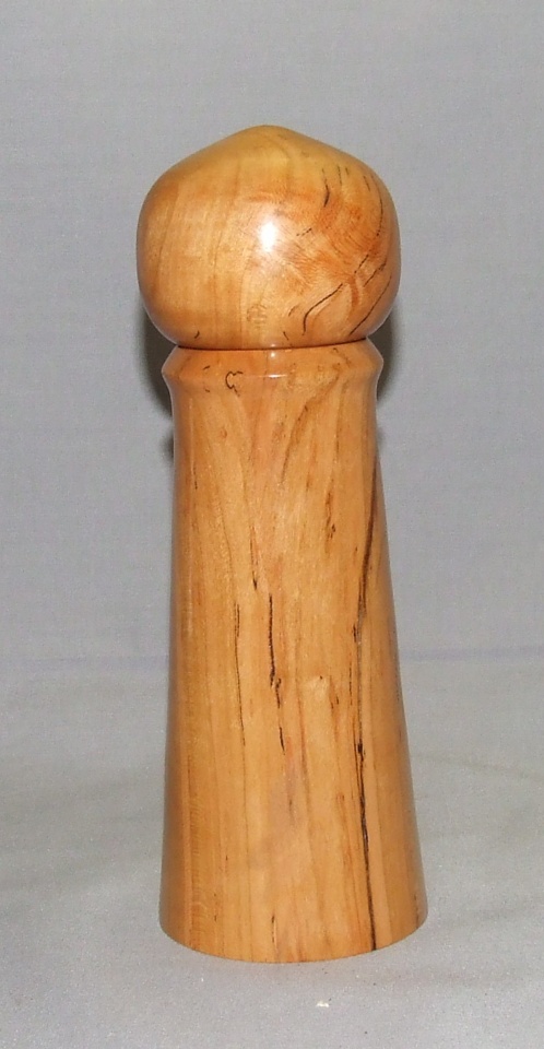

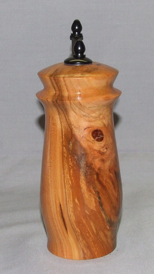

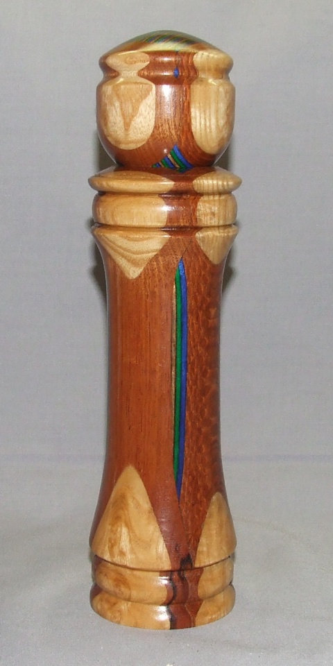

Trying to keep up with my inventory... last three weeks or so have sold a number of the mills and my inventory got a little low... these are the latest.

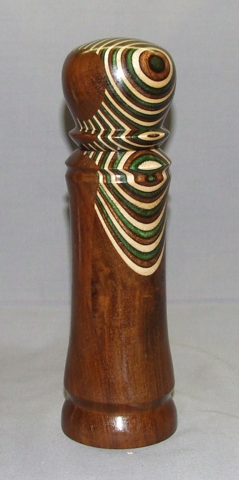

The walnut one I'm a little embarrassed over...:cool: I was going for a rocket ship, but don't think it turned out quite that way... may not be able to offer it in my current market environment. :eek::rolleyes:

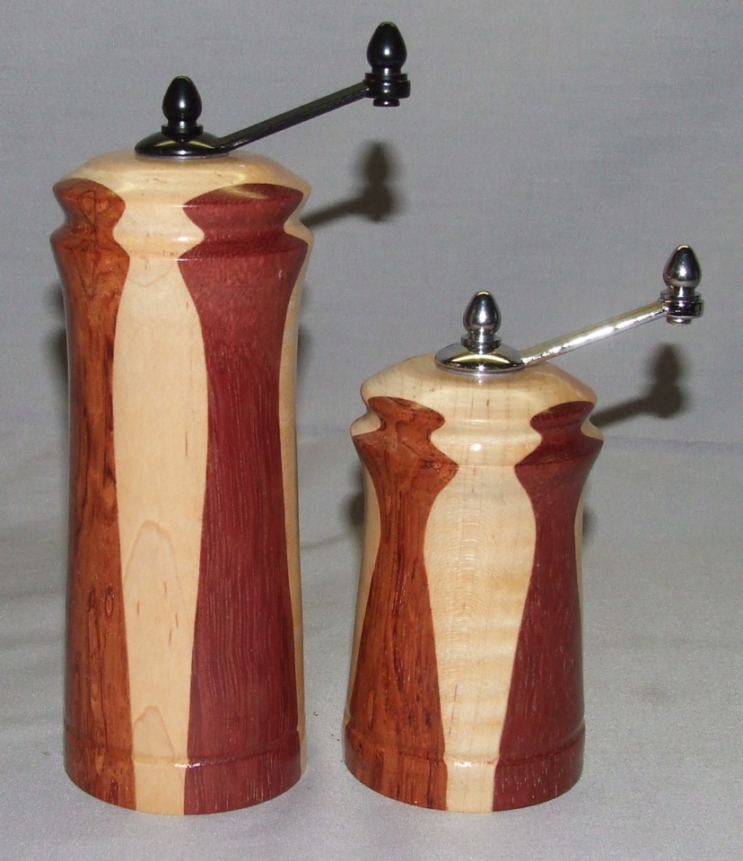

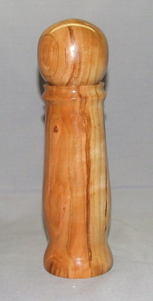

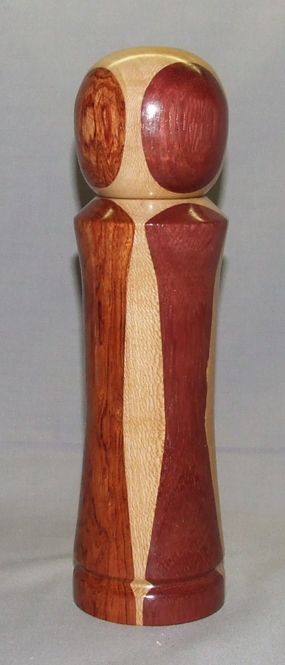

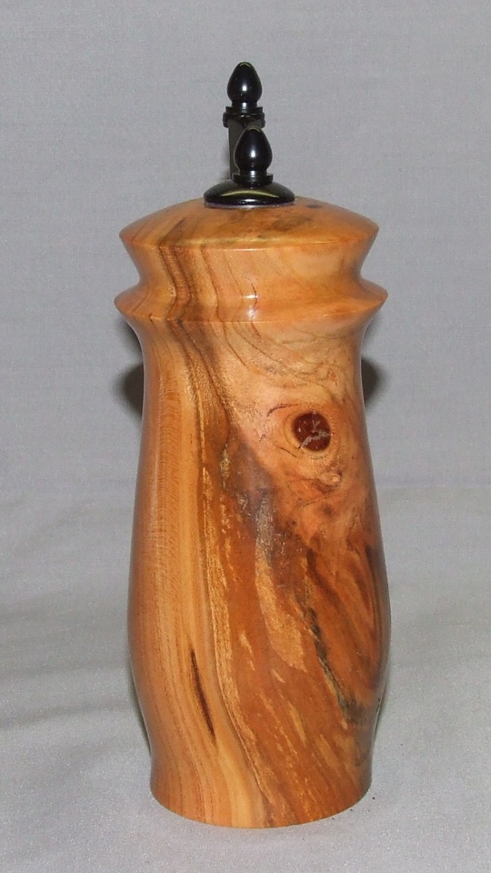

Total of 17 new mills this week.. but gonna skip this weekend at the market as LOML just had a pace maker implanted this past Tuesday and think I should stay home until next week.

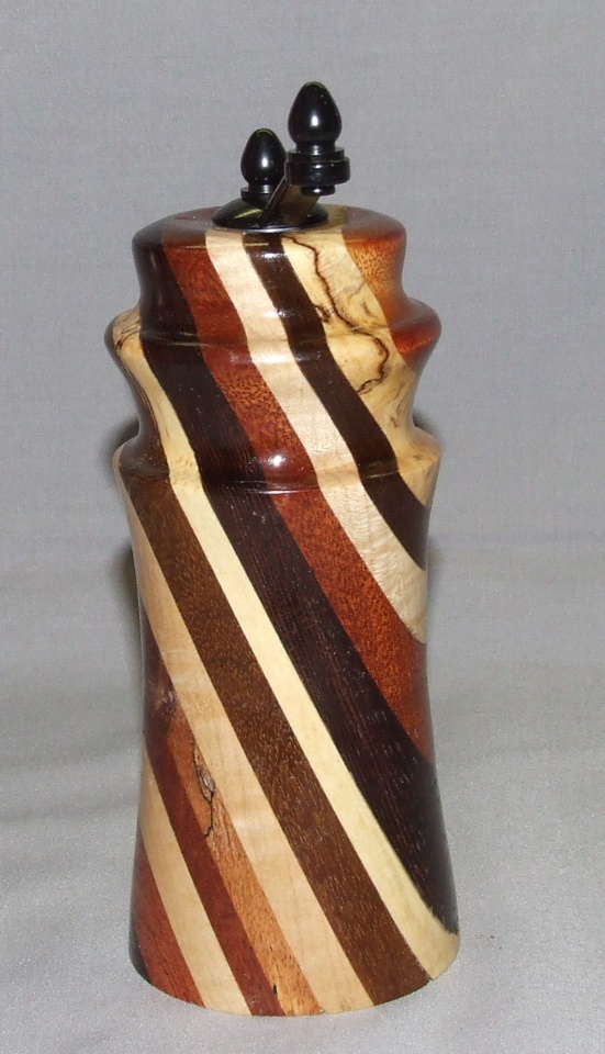

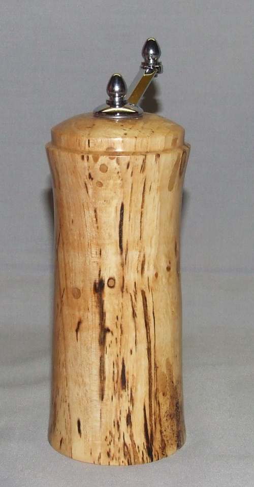

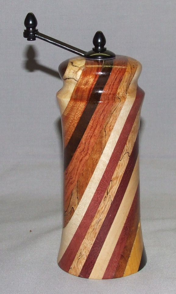

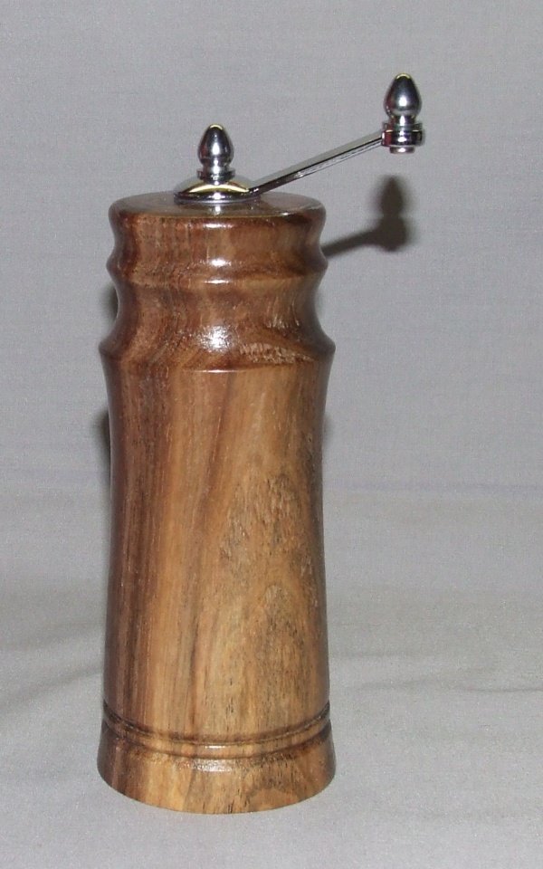

All these mills are finished with Old Master's Sanding sealer, then ran a coating of Yorkshire grit over that to polish a bit before putting on a few coats of wipe on poly. Sizes range from the little 4" & 6" cranks to tallest at 10 1/2 inches... most of the crush grinds are all between 8 inches and 10 1/2 inches tall.

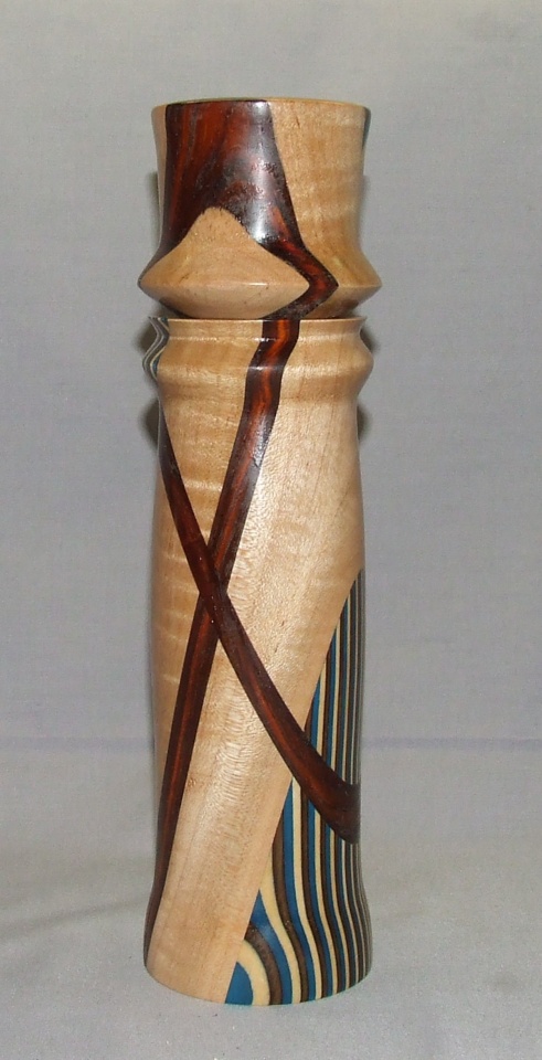

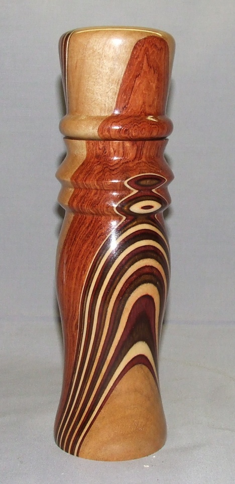

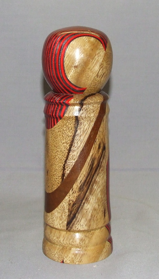

Those look great Chuck. Curious to know about your techniques for embedding the spectra-ply--creates a great effect when it's not the primary wood. Awesome.
earl
Thanks guys for the compliments and Bob thanks for the prayers...
Earl, the process with the Sprectraply is simply using a slice of it like a board and gluing the boards together. I usually glue boards in parallel then figure an angle cut across the corners and then re-glue the triangles back to a square... watch which direction your cut runs so you have the layers of the Spectraply rather than the edges.
