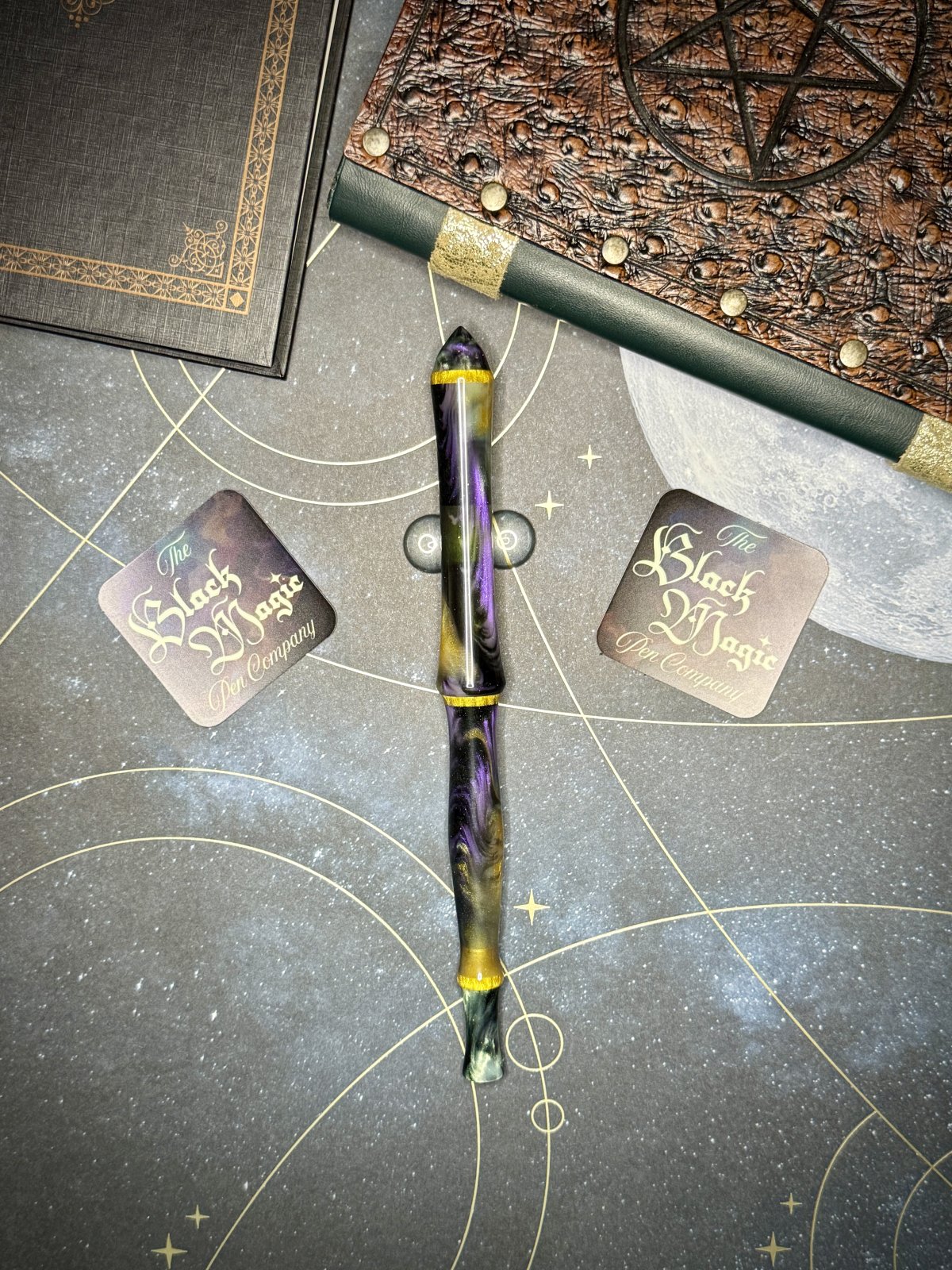

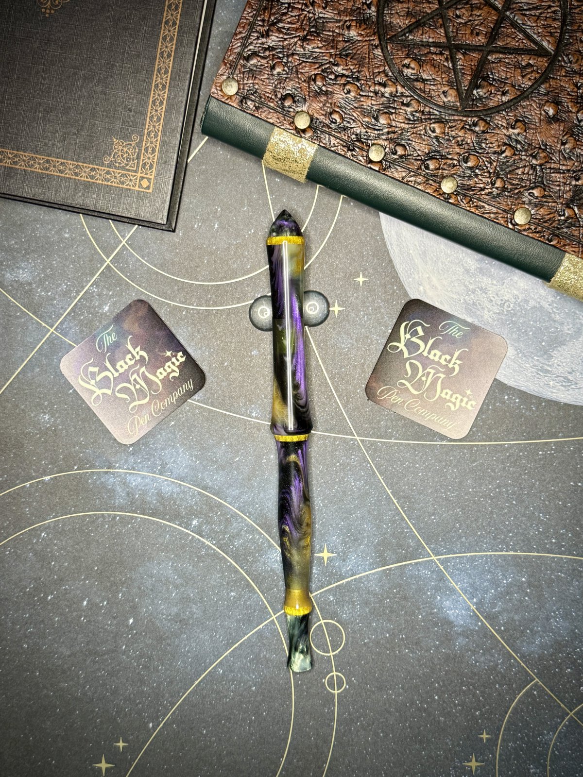

This pen is the first of my new designs and a custom commission for a nice woman I met at the Chicago Pen Show in May.
This one is fitted for a pilot parallel nib however can also be made for a Jowo 6 or a hot swap section for each.

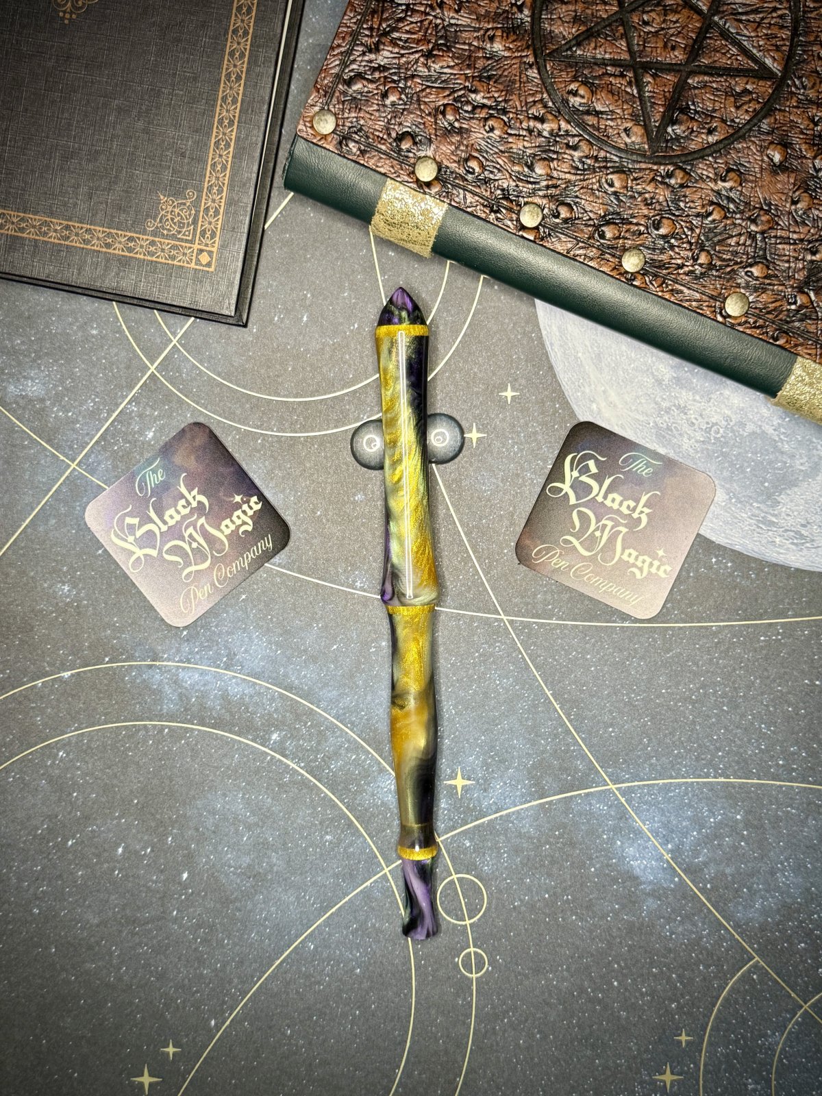

All of the resins were also made by me.

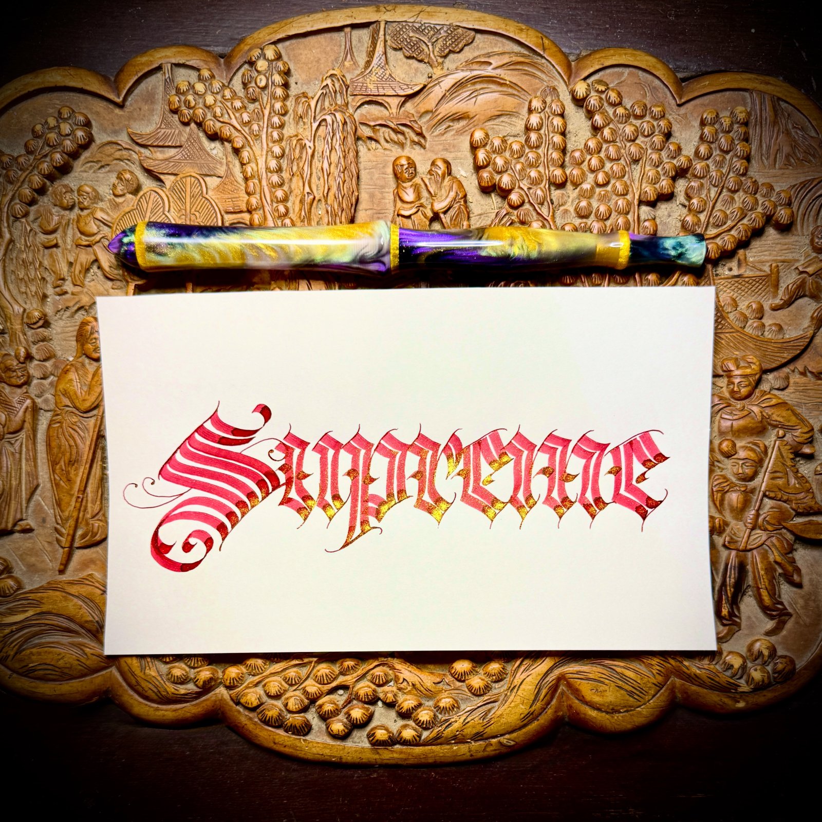

Many more to come! Also some calligraphy for testing (Callivember Day 26 prompt) and a linked video from my Instagram.
Thanks for looking!

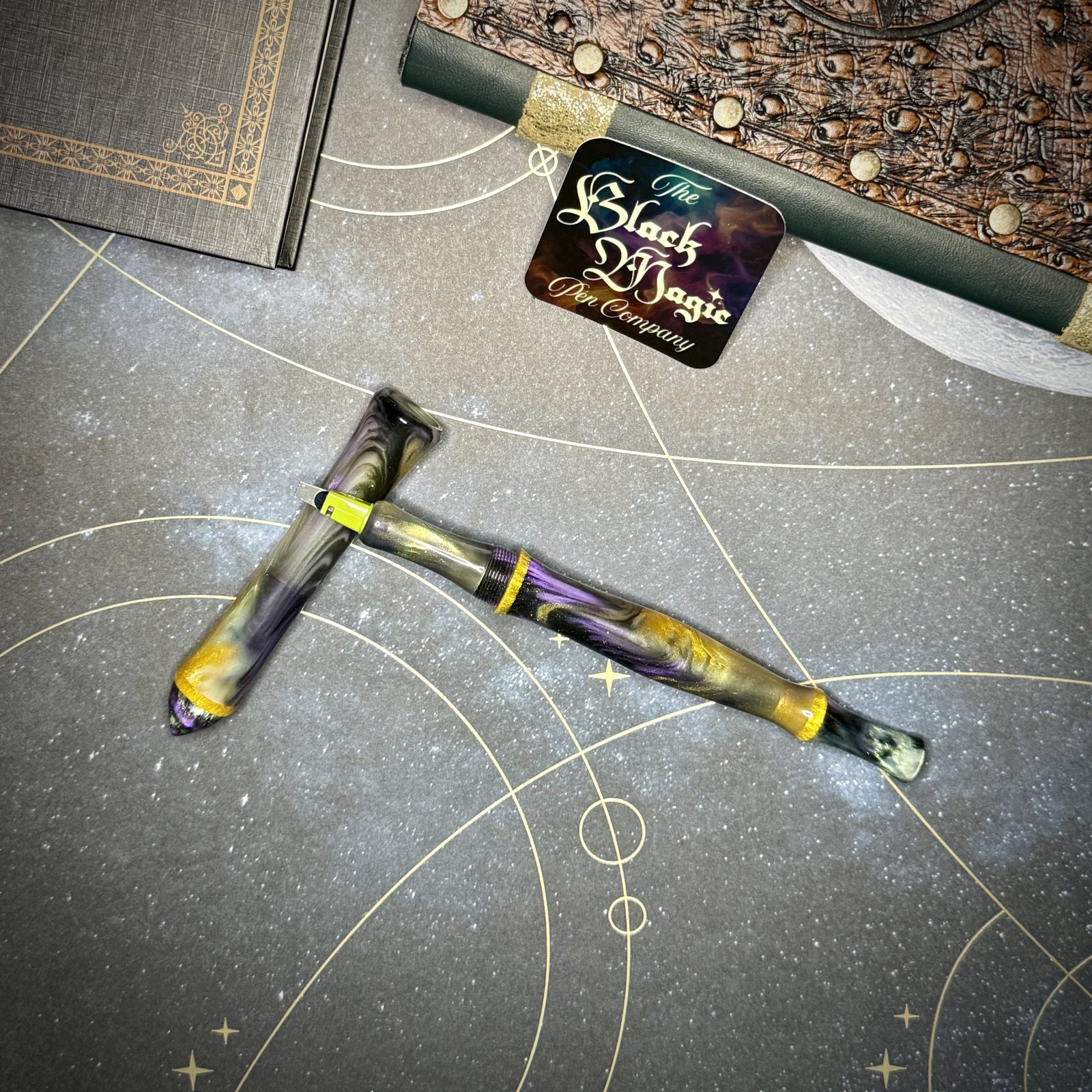

Forgot to add, it has a M14 triple threaded cap, M10x0.75 section and threaded for a K6 or K5 (friction fit) internation converter but will mainly be used as an eyedropper!
I like the forethought of design. Just in case she actually uses it to cast a spell the the ink will remain in the body and not migrate to the cap.
