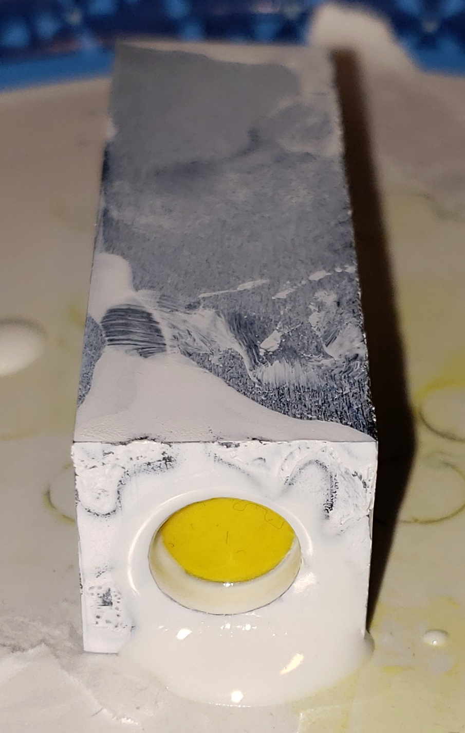

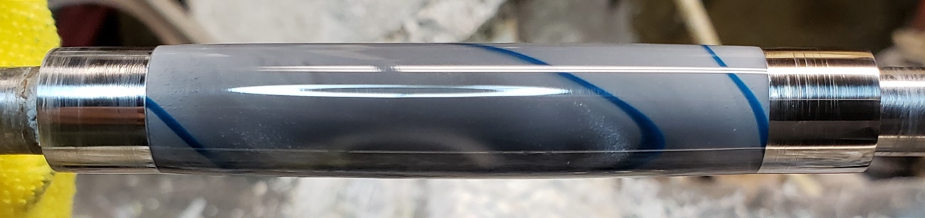

This blank is called Stormy River and is from Bear Tooth Woods. I'm a little underwhelmed by it, I was expecting more figure. I painted the tube, backpainted the blank, and colored the epoxy with white.

After 25 years of purchasing manufactured blanks, I can tell you there is no control over the amount of pattern you will receive. The best strategy I found was to purchase several of each pattern. The "so-so" blanks made inexpensive pens, coupled with inexpensive hardware. The fabulous blanks could be put on nicer hardware and sold for a premium. Of course, since then the price of blanks has dropped significantly--I think the quality is about the same. "Ribbon" blanks will show the most inconsistency.

Ed's right(he usually is). Blanks are like Forrest Gump's box of chocolate, you never know what you'll get. In my opinion, and yes it's worth what you paid for it, that blank needed a different color paint. Whenever I'm in doubt about a blank I'll drill and without gluing the tube in turn it almost to size. Using a dowel close to the size of the hole and outshine several colors in it. Ed has a YouTube video on this. Slide it through choosing the color that looks best. Paint, paint and glue. Finish up the pen.
Good luck.

I think it looks great. Expectations can be a let down. However can be good surprise also. What is it going on? Or in-between?

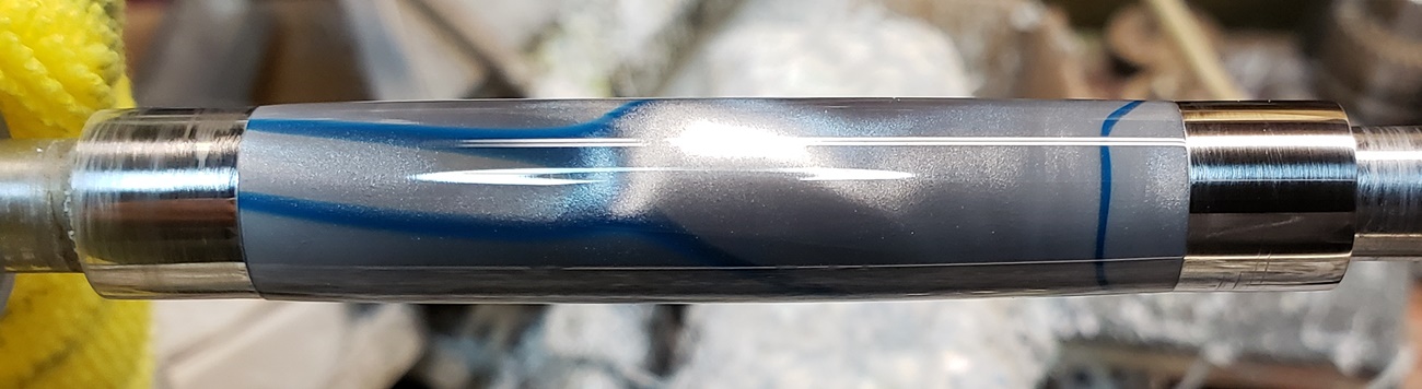

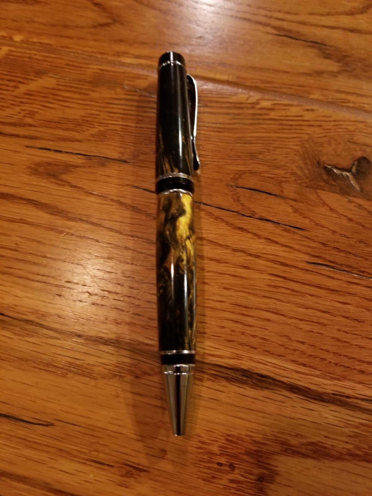

I'm jumping in here late and I'm a new guy, but my blank frustration for both wood and acrylics is how often the promising grain or pattern on the outside of the blank all disappears on the shop floor leaving a much plainer interior. Just tonight a pretty black and gold blank turned into a pretty much black blank, at least on the top half.

Yep, it happens. But still, that pen looks pretty good to me.
@duderubble
That pen is not bad at all !! . I quite like it, in fact. . Yes, there could be a bit more sizzle to the top, but ... yeah ... not bad as it is !!
Do you mind telling us the type of blank it is, and the name of the blank, please.

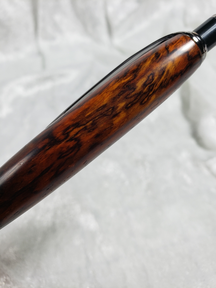

Sometimes it works the other way around. I discovered this cocobolo was pretty punky on one side, but with some CA stabilization the spalting came out gorgeous. Obviously, that's not acrylic, but goes to show there are some good surprises, too!

Certainly. It's the Gold domes Sports Resin Blank. Turned nicely. Cylindrical stock.
