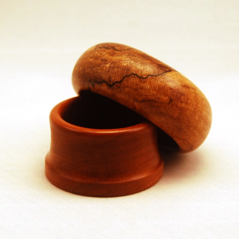

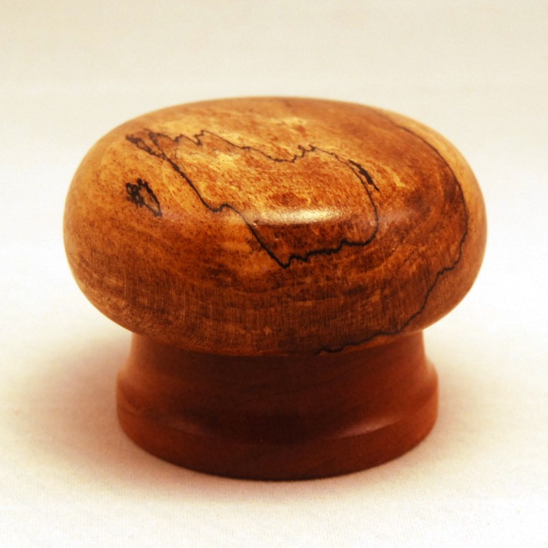

This is a pill box I turned for my wife's mother. She sets up her pills for the day on the kitchen table, so I made her something a little nicer than the plastic box she's been using,
This box measures 1.75" across the base of the bottom and 1.75" high. The bottom is cherry; top is spalted maple.
I knew the spalted maple was a little soft on the corner I cut off to make this top, so I took it easy as I started turning into it. Sure enough, it got a little more pithy the more I turned. I grabbed my bottle of thin CA and started dousing it until it had soaked up a fair amount. When I started turning again, it felt much more solid, so I had no problem completing it.
A couple of coats of tung oil (real stuff) gave it a nice appearance. After letting that cure a couple of days, I hit it with several coats of rattle can lacquer.
'Shrooms, anyone?

I'm curious as to how you had this on a lathe.
For the bottom, I started with a longer piece of cherry than I needed. I hollowed out the inside and shaped the outside down as far as I needed, then parted it off the remainder. To clean up the bottom, I wrapped the top part with some rubber padding, put it in the chuck and finished the bottom of the base.
I turned the inside of the top first, then shaped the lower part of the outside. Next, I put a piece of pine in the chuck and turned it to act as a jam chuck. When I got a good fit using a small bit of paper towel as a pad, I finished turning the upper portion of the top.
