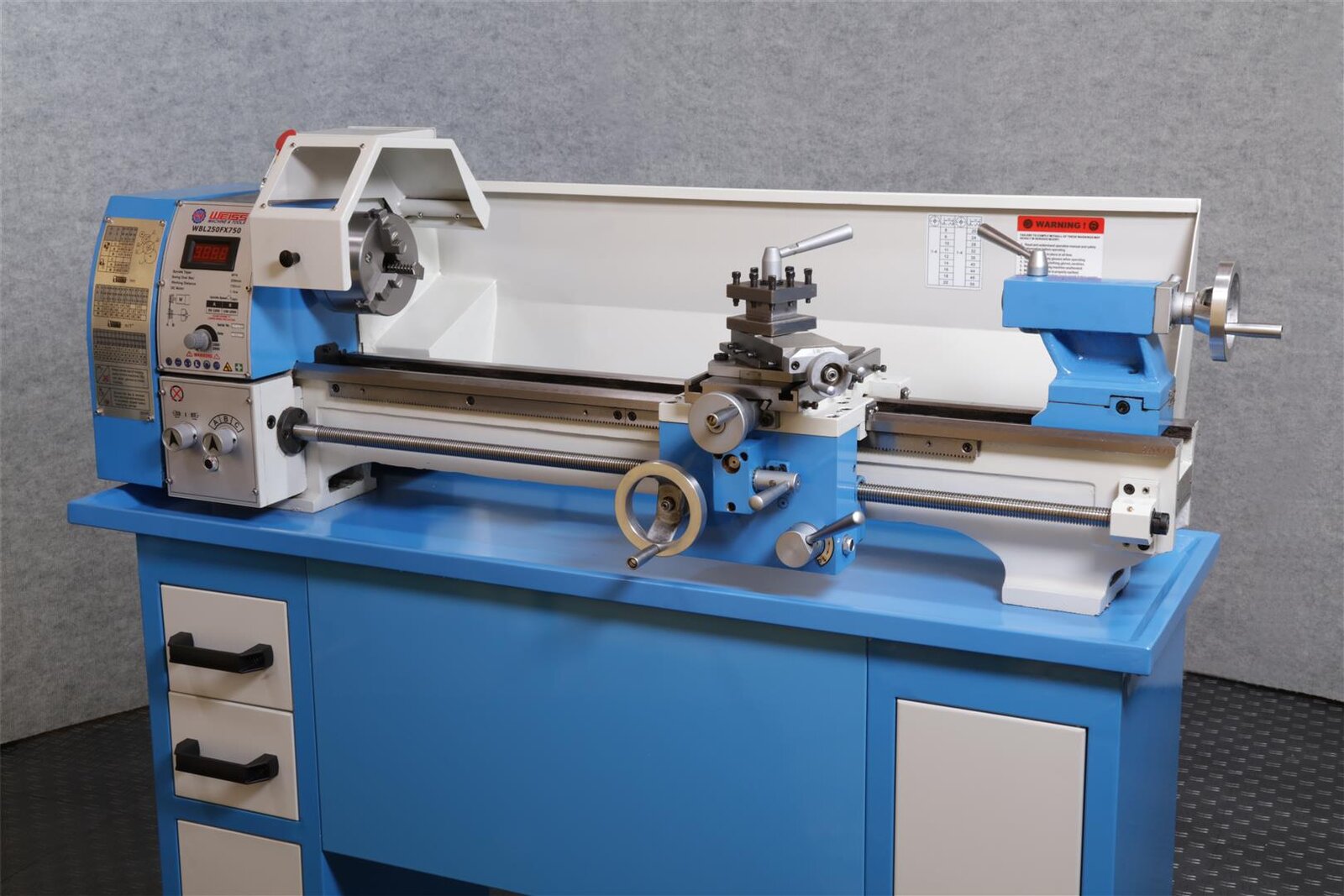

I'm leaning towards adding this to my shop.
Anyone have experience with this machine?
Its a Weiss 10x30. I'm a machinist by trade and a pen maker second so I think it'll be a good fit for what I do.
Any input is greatly appreciated.

Well... it definitely won't be underpowered for any pen related endeavors. Pull the trigger and don't overthink. You will find plenty of use for it.
I heard nothing but good about them !!
I too was and is a machinist by trade
and have a grizzly metal large
Since there are two machinists to get an opinion here. I have a Seig style lathe that I would like to upgrade. Is a Weiss a lot better? From what I've read all the Chinese lathes are very similar. I wouldn't call mine a fine tuned machine, just adequate. Are there any options not made in China? For hobby use pens mostly but I do some other small items. I'm currently looking at Proxxon.

That basic machine is sold under various names by various vendors: Precision Matthews and DRO Pros for sure and probably Grizzly and others. That doesn't mean that they are identical. Take a look here:
This video has received favorable reviews around here.
I have watched that video before. She talked about the base parts all being made in the same factories and that increased price buys more fetuses. I don't recall her talking about the quality differences that may or may not come with those higher prices. Having extra features is nice but if the overall quality isn't improved you still have a so so lathe. (Which I already have)

I have a 10x22 Grizzly and it looks very similar to mine. As Bmachin said I am sure it is made in China/Korea and marketed under various names.
That tail stock and carriage is identical to mine as is the gear exchange. I have had some issues with the tail stock....when I thread with dies on metal it puts pressure on it and sort of locks it up and needs to be disassembled and reassembled as it id "jammed" unless you lock it down with the set screw and lock down. With pen stuff it has performed flawlessly. It really looks like mine, some of the controls are rearranged a little, but even the font is the same.
Mine has a DRO which is basically worthless as it is not accurate (even considering backlash) but I would do it again for sure.
With you being a Machinist maybe you can make suggestions on the tail stock problem.
Oh, I just thought of one complaint, the Tailstock travel is only 2.5". I have a Laguana 18/36 which is 4", but drilling blanks on a metal lathe is far more accurate. Are you going to get the stand? That looks like a nice set up! Keep us informed!!
