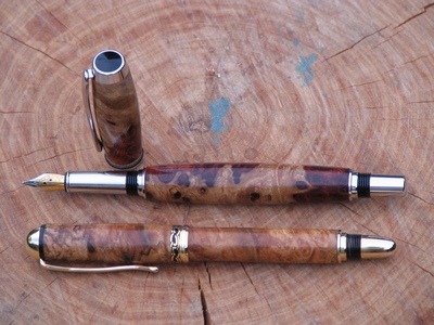

At the Jan local meeting George (I think it was George) mentioned making your FP a little longer than normal to hold a spare cartridge inside. LOML wanted a FP so I took a stab at it. I have not deviated much from basic kits in the past so this is really a stretch for me. This is really too long, I added more length than I needed too. Nope, I did not measure. It was really just to see if I could. I have included a regular length pen for comparison. A more B2B shape on the barrell would probably be an improvement. Thanks for your time.

Mark, Yep, sounds like something I would say. :)
When I make a "closed end" pen, not using the lower metal end piece, I drill the hole 2.75" deep which gives plenty of room for the Schmidt converter and also allows for a spare rubber refill if using a rubber cartridge.
The Jr Gent and Jr Statesmen kits are already long enough to slide a spare inside so you could have just made it normal length.
All that said, I have made a few pens longer and actually like the way they feel in my hand. Nothing says a pen has to be a certain length!
The longer pen looks fine to me and I like that blank, is it the Cochen rosewood John has?

I started making closed end pens because I hated the short stubby writing ends...your way works too

I actually like the look of your longer pens. Or, put another way, I find that "regular" fountain pens look a little bit stubby to my eye.
I have no idea if a longer pen is less of a pleasure to write with, but I do think they look sexier.
Thanks for posting.
Cheers!
Gary
Edit: Did you add extra tube? Split the tube the kit came with?

The wood was Amboyna (John's). I filled it with Private Reserve Spearmint and my wife loves it. ALL THOSE COLORS!!!!!!!!!!
I am afraid I am becoming a FP snob. I swapped out my daily writer RB for a very plain ironwood FP. Is there a cure? I hope not.
