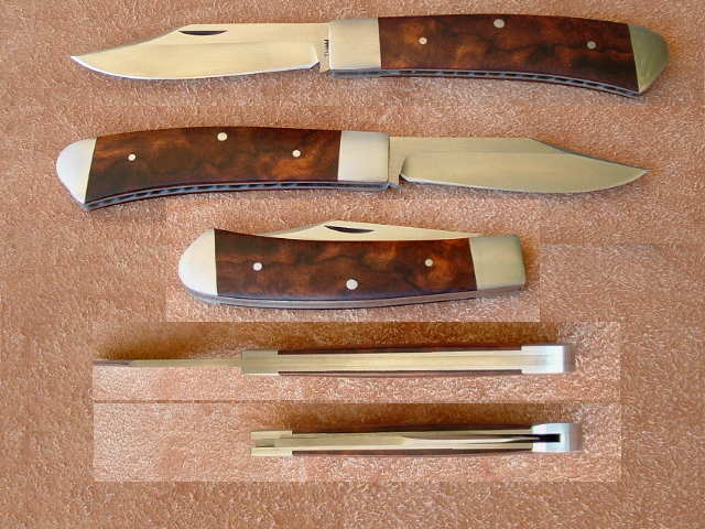

I recently acquired a milling machine and have been having lots of fun playing with it. Decided to try my hand at making a slipjoint knife with integral bolsters. The left and right halfs were milled out of 2 pieces of 416 stainless steel to make the frame. The blade and backspring are made of D2 tool steel. Handles are desert ironwood burl. This worked out pretty good and makes a very slim knife. Thanks for taking a look. -Phil Tham

Ghostrider, the blade and backspring both have to be heat treated...a two step process where the steel is first hardened and then tempered. The spring has to be tempered at a higher temperature than the blade. I have a programmable kiln to do this.
Are you wrapping the D2 in the Stainless heat treat wrap or can you heat treat in a vacuum?

jd99 -Yes, I use the stainless foil wrap for heat treating.
