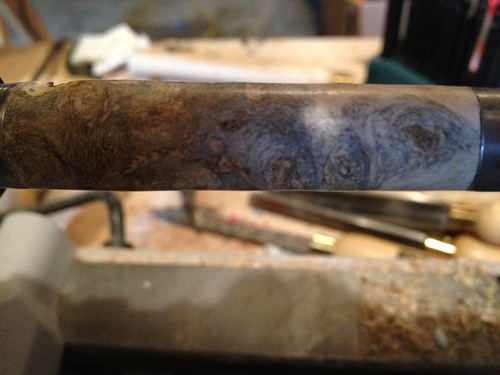

I'm working on a Gentleman fountain pen in Afzelia burl, and the piece of wood I have is beyond gorgeous. The section that I'm using to make the body of the pen has a knot:
It's got some depth, but doesn't go through to the tube. Here, I rotated it a bit so it's upper left to try to show depth.
I know I need to fill this because, well, it's huge. And I kind of like the dark look of it, so I'm hesitant to just fill it with sanding dust and CA, and since I personally prefer Mylands to CA for my own pens, I wasn't planning a CA finish.
Suggestions?

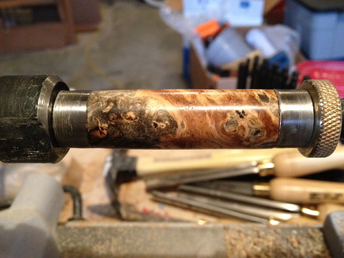

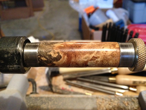

Oh, and here's what the cap will look like (sanded to 500 with a coat of BLO):
sanding dust and wood glue. Make a paste. If you like the black then just use dark sanding dust. All woodworkers use that trick. The key here is you are not staining the fill.
Dryed epoxy...??? please explain...!!!
The grind coffee and epoxy/thick CA would be my choice for that repair however, if you are not finishing it with the CA finish, I would suggest you to use the PVA white glue instead, as the CA and epoxy will leave a extra gloss on that patch that is very noticeable with other finishes...!
Good luck,
Cheers
George

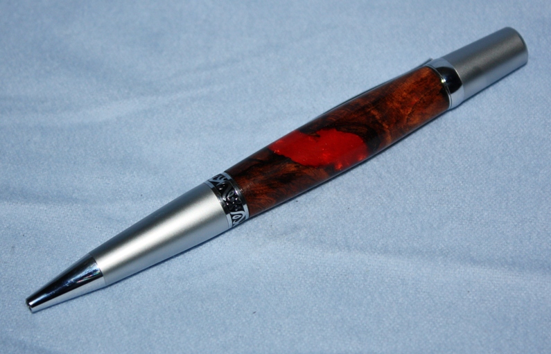

This is a mesquite burl with a large knothole that I filled with colored epoxy. I mixed copper Pearl-ex into the epoxy and then reverse painted the blank red.
The picture doesn't do it justice.

Excellent. I'll do the sawdust thing and polish it up.
Has anyone had success using dyed epoxy?
There are dyes and there are colorants that are used with epoxy and resins. Two part epoxy with colorants is a moderatly well developed set of rechniques with turners. Dyes tend to bleed into the surrounding wood more than colorants. Warmed epoxy such as System Three or West Systems, slightly thinned, with black colorant works pretty well in small cracks and voids.

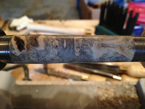

I put a drop or two of medium CA in the void and pressed in a bunch of shavings, well-smeared over the rest of the area. I let it sit for a couple hours, then removed the excess with a combination of my gouge and 180 grit Abranet. The result was a perfectly black knot that now feels just like the surrounding wood.
I did finish with CA, but every pen I learn more about this technique. I'm less than pleased with the gloss I got and may disassemble the pen to add a few more coats (I did 3 or 4) to build up some gloss. I'll try to post a picture later.

My fear with this edge was that it was jagged, and right near the nib. I worried that it might snag.
I didn't even think of drizzling CA as I worked. I'll try that on the next piece.
