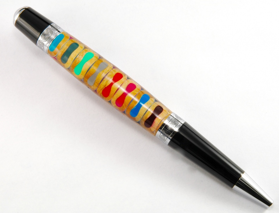

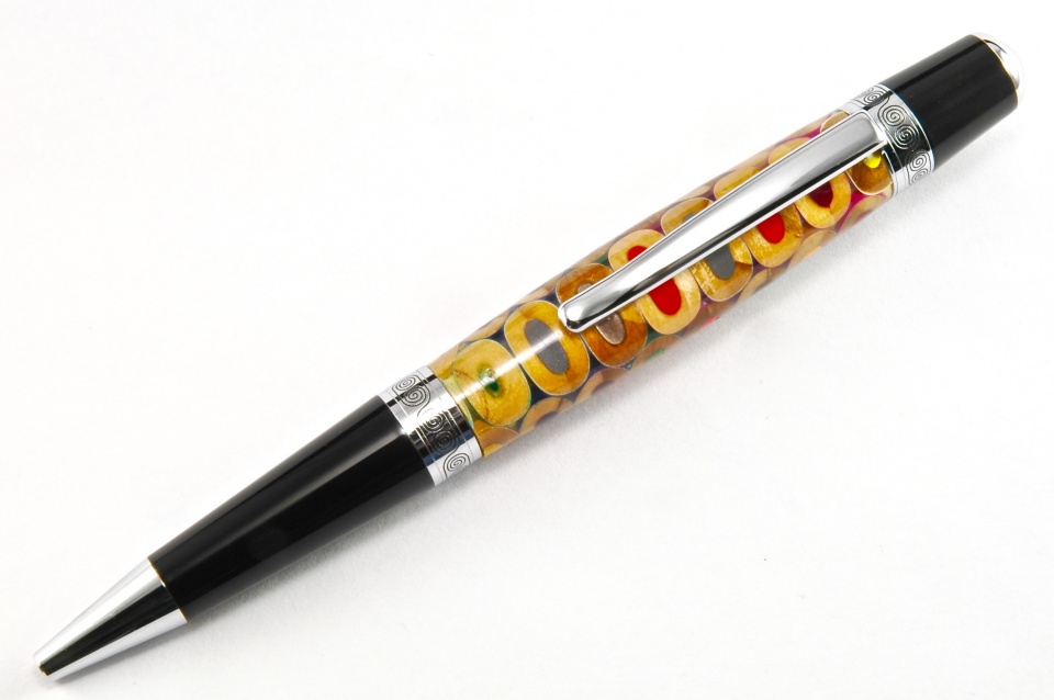

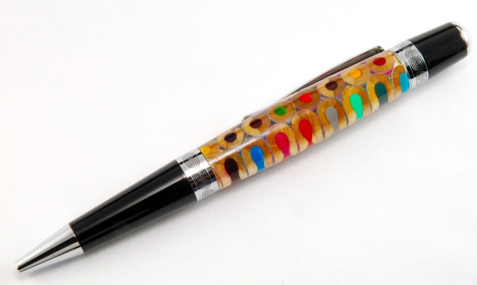

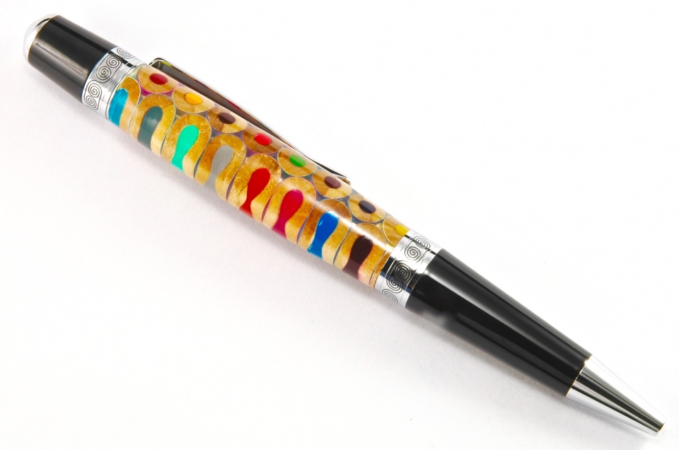

I was just goofing around with some ideas and this was one of them; I cast a box of colored pencils in Alumilite and created more work than it was worth! Mind you, the pencils were not stabilized. The further into the blank I went, the more the pencil leads wanted to separate via centrifugal force. I used a few layers of CA, cut some more, added more CA, cut some more, and so on. It took forever to turn!
Anyway, this is what I ended up with. If you try this, remember to back paint your blank or at least paint the tubes. It shows if you don't!
This one goes to my daughter who is a school teacher. Fitting, I thought!
C&C always welcomed, as usual
