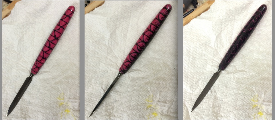

Started laying out the parts and noticed the default tube size that comes with the kit was pretty short. This friend is older and a more generous handle would probably be much more comfortable and a bit easier to use...fortunately, I also had a stash of replacement tubes in 10inch lengths!
I drilled the blank to the full depth of the flutes on my Colt parabolic 7mm bit (the bit is nearly six inches long and the flutes are a little short of 5" long). Oh yeah, this will make a proper sized handle!
I didn't like the metal plug for the top of the letter opener kit so I pulled out "The Grabber" mandrel I'd purchased a while back from Penn State. I'd used it only once before and really like the results it allows (but hadn't made anything that would work with it in a while). Ironically, that prior project also used a pink blank.
Three views of the result of all this are are shown in the enclosed photo. The handle material was one of Woodturningz's "Pink Zebra" blanks from their "Genesis' line. The letter opener kit is also from Woodturningz. Since I had to rush to get it handed off in time, I only paused long enough to grab a couple quick phone photos.
I'm hoping she'll be as pleased with this as she has been with the Pink Coral Tru Stone seam ripper...after the initial shock wears off as the Pink Zebra blank has a lot more figure going on! :smile:

Like the look from using the longer handle, seems it would make more sense anyway to be longer..... I know I don't like short stubby handles on anything.
Scott (sure she'll like...I do) B

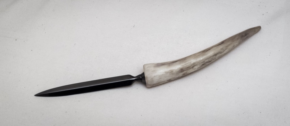

I hadn't noticed how short the kit's handle were prior to the pink & black version because the antler handle on the one I'd made previously required an even shorter tube. I just needed enough tube for the press-in blade connector to fit...
Here's a quick photo of that earlier letter opener:
