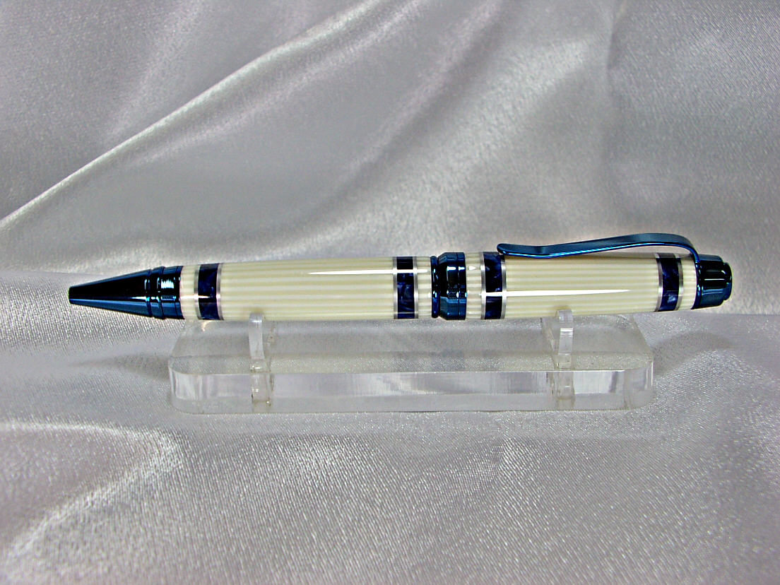

Have to say my return to pen making is taking on some oops. I have not tried segmenting since I shown this pen back last Nov. It is a basic segmenting design. Nothing fancy. Yes the materials are a little finicky so much care was needed. And to say the least working with acrylics and doing segmenting work is a whole different game than working with wood. Throw in some metals and the pucker factor goes up. So for the past 4 days I have been attempting to get back with the tools and breaking out some new designs. This has proved to be challenging to say the least. First mistake was a simple mind numbing oops. Should not happen if I was more in tuned. Next mistake was equipment failure and part mental. Never really tightened the tailstock enough. OK so today third attempt and as I said acrylic can be both rewarding and frustrating as we all know when we spin some of these acrylics. But this mistake took me to some learning experience on how deep I can route a blank while still keeping it solid enough to eventually get my segments glued in. What I usually do with wood can not be done with acrylic. So back to square one and after the blow up just left the shop and knew it was time to walk away and come here and vent. :)
If you do not keep up with your abilitys they do get pushed back of the mind and hope your recall is quick enough to capture them again. So we are in the recapturing stage I guess you can say. Man need to get back in the zone. Have not even attempted my casting designs yet. I can imagine what I forgot there too. I am still determined though so that is a good thing. Frustration is all part of this hobby and more so with segmenting. So many things have to break right to succeed. I will be back at it tomorrow. OK I feel better.

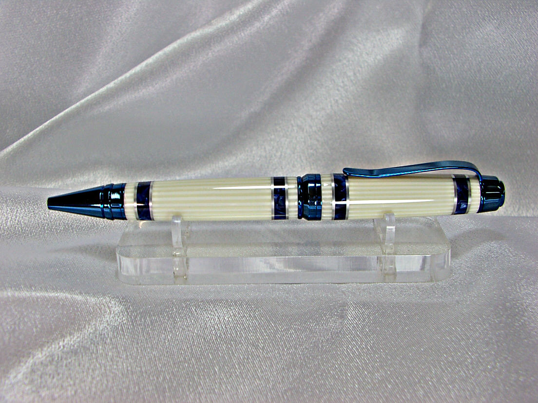

Moving those dark segments in from the ends makes for a very attractive piece. Better than just accents at the end of the barrel.
Thanks. When I did that one the hard part was working with such thin fragile material because I cut those on my tablesaw and that stuff likes to explode. So sharp blades was paramount. That is imitation casin material. The blue is a celoplast material and is beautiful to work with. I love that material.
Tony, no to CA. That is just polished to a high shine. Basically acrylic and aluminum.
