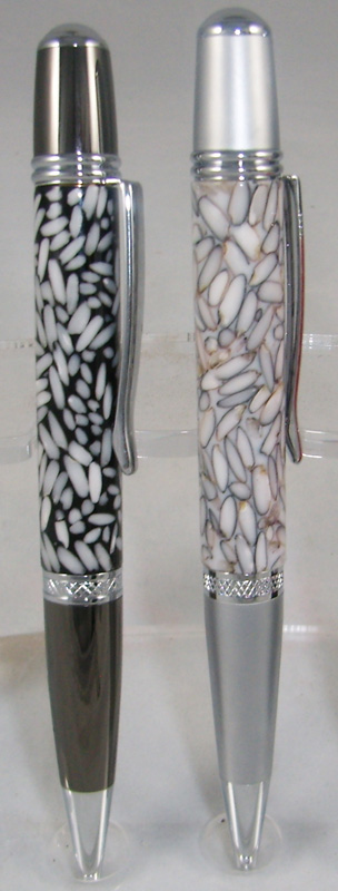

I've been trying casting rice in resin with some success using Jasmin rice. I wanted to try some black rice, so picked up some from my local chinese specialist store, along with some really white rice (not sure of what type, the pack just says rice). I cast the white rice in black resin, and the black rice (that is white in the midle) in white resin. I was very pleased when I turned them as the rice did not absorb any of the resin, giving very good grain definition, unlike the Jasmin rice I tried previously. The best part was that I just used my resin saver moulds, put the tubes in and filled it up with rice, then heated the resin up and poured it in slowly (allowing time to penetrate). No pressure or anything else, the rice didn't float. The pens are a gun metal Sierra, and a satin chrome Sierra.

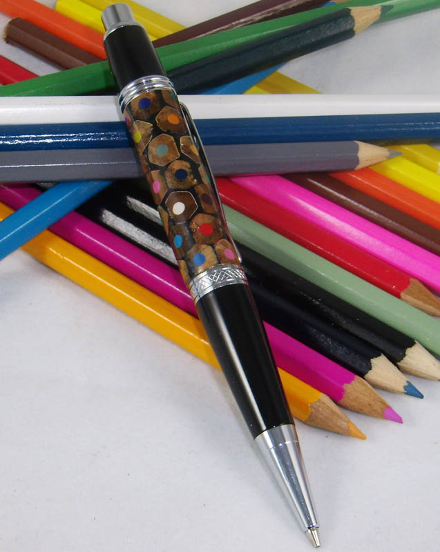

The next one is one I have been thinking of trying for ages, a pen made from coloured pencil slices. Gawdelpus (John) come around yesterday and he gave the idea for the jig to cut the slices, and then helped me as I went through the painful exercise of sticking the little pieces on the tube one by one. I then cast them in a suitable length of PVC tube with black resin. I had to use a lot of thin CA as I turned to ensure the pencil lead didn't spread into the timber of the pencil. The pen is a click pencil Sierra, as I lost a few of the pencils on the edge and needed a shorter tube :rolleyes:
The only thing I would change with the pencils next time is sanding the base of the little pieces to fit the tube dia, some portions of the pencils have been turned away because of the square ends on the round tubes :mad:. Curved ends will fix this, but involve far more effort. Otherwise I could just use a EB or another kit that uses more meat :wink:

Absolutely fantastic on the both rice and colour pencil pens. I tried casting white rice (long gain rice) in translucent green dye. The contrast of mine was not very good.
The contrast and definition on your blanks are brilliant!!
And the colour-pencil blank is stunning!!!!

Very cool. The pencils create a very unique and appealing design. Also, I like the great definition you got with the rice. The black rice, in particular, really stands out.

Loved the colored pencil blank. Could you slice the pencils thinermso you would have still have a good layer of resin/pr whatever medium still covering them once turned to size?

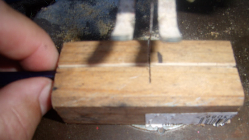

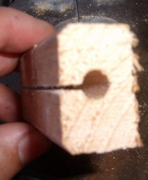

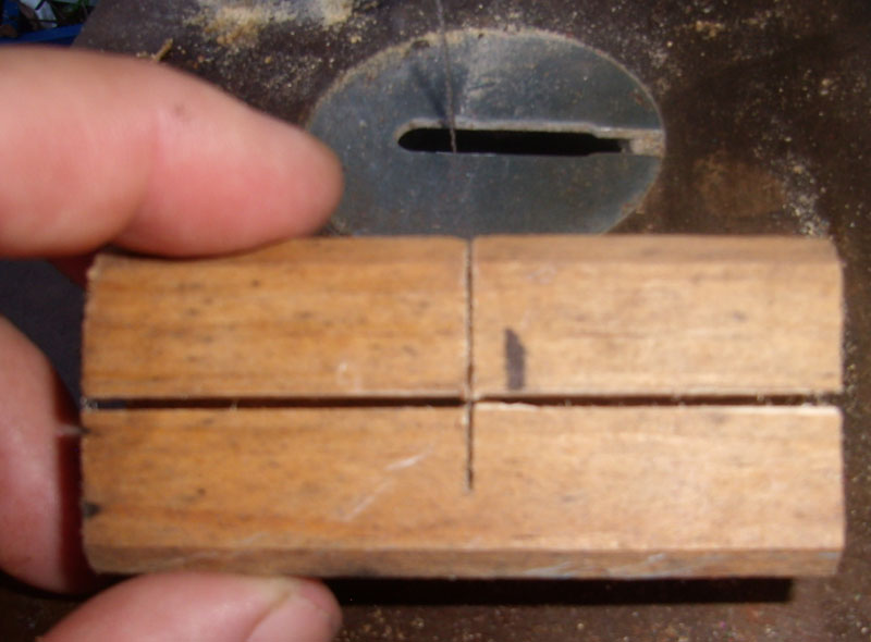

excellent work. I hope you share with us the jig you used to cut the pencils.
Basically a piece of wood with a drill hole down the center slightly larger than the pencil, and a saw cut with the scroll saw at right angles as the cut line. I also put in a cut line parrallel with the drill hole from the top down to the drill hole as a window to see where the pencil is.

Nice! The pencils look great. How did you get the edge definition on
the rice?
I too had trouble with edge definition with other rice types I have used. I came across this one by accident. They almost appear like bleached rice, although I'm sure they are not. I got them from my local chinese specialty shop, "Pigeon Brand, Extra Super Quality Pin Kiew Glutinous Rice, Product of Thailand".
Perhaps you can get some over your way. They also had some what looked like little tiny cubes, the size of the width of a grain of rice, hard and also bright white. Not sure what the where as the label was only in Asian, but they were amongst the lentils, should also be good.
I also add a lot of catylist to the PR to ensure it goes off quickly
I wish I could, then I could use the resin saver moulds. But these were cut to just over 1/8", any smaller and they started to split.

Here's the jig, sorry about the photos, but hopefully it will help explain.
Photo 1 shows the drill hole for the pencil and the cut viewing slot for top
attachment.php
Photo 2 shows the viewing slot running along the jig and cross-cut slit for blade from above. Black mark is the cutting length
attachment.php
Photo 3 shows doing a cut, normally I hold jig with other hand, instead of camera :wink:
attachment.php
