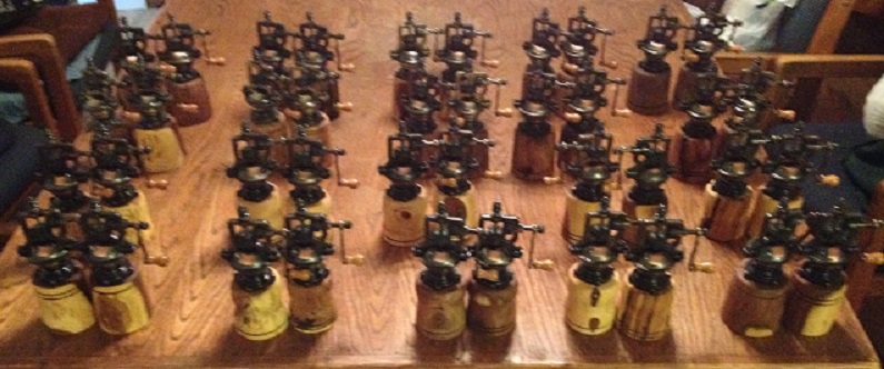

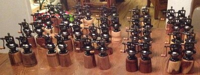

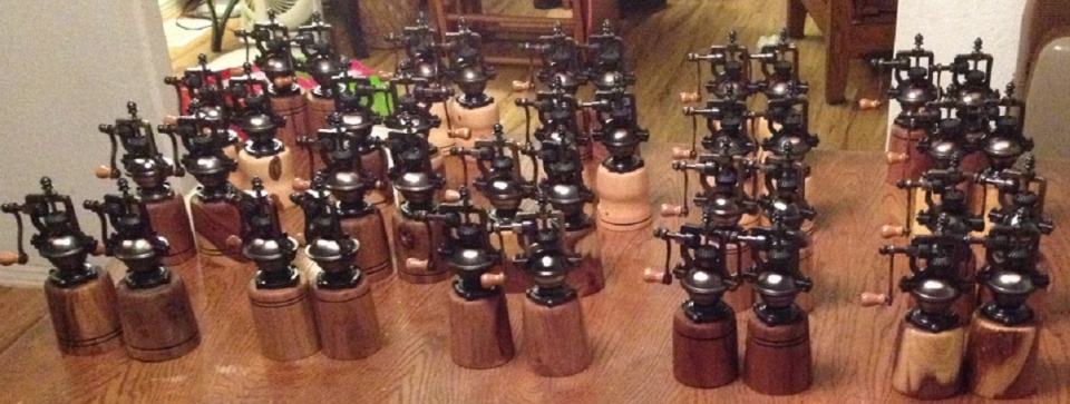

Had a Doctor order 20 sets of the pepper and salt grinders. Delivered them to day woods include mesquite, mulberry, juniper and ash. These are great sellers for me, they work well with the retired because they are reminiscent of the old coffee grinders.

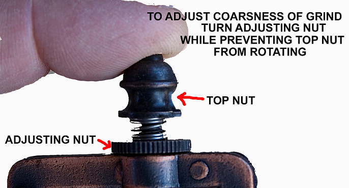

Word of caution if you make these is to remove and put a drop of lock tight on the threads of the top acorn nut. This helps prevent the nut from coming off when the grind adjustment knob is turned. I also printed up some instructions.

Them look really nice I would like to try something like that someday. On a side note my wifes doctor ordered 3 lever action pens and 3 bolt action pens all in pink camo guess how many kids he has and what they are one nice thing they all hunt.
Pretty impressive group! I like the variety of wood. A nice order for you (which is always nice).
