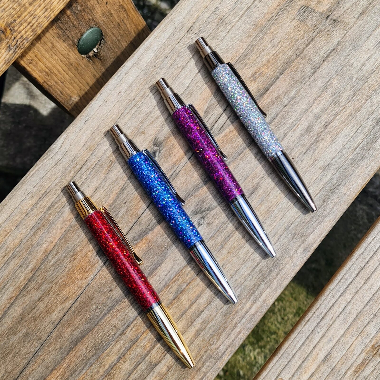

A few more of my first casting attempts
See more from DJBPenmaker
DJBPenmaker
Nov 10, 2016
539
Cheshire, UK
I think I've got the hang of casting my own glitter blanks now. I'm so very pleased with the effect and have already 'lost' four I've made.

Great looking pens! are you using a specific glitter?
as to the kits - i think they would look better if the mech was plated the same as the rest of the kit.

Do you use a pressure pot. Also it does look a bit messy is it.
Hi, no I haven't got a pressure pot, I just mix and pour very very carefully and keep it at 40c whilst setting. First I paint the tube an appropriate colour, then coat it in mod Podge and sprinkle the glitter over whilst wet. I never touch the glitter. Any glitter from sprinkling falls on a sheet of paper and I funnel it back into the container. When dry I gently blow off any loose glitter from the tube and then cast. The glitter is holographic glitter. The effect in light is stunning. Photography doesn't really show the effect. If I knew how to upload a short video I could show the effect when the pen is moved in the sun/light.
