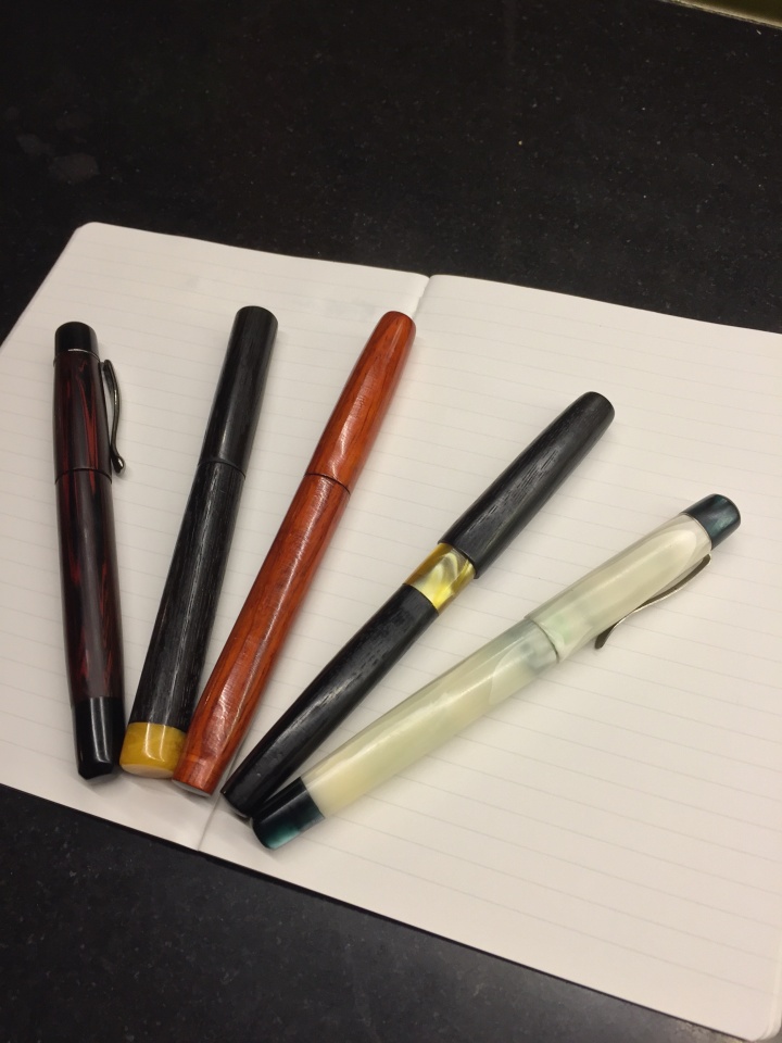

Hi,
I'm new to pen turning. Did a few kits and then dove into kitless. It's working out ok - I have 5 workable pens so far, hope the pic comes through (yeah, I made a white ink pen. Not a great idea) I had a few questions for the folks who've been doing this a while:
- I worry about the strength of the wood pens I've made. Does anyone insert brass tubes into these as kitless pens for strength, or is it unevcesary. I think the wood walls are about 2mm.
- does anyone have a good solution for sealing a wood cap so the nib doesn't dry out?
- I'm using m12x1.0 and m10x1.0 for the cap and barrel threads. On the wood pens I use ebonite for the threads and it's fine. On acrylic pens, the acrylic seems really fragile and I get some threads cracking off in use. Does anyone have a favorite set of thread dimensions for this kind of pen?
- one of the pens is ebonite. Really cool (if stinky). But I can't get a high gloss finish on it. Does anyone have a good finish for this material? I guess I could just do standard CA finish?

If I stack up your tread dimensions correctly, there isn't much wall left between the cap thread and the section thread, assuming they sit atop each other. The thickness left over would be between 0.23mm and 0.5mm, 0.009" and 0.020". Probably not enough wall thickness for anything but metal. If you offset the threads for the cap and section where they don't sit on top of each other, you might be ok. I use 0.75mm pitch threads to give me an additional wall thickness when stacking the threads. I have use 9mm x 0.75 and 11mm x 0.75 threads for acrylic pens without issue stacked. With 1.0 pitched threads you will likely need to step up the cap to 13mm for acrylics.
The following site was very helpful for me in designing my kitless and picking threads.
UN imperial screw thread calculator
You will have to convert metric to inches for the diameter. Then change the output to metric. Input threads in tpi till you get a metric pitch match. The thread class selection, I use 2A for the male thread and 2B for the female thread. It will calculate the minor and major diameters and the their acceptable ranges. I also use it to calculate the tendon diameter and hole size required prior to threading.

How are you polishing the Ebonite?
I've always just progressively wet sanded to around 2000 then polished with a buffing wheel using some white polish compound and gotten a mirror finish.
Micromesh and similar pads should work well too, but I haven't tried them on Ebonite since the way I do it is easiest and fastest for me with my technique.

Thanks for the replies. I guess I'll have to invest in a 9mm tap for the nib section - I've been using premade ones that have 10mm but as you say, it's really not much material.
I polished using micromesh up to 12000. I'll try buffing, haven't done that - didn't know how the material would react to it.

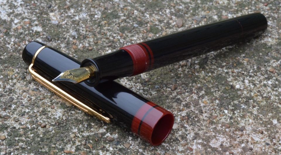

I've found that I needed to buff ebonite in order to get a mirror shine. This is Japanese ebonite, and was buffed with tripoli and white diamond compounds on cloth wheels.

Yeah, that's what I was looking for. OK, maybe I'll get out the buffing wheel tonight.
I stand corrected, what an amazing finish! Have you found a difference between the ebonite sources in finishing and quality? How would you rank them in comparison?
