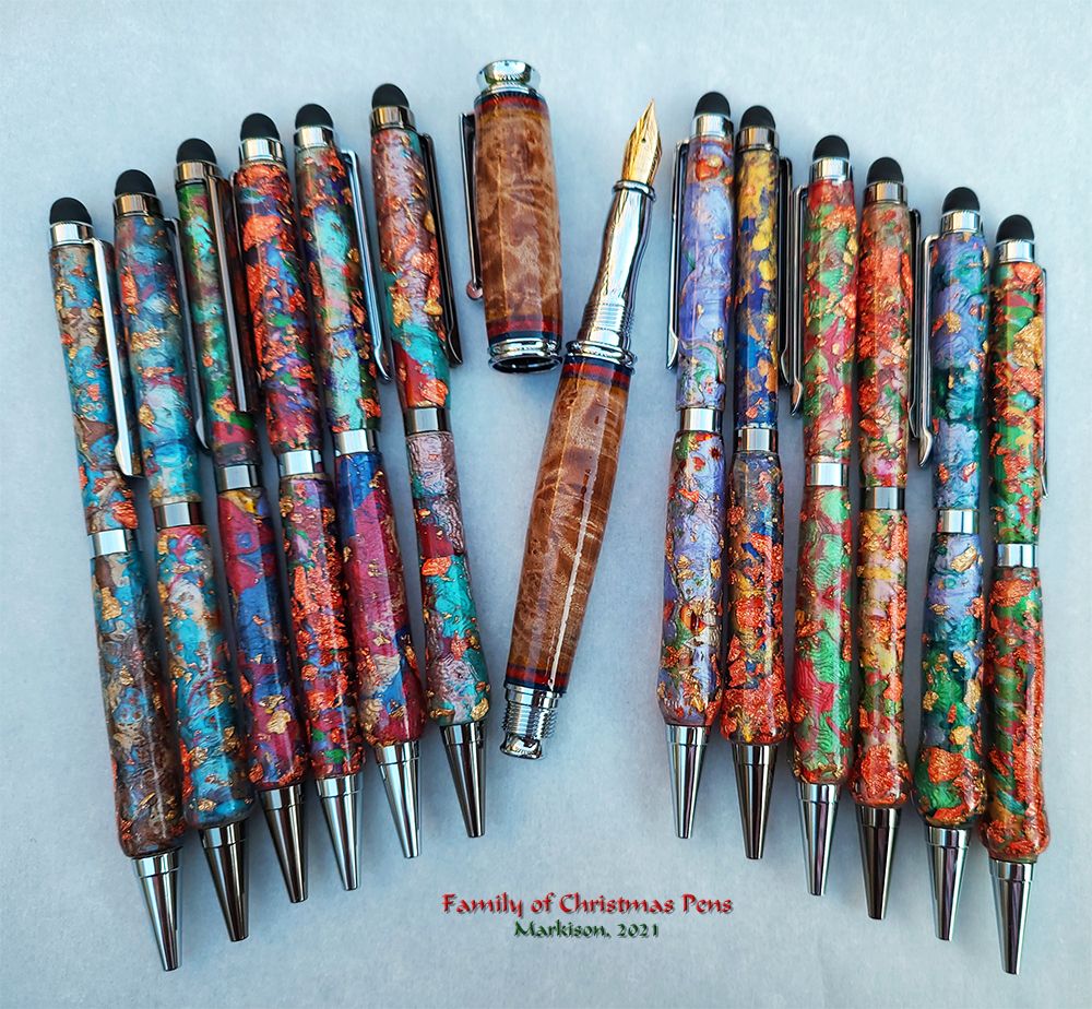

A wonderful family asked for a family of pens for Christmas (couldn't argue with that!).
Grandpa wanted a fountain pen.

Extremely nice work, Bob ! !
Thanks for showing ! !
I am always amazed at your colorful finishing.
Are those wooden pens ?

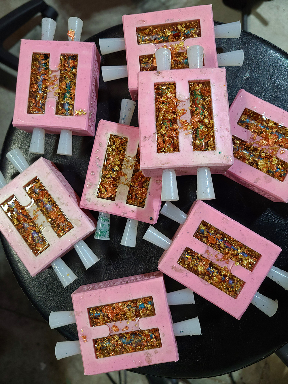

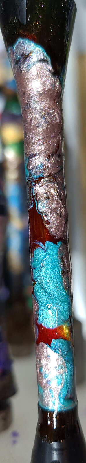

The stylus pens were done with a few layers of home made paint, then cast with Douglas and Sturgess Clear Casting resin (mixed with metal flakes).
The fountain pen is stabilized maple burl - then I applied a layer of UV cured epoxy resin, inked the barrel ends with alcohol inks, then applied a second layer of uvcured epoxy resin.

Thanks very much for the above fabrication details, including the very interesting additional pictures.
